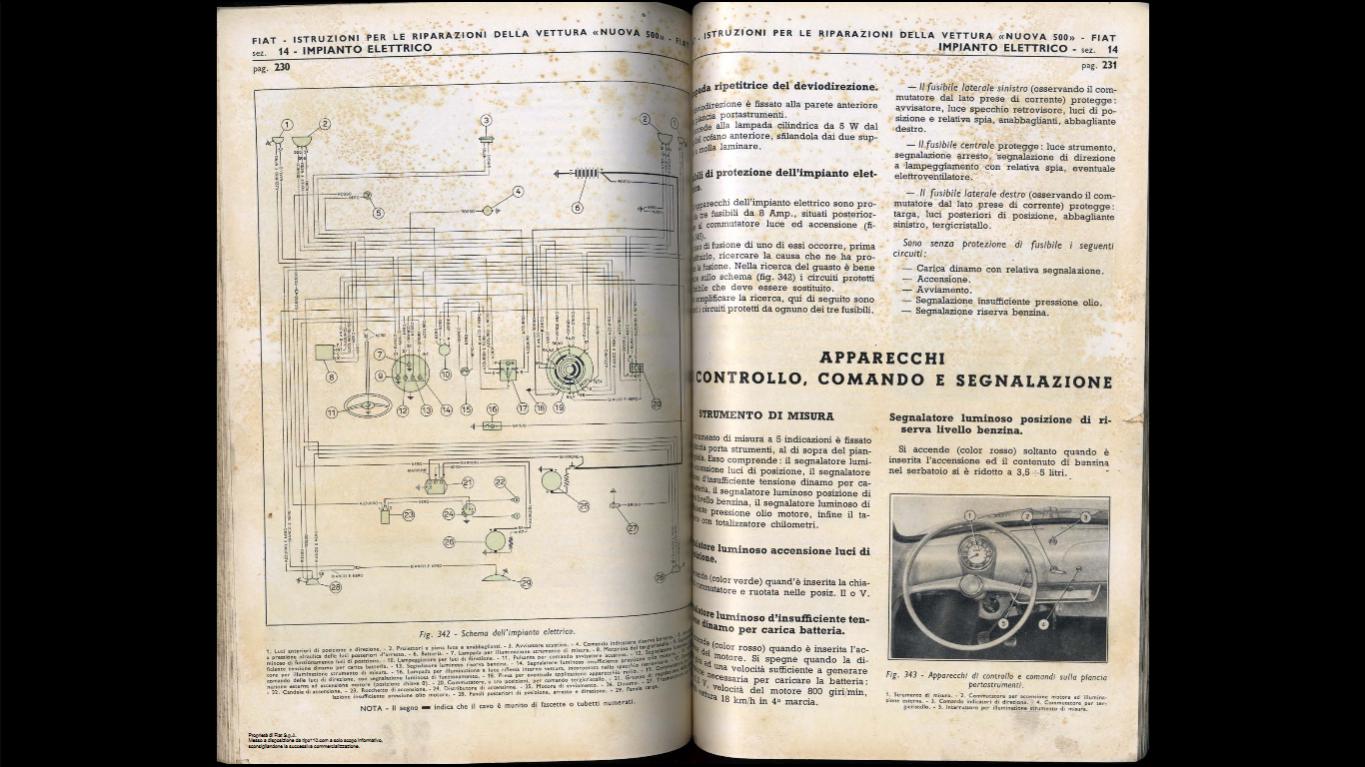

Go here http://www.tipo110.com/Images/ManRip_500N.pdf and download the whole Bible for the N, albeit in Italian. It's page 117 0f the PDF but heres ascreenshot which will probably be too low resolution to be useful.
The whole manual has amazing detail and I will be downloading it because there is plenty which will be transferrable to later models. I especially like the chassis dimension pages.

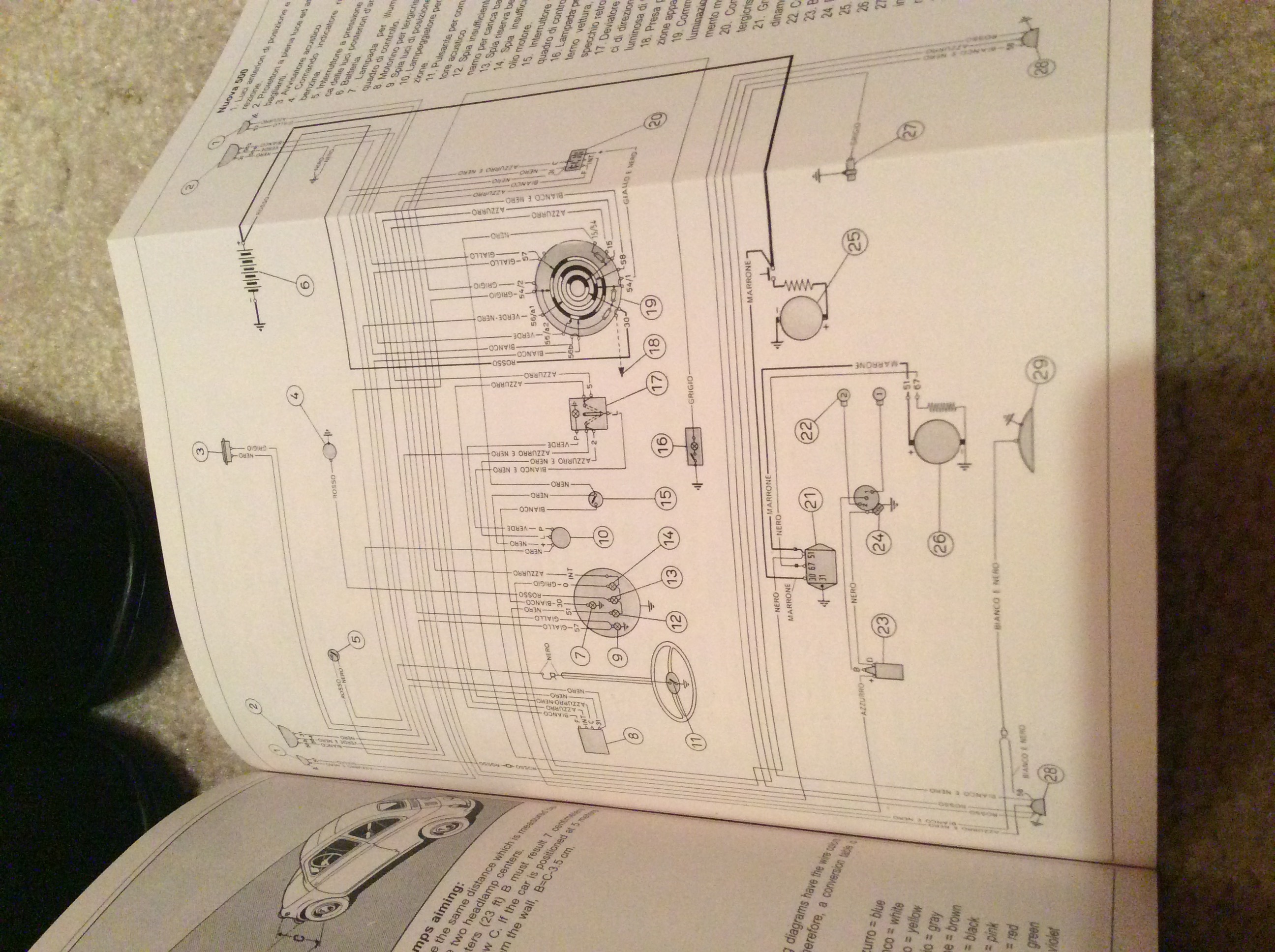

I've just had a dig through the various books I've got and I think this is for an N:
This is the only diagram I can find that doesn't show both front side lights and wing repeaters so I think it should help you.
I can copy and post it to you if it will help you
