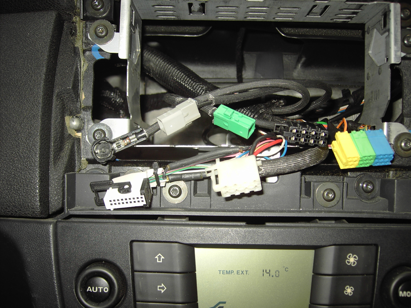

Does anyone know where the green and grey connectors are for at the back of the Connect nav+ unit ?
The two at the bottom of the photo I mean.
Thanx
They are for the phone (GSM) and satellite navigation (GPS) aerials. They should be in the enclosure behind the CN+, as in the first picture below.

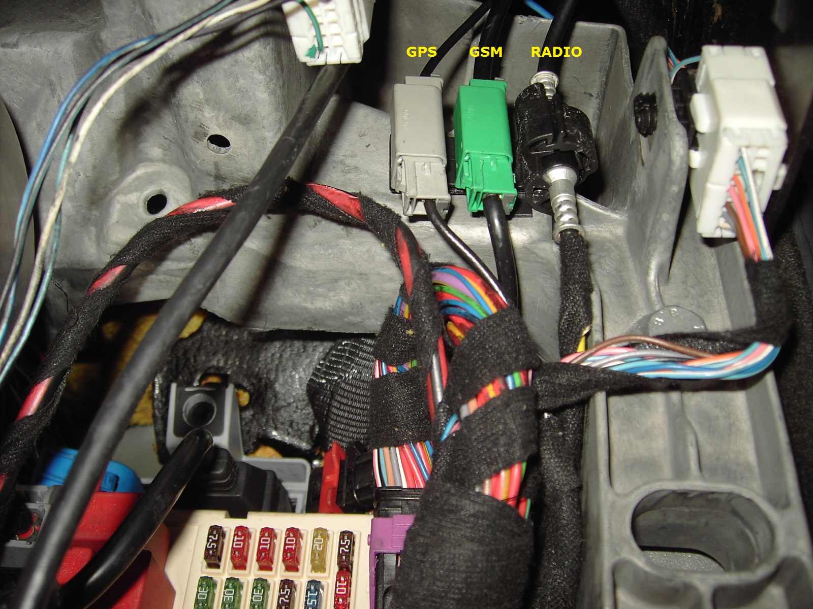

There are also intermediate connectors for all 3 aerial leads above the dashboard fuse box, as in the second picture.

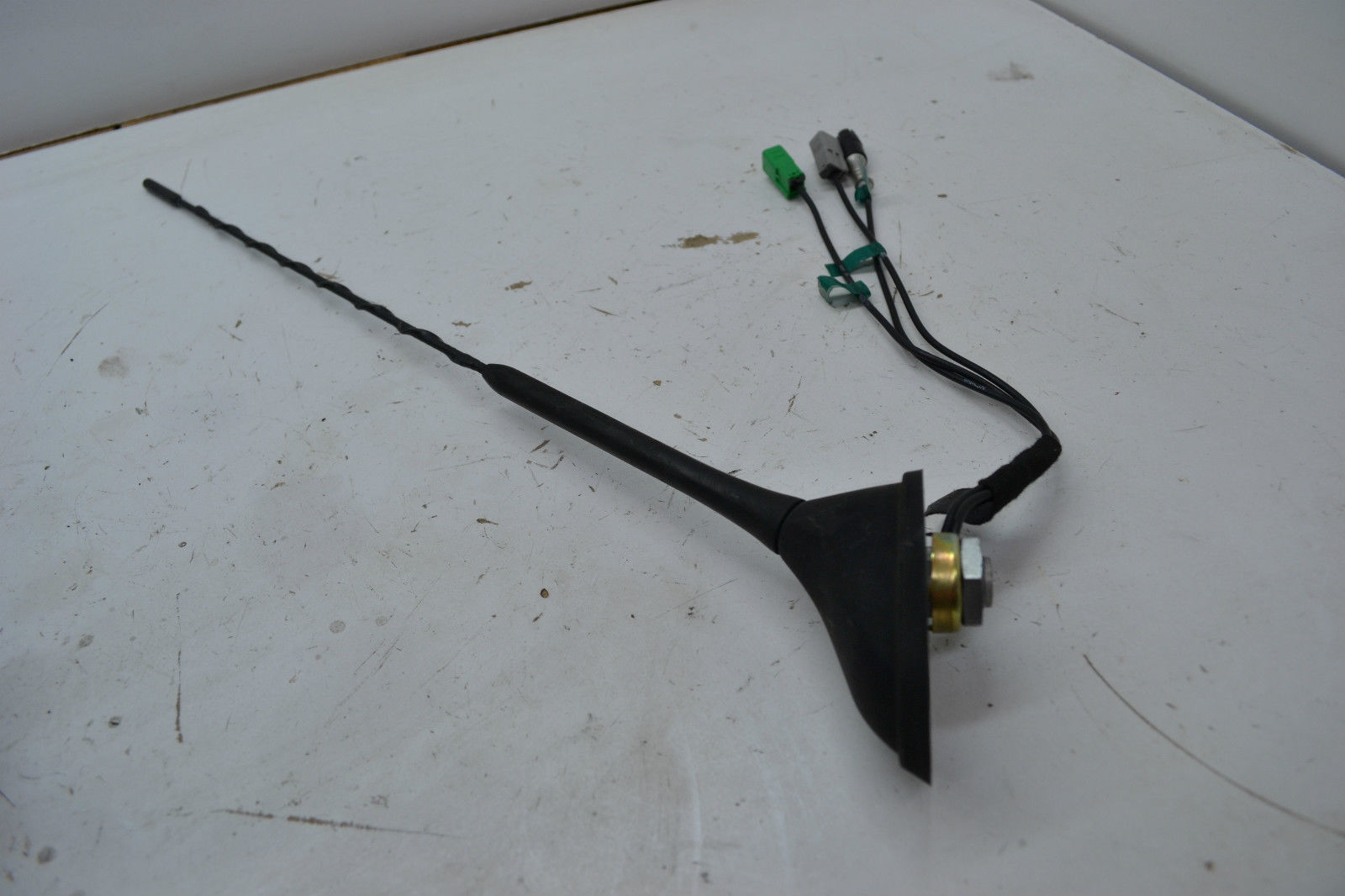

Although there are 3 leads, they all go to the same aerial, as can be seen in the third picture.
If the car wasn't originally fitted with a CN+, then the GSM and GPS leads and the 3 way aerial will also not be fitted.
