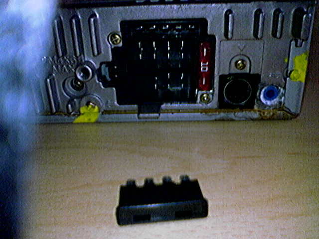

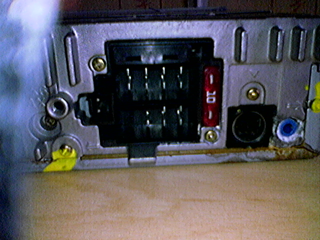

Right can anyone tell me, if i need this black thing or is it part of the stereo.
As you can see in the left photo its plugged in but in the other i've taken it out but i dont know if its part of the stereo or not.
I'm not sure. Is it a standard radio or something else? I've never seen anything like that before.
well its a sony one but the standard plugs from the seicento fit straight into it. Now'i've got get my alpine installed but if its not got a standard iso connnection its gonna be hard..
Is it mentioned in the sony manual? If it isn't I wouldn't worry about it.
As for the alpine, a harness *should* be included to connect to an ISO connector, if it isn't ISO already. If not, then its a trip to halfords or something and looking there.
are the cinquecento iso leads the same as the seicento ones. Theres a lead for £4.50 on ebay but its for a Fait to iso for a cinq not a seicento(i'm assuming there the same)
I would have thought so, but don't quote me on it! I would have thought someone like Ghost would know. My wiring was hacked about and I had extra wires, so I don't think I'm gonna be much help.
