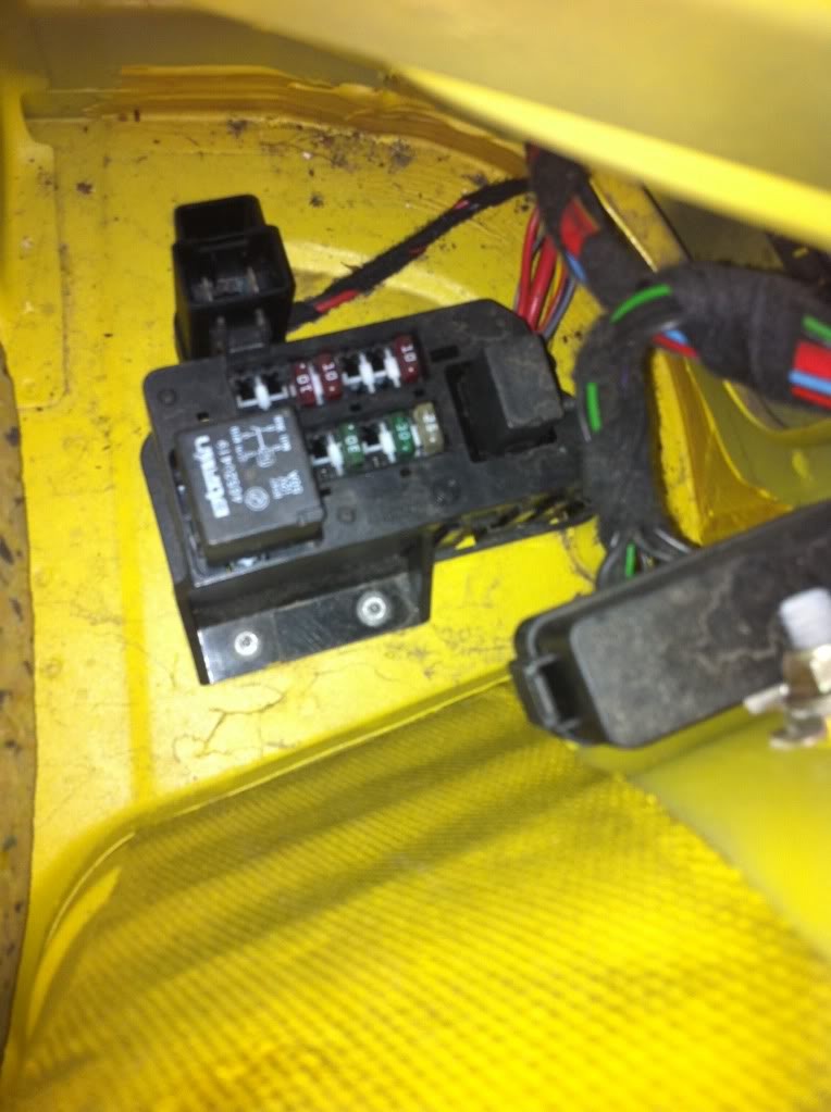

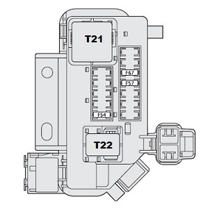

Sorry if it's in the wrong section, ok so first time I'm going to attempt this can anyone give me guidance on installing a sub into my stilo please also what fuse would I need as I have the fuse wire but there is no fuse in it, want the sub in the boot and am planning on fitting the amp in the little compartment in the boot on the left thanks in advance ?
There's already a power supply for the amplifier on fuse F54 in the rear fuse box located behind the left boot liner panel.
You will also need to reroute the existing 8 wires that go from the radio to the speakers, so that they go from the radio to the amplifier inputs. Then you will need to wire from the amplifier outputs to the speakers.

I don't have that under the pocket and just wired it in and speakers don't work any ideas as I'm not the best with wiring but want to learn
