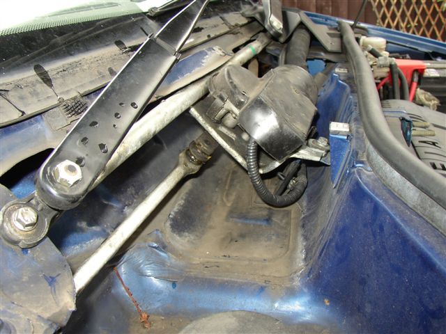

Hello all,
The front wiper system packed up today due to a failure of the linkage system due to lack of lubrication. Mine has just passed it's 2 year point by a day or two. Might be worth checking out and lubricating the links before it fails on rainy windy day.
Any one else had similar??? I'm off to Fiat in the morning, keep you all posted
Cheers John.
Buggeration out of warranty by 1K!!! Tight sods.
Does any body know if the wiper mech is shared with any thing else in the Fiat range????
Cheers John.
