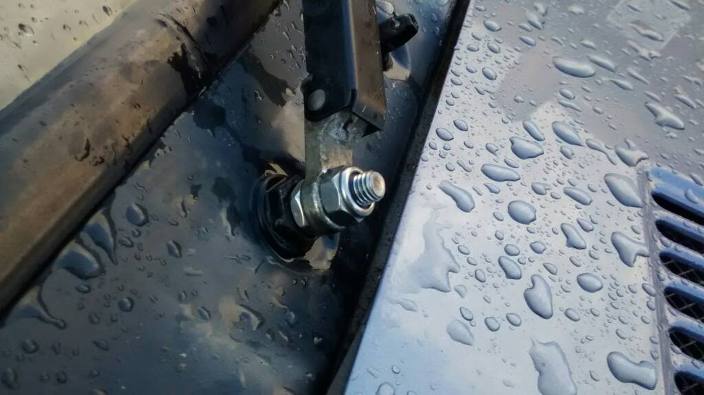

this is what the end result will look like when bolted to the car:
(keep in mind that the one you will be getting will be fully stainless steel with a nylon locking nut)

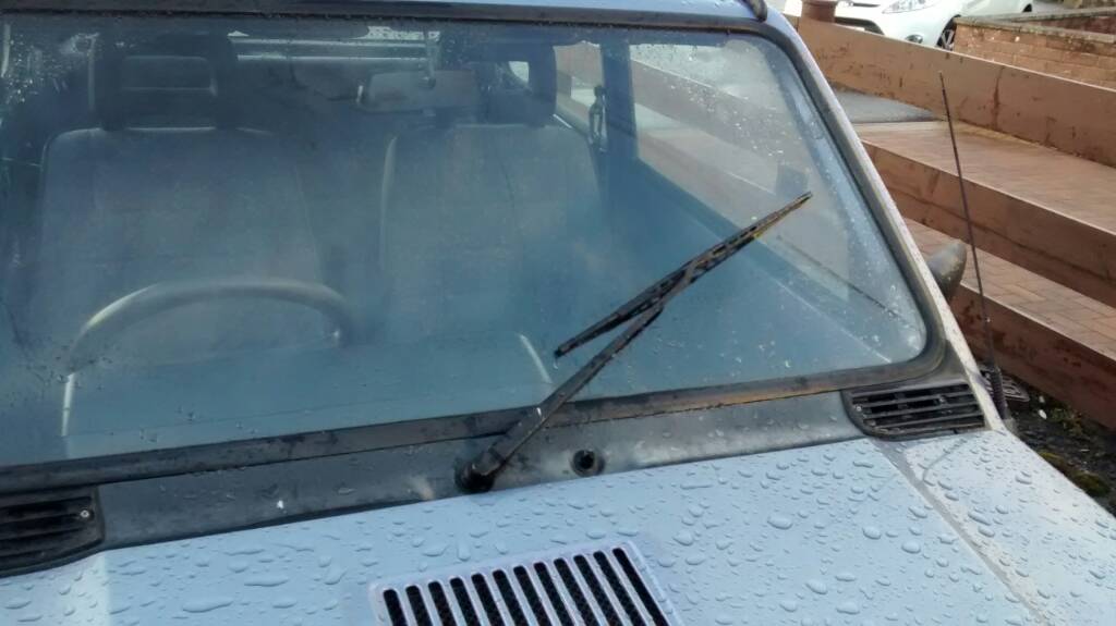

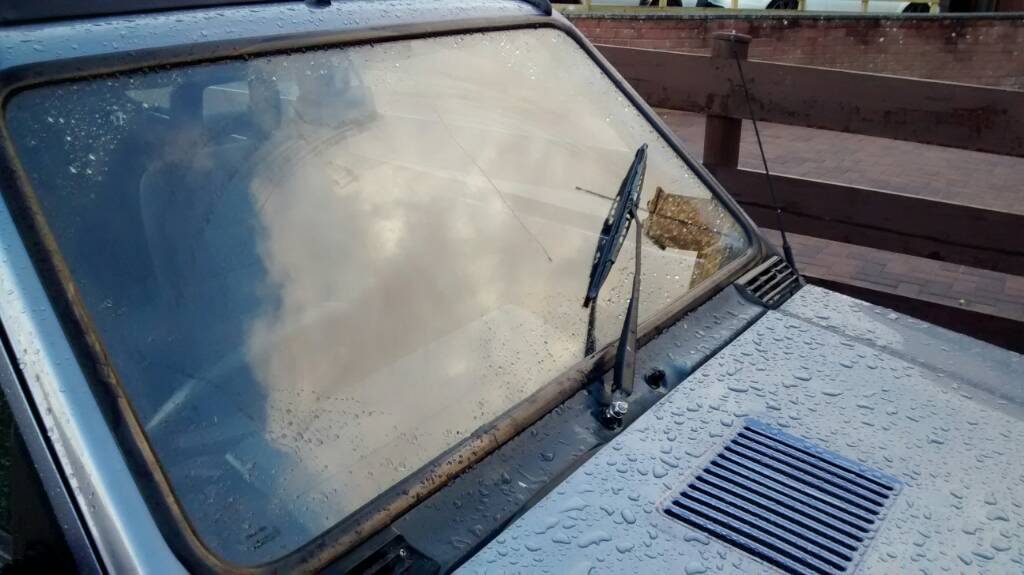

For anyone interested in John's service here are the results on mine (converted by john and fitted by myself)
Very very happy, an essential upgrade for safety in my opinion.

Just thought I would put the video of the conversion working on here to show you all, I am using the standard panda blade with the correct adapter :) a slightly shorter blade would be neater as Dragonman suggested :)
Classic Fiat Panda Parade Progress Log No 9 - wiper bolt conversion done: [ame]http://youtu.be/nWX5WuBx19o[/ame]
if you undo the nylock and let the arm sit lower when parked it wont hit the window rubber. only needs to be moved a little bit on yours (y)
I moved it a couple of times but couldn't quite get it to sit 100% correct, though this has more to do with tiredness on my part, as it goes the actual blade part isn't touching the window rubber part at all, and the plastic overhang floats above the window rubber so I'm leaving it at that for just now :)
I would like to take this opportunity though to vouch and thank you for the impressive quality, obvious strength, and vastly improved safety of this modification, and as I said before I will be sending the Sisley motor to you further down the line for the same modification :)
