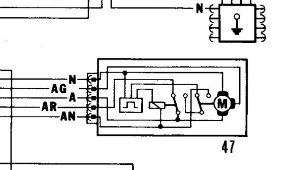

thanks for the message, the following:
1. Where is off for wiper stalk
2. Bought a new wiper module, don't know what happened but brushes worn out and circuit board blew the circuitry
3. If I do a direct connect and not the stalk, where do I connect 12v and earth, the motor has 4 connections
