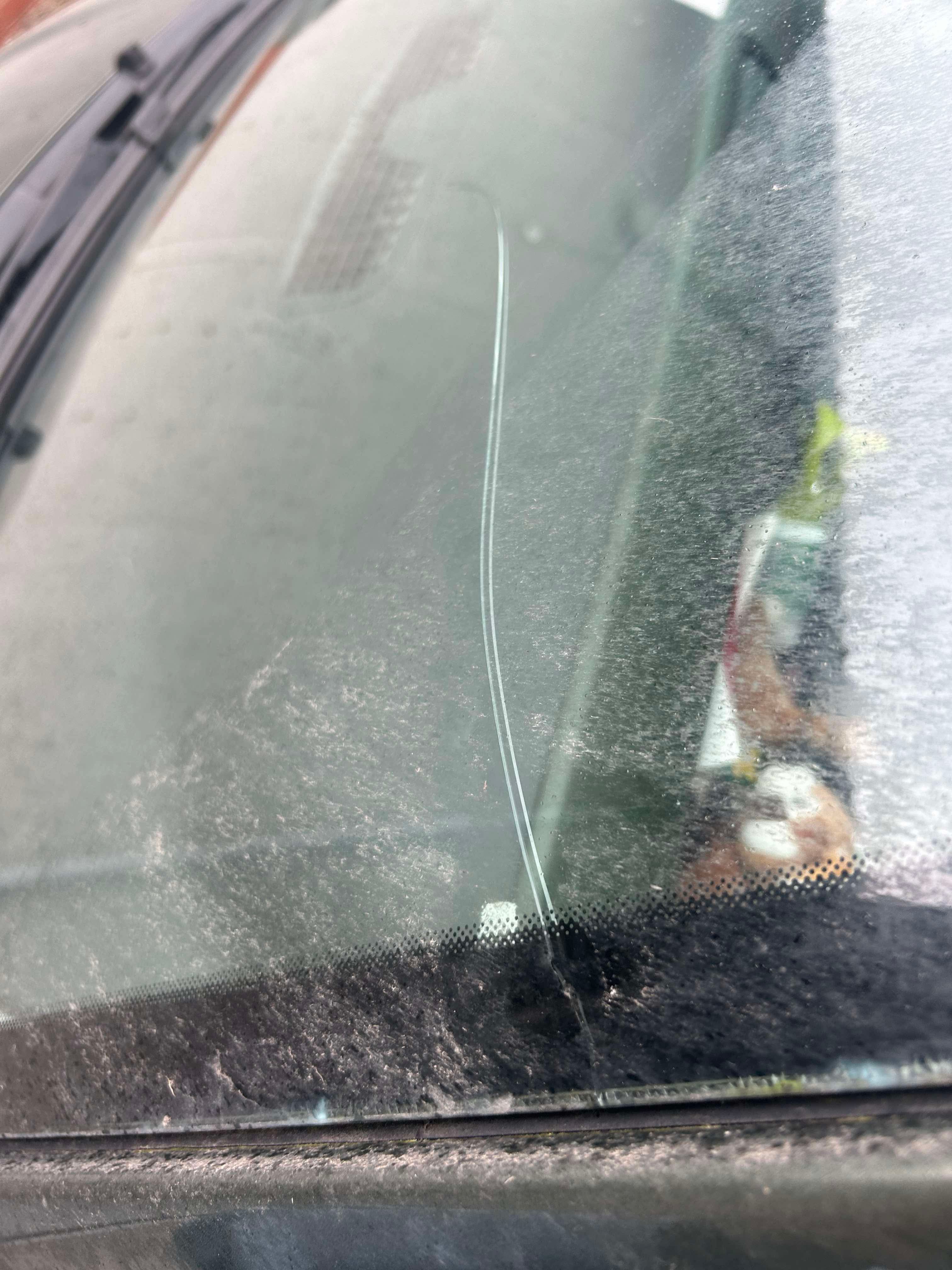

Griffith Theory of Brittle Fracture ?​
Does not have to be an inherent flaw, ( Dr Gordon, metallurgy lecture at MIDDX POLY a LONG while ago so don’t have the notes) as such, but yes seen the chip in the mask area. The theory predicts that over a certain length the energy required to increase in length is low, hence spontaneous failure. However crack growth rate now very slow, if growing. Stress free state, unlike me. Anyhow £350 at National Windscreens will remove my “experimental “ rig 🤓
We are on the same page even if we have both lost the notes! I think that was my point, the flaw induced by the (probable) stone was in excess of any inherent flaw and therefore required less energy to initiate crack growth. A thermal shock (pouring hot water on to melt ice for example) will probably generate some more "action". Despite destroying the screen on my treasured Volvo 940 my wife still persists in doing this on the Panda...

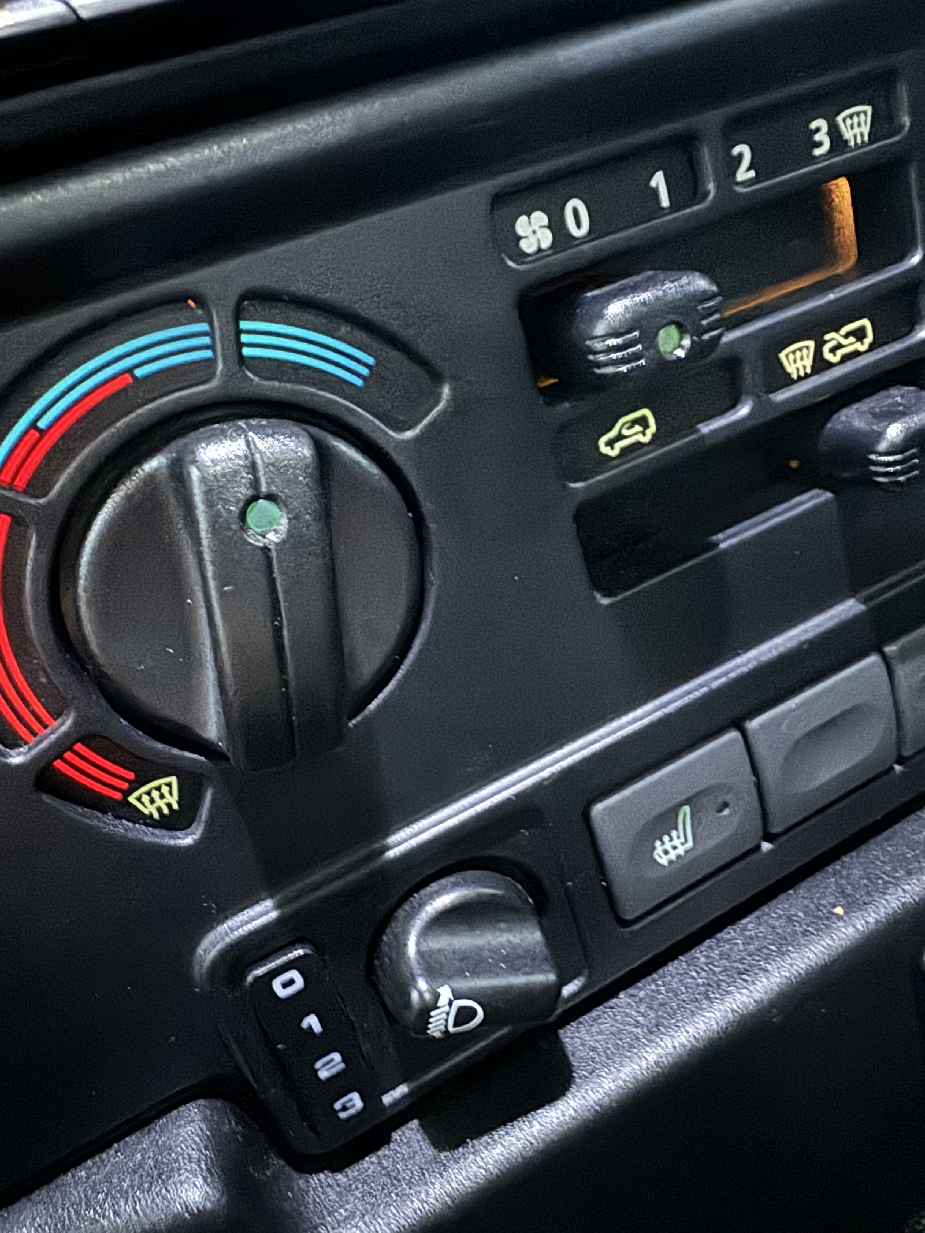

Landy is laminated, tinted and heated. But smaller, and yes, flat.
I think Admiral charges a flat rate of excess on car policies, but maybe a lower flat rate on commercial? (HardTop 90 is class N1 on the registration docs).

2013 - had gone posh by then: heated seats too :)
