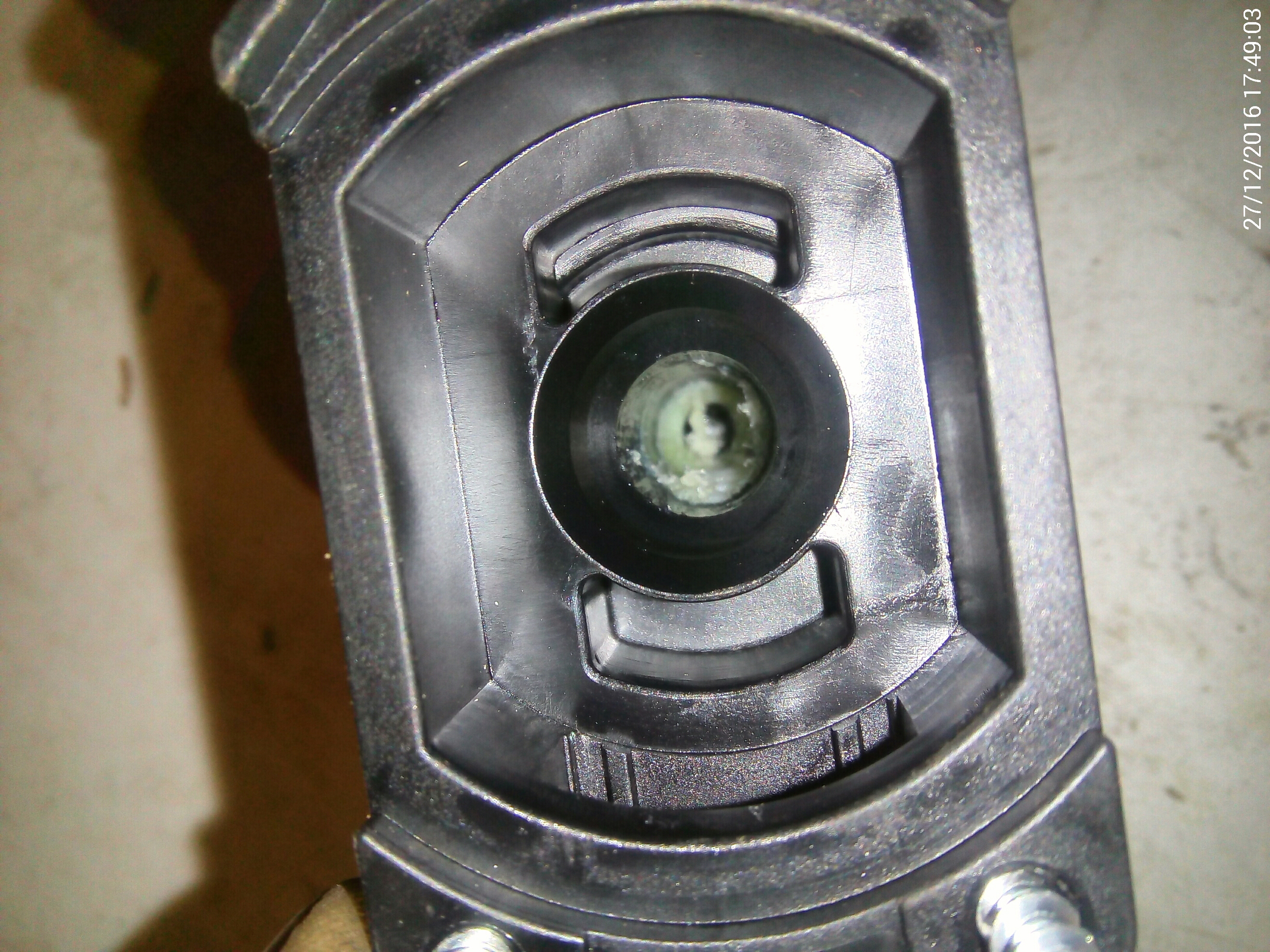

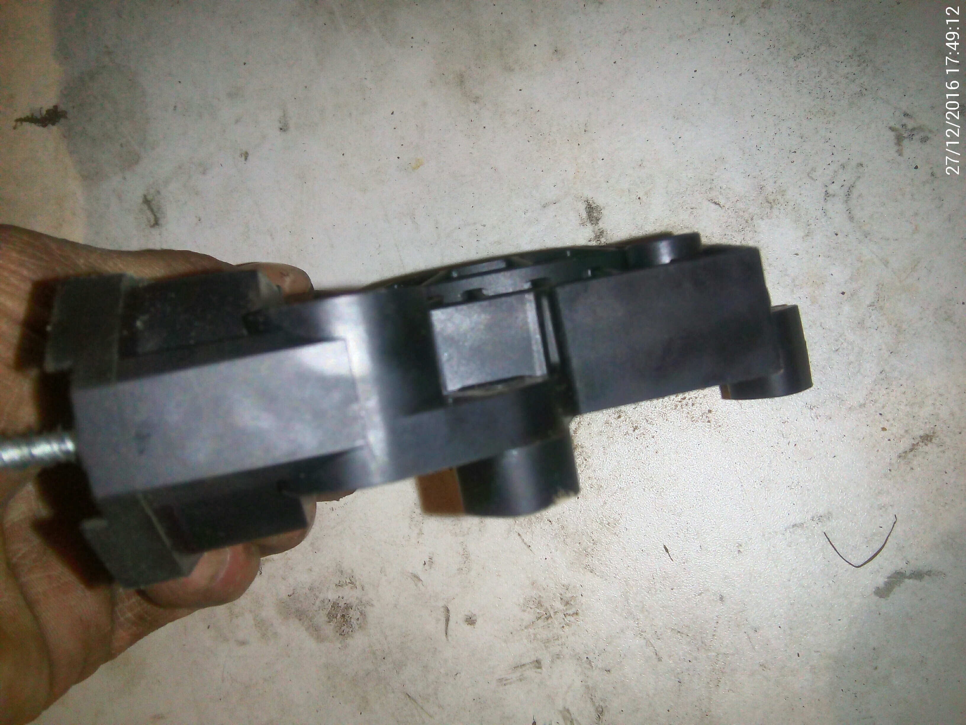

any ideas on opening this without smashing it?

Hi,
Nothing obvious. It is possibly ultrasonically welded together. If so the only way to open it is cutting or controlled breakage. The circular bit you pried is a likely join. I'd start with a small file and file a narrow section at 45 degrees to the corner. Check every few strokes to see what is revealed. This can give an idea of the joint construction.
