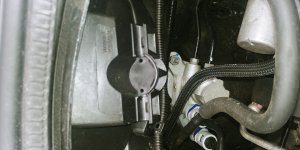

Nope bracket is sport welded to the car took an interior Pannel off to see inside this morning

And how do you adjust It when it bolts into the backing plate through the door pillar using countersunk torx bolts and allways center in the holes in the striker plate there do adjustment in ant area I can see
Unlike in other cars ice seen where the rear nuts/backing plate moves a small ammount
Well I’ve never seen this before. It looks like Fiat have changed the adjustment to nil on the striker plate. So I would assume the adjustment would have to be on the lock mechanism on the door?

There's certainly no visible adjustment anywhere have checked other strickers on the other doors and these are exactly the same as drivers side
