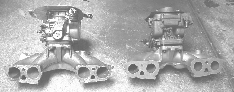

36 or 40DCNF will work very well as a single carb, but the issue is mounting it correctly.
The DCNF bolt pattern is different to the DMTR/DATR blt pattern that your X19 has as standard.
You can modify the existing manifold to accept the wider spacing, but this will actually orient the carburettor incorrectly for best use.... in that the float bowl (mostly the float pin) axis will be along the cars length, not across it as the designer intended.... causes lean out issues on hard turns one way, but not usually the other

To do the job properly means major mods to your manifold, or the purchase of a suitable X19 single DCNF manifold.

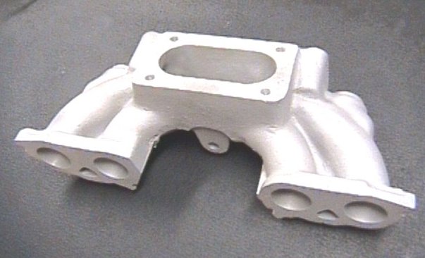

The first picture is a modified manifold and a standard one to compare, the second picture is what you really need to do the job properly, or modify your existing manifold to orient the DCNF like this.

Sprint and Alquati (both Italian companies now no longer in business) used to make these single manifolds for both 128 and X19, good luck finding one for an X19, they are few and far between, but come up occasionally on ebay. (128's are much more plentiful, but can be machined at extra expense)

well i think i saw a "weber" intake manifold on e-bay for an x1/9, like the one in the pic you gave me
