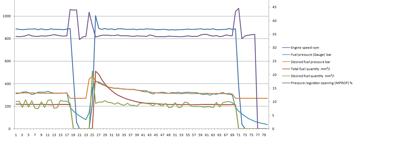

if those figures were at idle something is not right , I will dig out a cold start I logged in past, with engine warmish, lstart og then ign off and after a few seconds start up again to catch the start.
heres one ,eng on and off and start
heres the excel bit(couldn't get to upload excel file? so just screen shot)

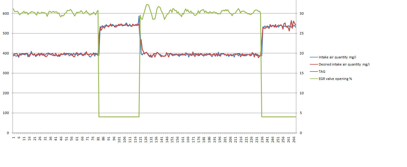

ive seen people on net remove and clean egr but still end up with a problem, best if you can to physically blank to test.
if not heres some maf data with the egr in normal on / off / on / off cycle whilst idling

in the log data screen shot the values in the 30's in the middle is fuel pressure regulator
anything else you suspect and want an idea of normal value range let me know ill see if ive got it or I can log again to compare

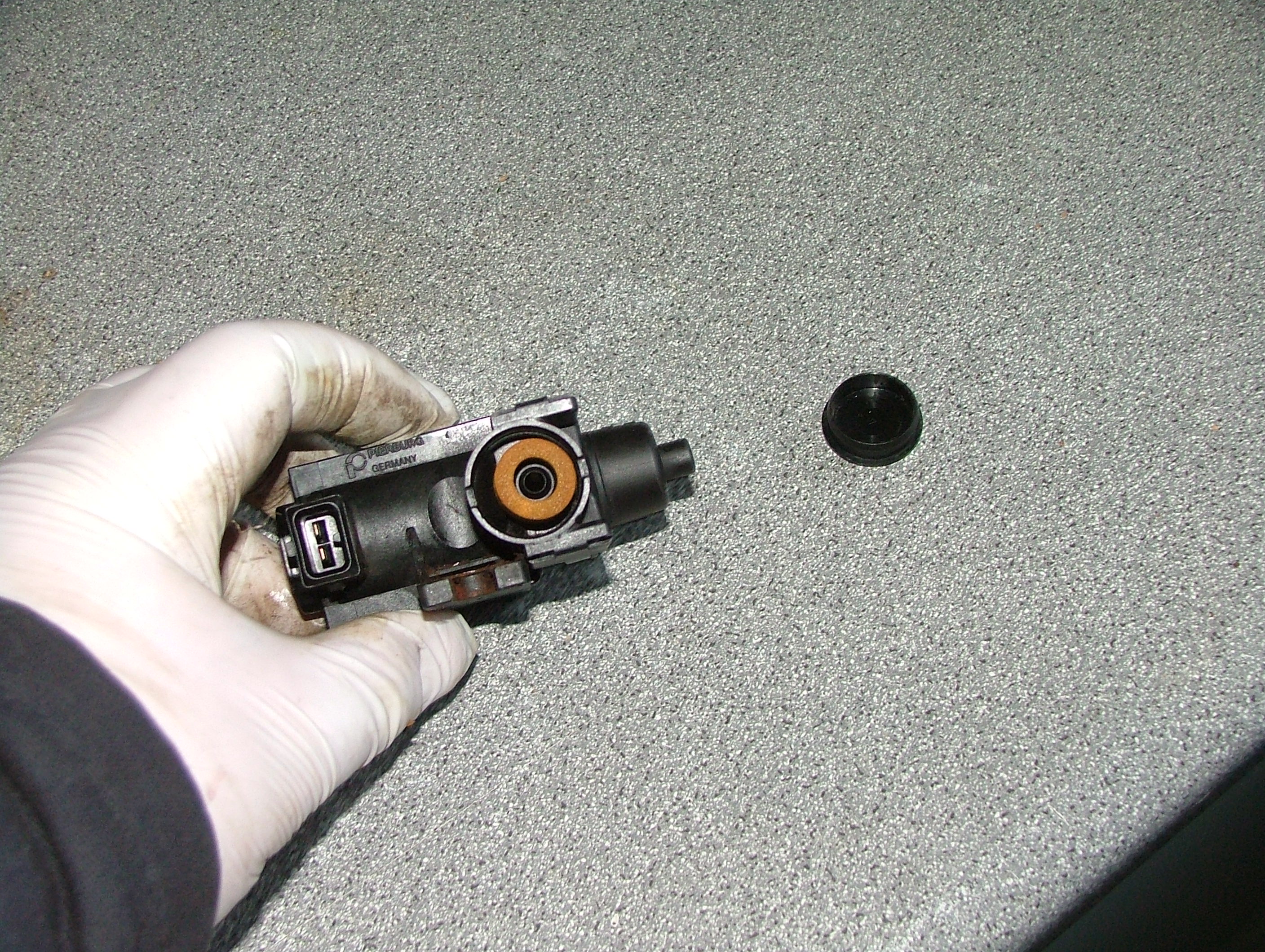

I would still take off and clean out the boost control valve, their is small filter in them that can easily get blocked. I would tap the valve gently and blow into the pipes on each side after cleaning out the filter compartment. Its an easy job. If the sponge filter is blocked, wash and dry it and put the valve back together. At the same time check the vacume pipes that go to and from it
I've taken it off the bit in the red circle looks like it will come off, not sure how to do it with out breaking anything :chin:
whoops look like i forgot the pic :eek:
ah i got it off, it didn't look like that bit came off, i'll put more pics up later so others can see. wasn't sure what to clean sponge filter with, it didn't look dirty but i cleaned with washing up liquid and water and lots of black came out, I'm just waiting for it to dry :)

I think the vnt solenoid test is engine off, you will be lucky to see it actuate once or possibly twice before the stored vacuum is depleated.
basically you can do the same test by starting and stopping the engine and observing the vnt actuator at the turbo(watch for approx. 10mm rod travel, sucks in on start up, lets back out on shut down) or even pulling the silicone pipe off the turbo actuator will do the same but with engine running you can pull the pipe off watch the actuator move and actually hear the turbo sound change , exhaust tone changes also.
that sponge I think is the vnt solenoid breather outlet to relieve vacuum and vent air in/out , if it was wet or damp when it went back in that's probably why it went worse, its blinded and cant breath.
