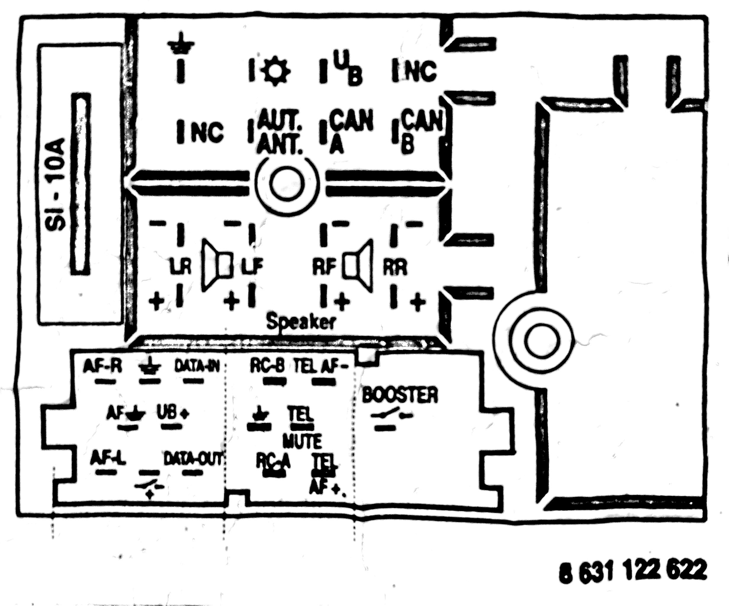

Going to fit my new Sony Head Unit on Friday and was scratching my head about switched-lives and CAN BUS until I read this.
Not sure if it helps, but I found a pin-out diagram on my factory-fitted CD unit which is really clear in showing where the connectors go - thought I'd attach in case it's of use to someone.

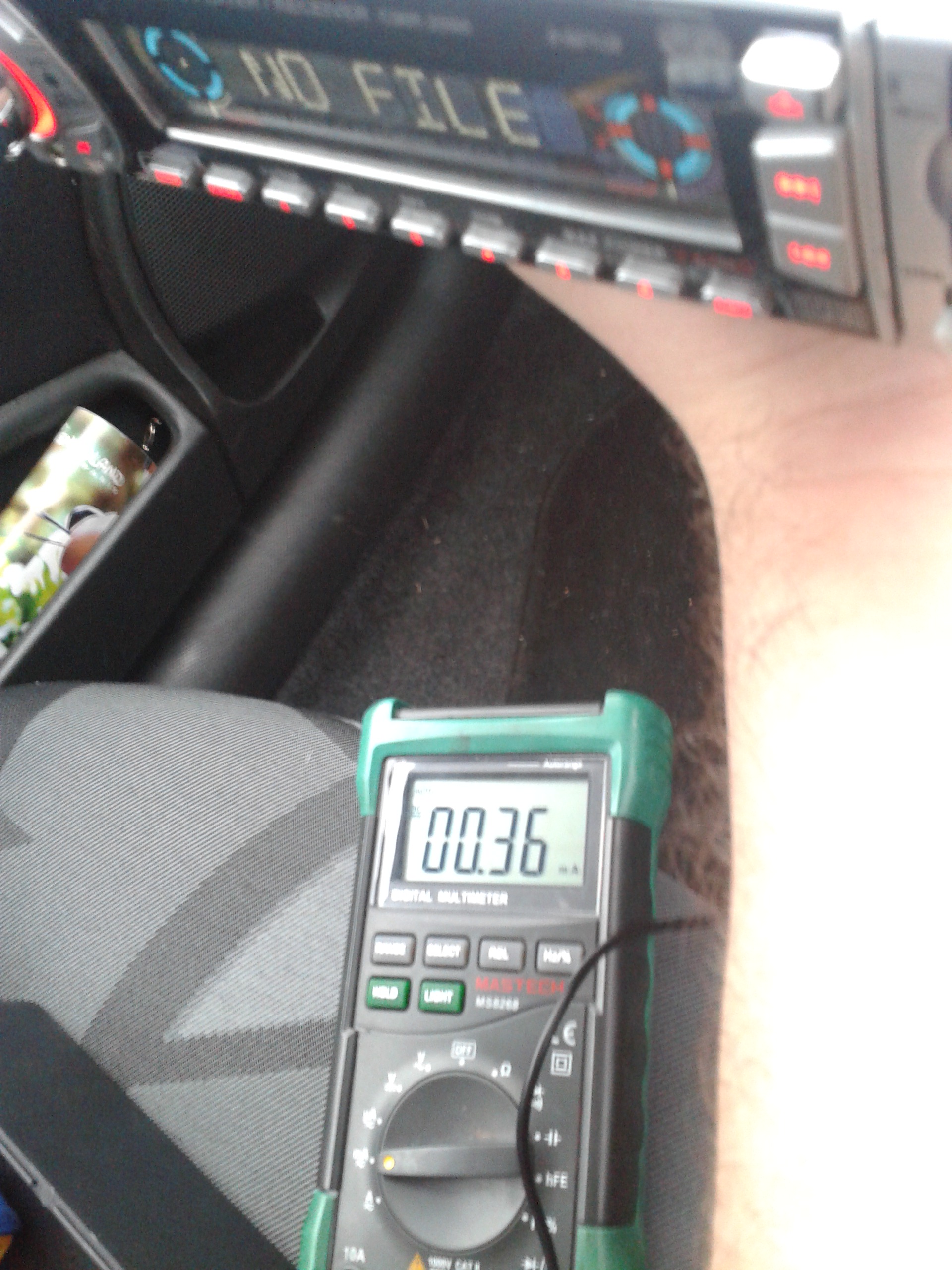

thanks I've done it but 3 days later my battery is flat ?
It's not on road yet as not taken my test but i run it weekly to keep it ticking over, I hope its just the weather & non running of car everyday that's caused the battery issue & not the sterio.
