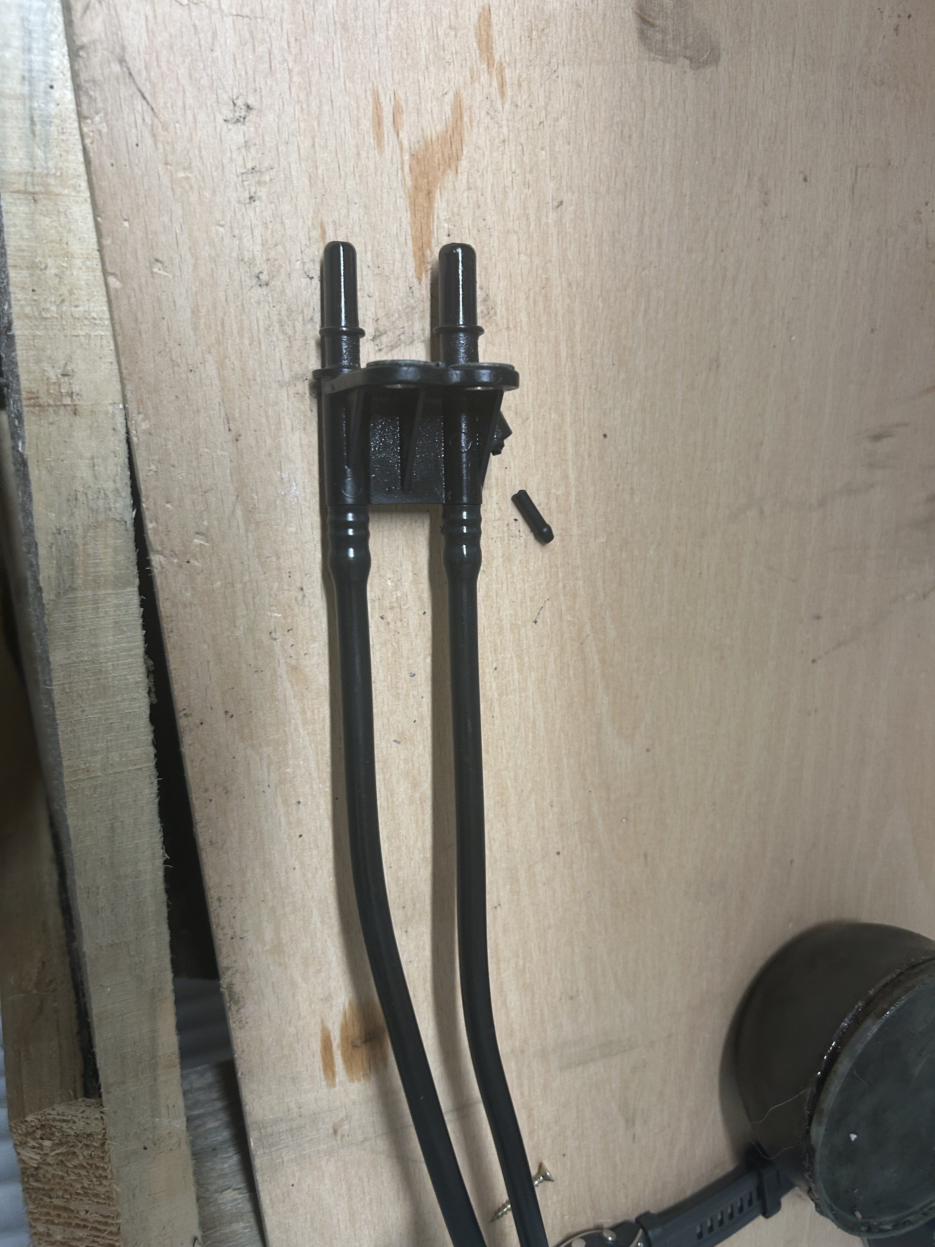

Changed the glow plugs after a warning, yup one was very high resistance. All sorted.
Turned engine over and wouldn’t start after a big bang and power steering warning light.
Thought I had left something under the bonnet and a belt had gone.
Diesel pissing everywhere under the front. Turns out I had caught a very delicate port from the fuel return from the injectors to the feed and return on the front when I dropped the intake manifold.
Started fine when I held the pipe on, no idea what caused the bang and power steering fault.
New part on order.
They could have made it more robust. 🤦‍♀️
Only positive is removing it was easier than I first thought with no room at all.

Could diesel have got onto the starter motor or alternator electrics?
Re power steering if diesel had got onto the drive belt if a manual pump it may cause a warning light for PAS, but not 100% sure re your vehicle.
If on belt, it may be an idea to clean the belt with a suitable solution so as not to damage anything.
Thanks, I have checked and no diesel is anywhere near the belts.
The starter motor though was saturated. :-(
Fingers crossed it was just some brake cleaner I used.
Will check everything carefully once it’s back together.
