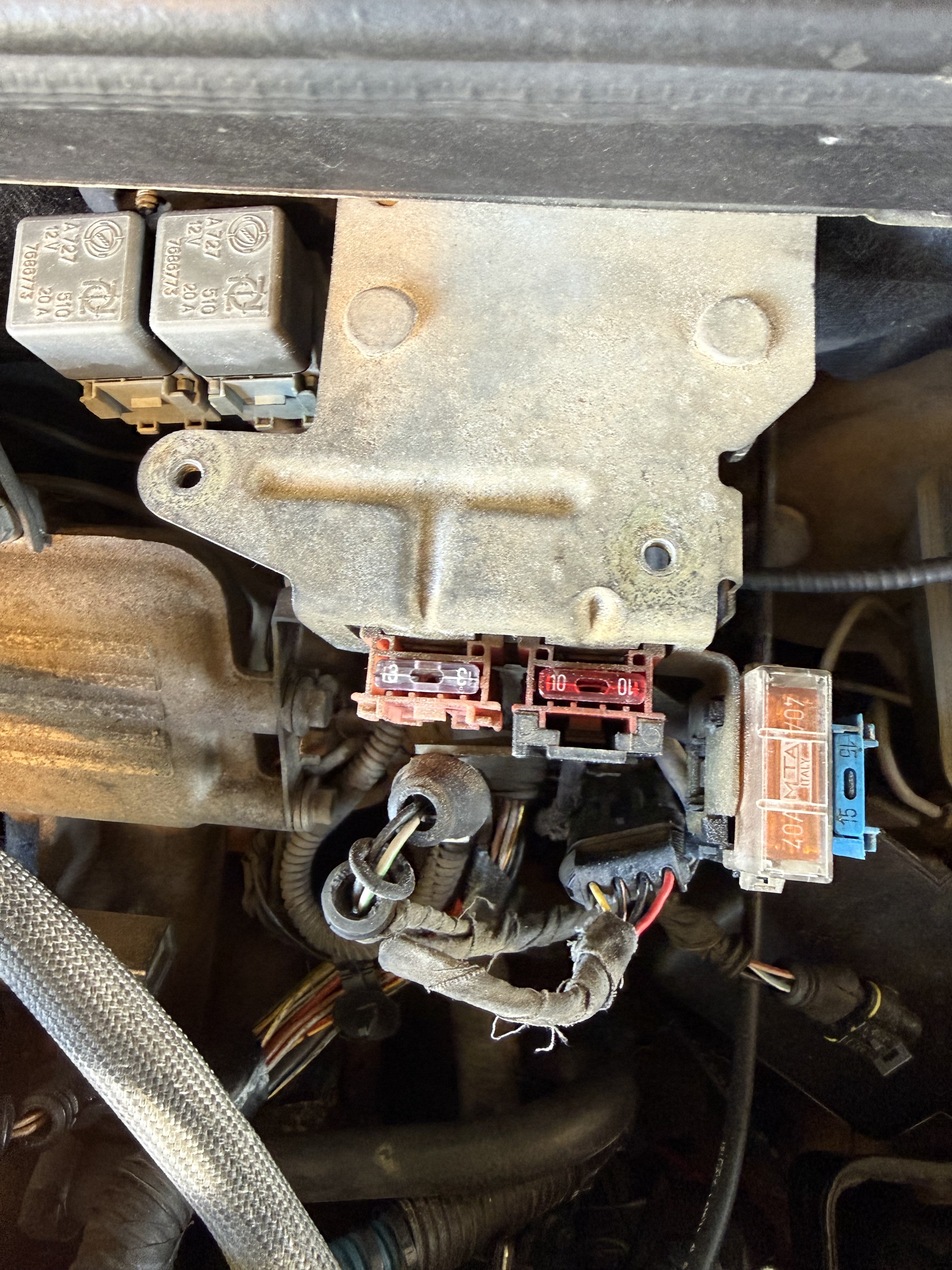

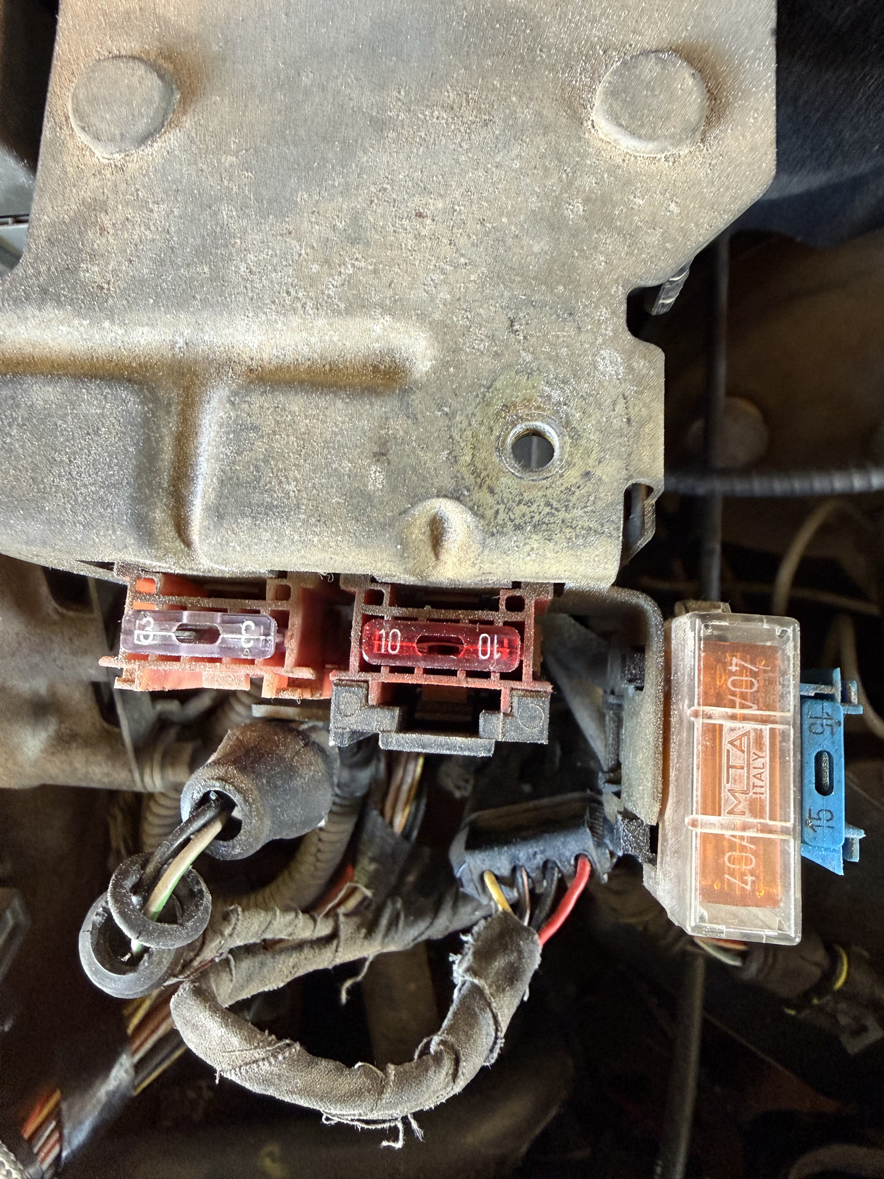

When I bought the cabrio a few weeks ago white smoke came out the exhaust which was a positive sign for work I was looking for. Now checking the reason for the smoke I need a compression test after the oil was clear, no bubbles from the brown cooling water and plugs are fine. Attached are fotos of the fuses in the engine bay. Can one of you please tell me which fuse I need to pull to stop the fuel and also what that small plug in front of the cover is for. Thanks in advance.
