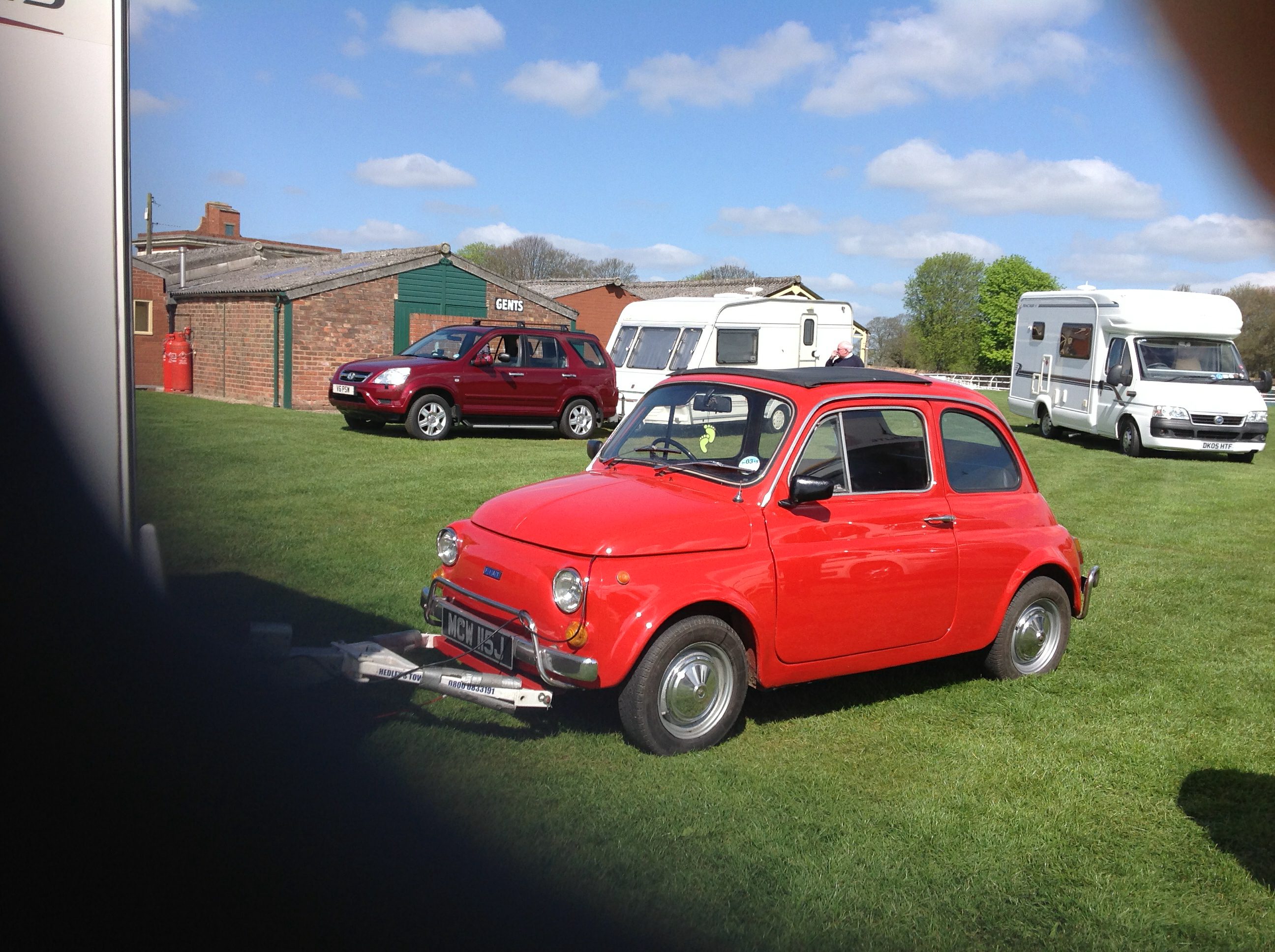

Pics as promised. Maybe video later. The only connection to the Fiat is a vertical stop that rests in front of the spring. A chain goes behind the spring and is ratcheted up tightly. Five minutes to set up and one minute to take off.
BRA_0117 by peterthompson, on Flickr
BRA_0119 by peterthompson, on Flickr
BRA_0118 by peterthompson, on Flickr
Hope these photos upload OK, never tried before, if not I will try again. The bracket I mentioned previously is the bar under the bumper that the A frame connects to, the brakes work via a cable connected to the fiat brake pedal (works very well), and the fiat rear lights work as a trailer lights would. hope this makes things a bit clearer.
