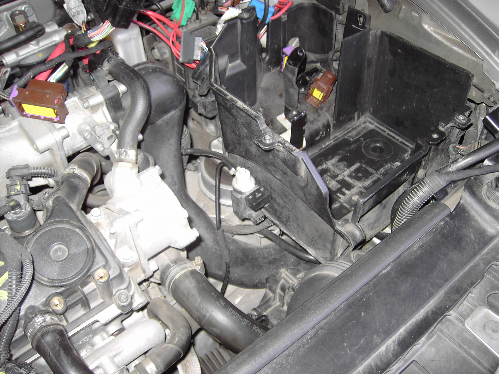

Nothing to do with earths, but if its not already been done, would be a good idea to move the turbo boost valve to the side of the battery box. It's usually under the left headlamp where it gets water into it.
