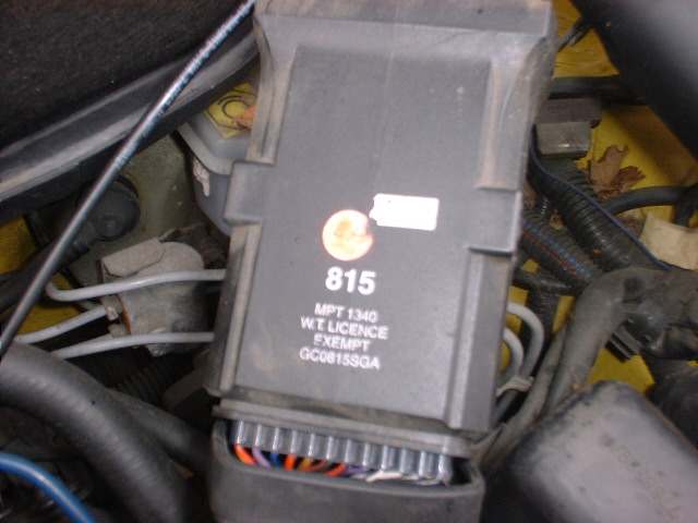

would it be easier to get a replacement alarm fob? as its a known brand [scorpion] is that possible? I haven't pulled it out yet to see the details on the casing but I am figuring that as my car is a non standard immobilised one, and the scorpion has immobiliser, then it might be best to keep it and not disturb the wiring
wiring doesnt normally scare me, I used to make my own complete wiring looms for the fords I used to race prep for others, and myself.
anyway, how would I get a new fob? I assume it would need reprogramming somehow? is it dear?
This is the alarm casing [attached pic] theres nothing on it to say its a Scorpion, but the car has Scorpion window stickers/warnings.
