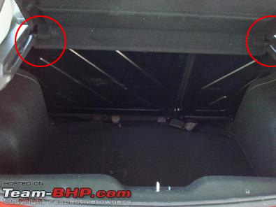

Having a similar query here.
My parcel shelf has nothing to roll back on, so when I put it down, it pretty much just dangles from the boot lid, in that it just rolls off the back of the support rails. What do I need to look for? Does anyone have a part number? I've tried Parcel Shelf Support, Parcel Shelf Rails, Parcel Shelf runners and can't seem to find what I want.
That is unless I just need those clips, which I have found.
Cheers.
Sounds like your clips are missing,... Any pictures ?
Hi, thanks for the reply.
Not got any at the moment, but I will take some tonight and put them up.
Meanwhile, just to clarify, I've attached an image indicating where I mean :)

I had this exact issue when I bought my GP.
One of the clips on one side was missing and the shelf didn't go all the way down when you open and close the boot.
Though your picture is a little small it looks like they are also missing on yours.
I bought a new one off parts world, for some reason I have the invoice right here next to me.
Item no: 230766416107 - Genuine Fiat Abarth off side rear parcel shelf clips for the Grande and Evo
£3.99
I found mine a right pain to fit in though but it does go in with a bit of muscle

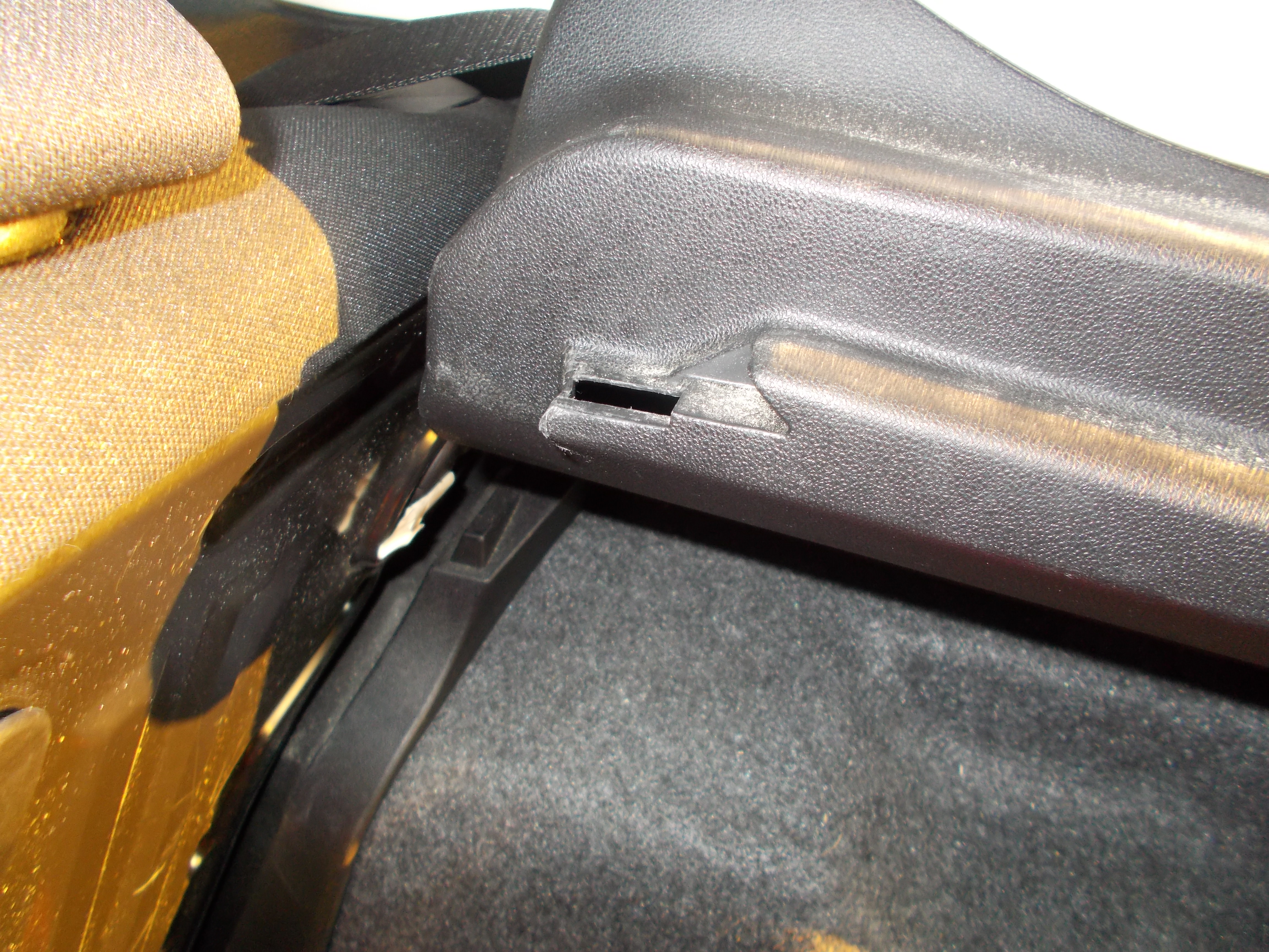

Thought so. I've been going by this entire time thinking the whole plastic had snapped.
Anyway, i attach a photo as promised. It's the same on the passenger side too.
Thanks for your help!

Nope, clip slides in there, they often come out when the boot is slammed and the shelf isn't in the fully down position when the tailgate shuts.
