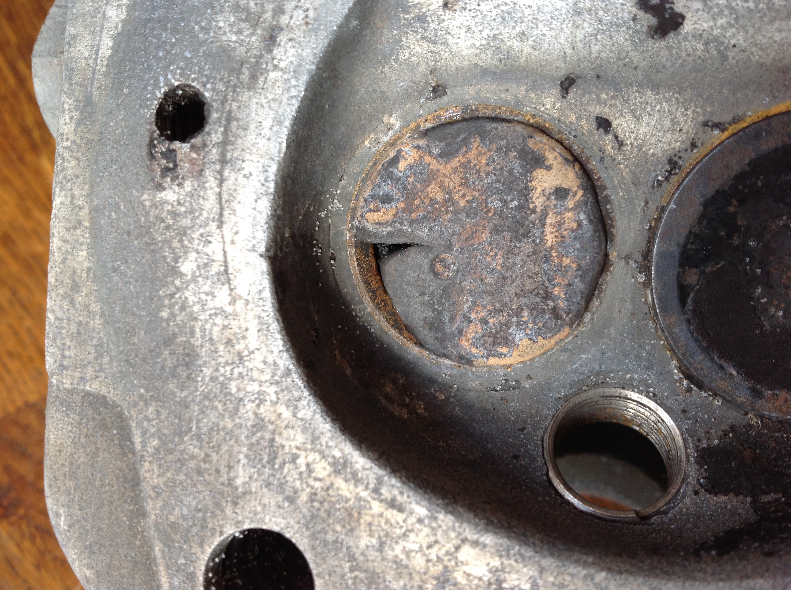

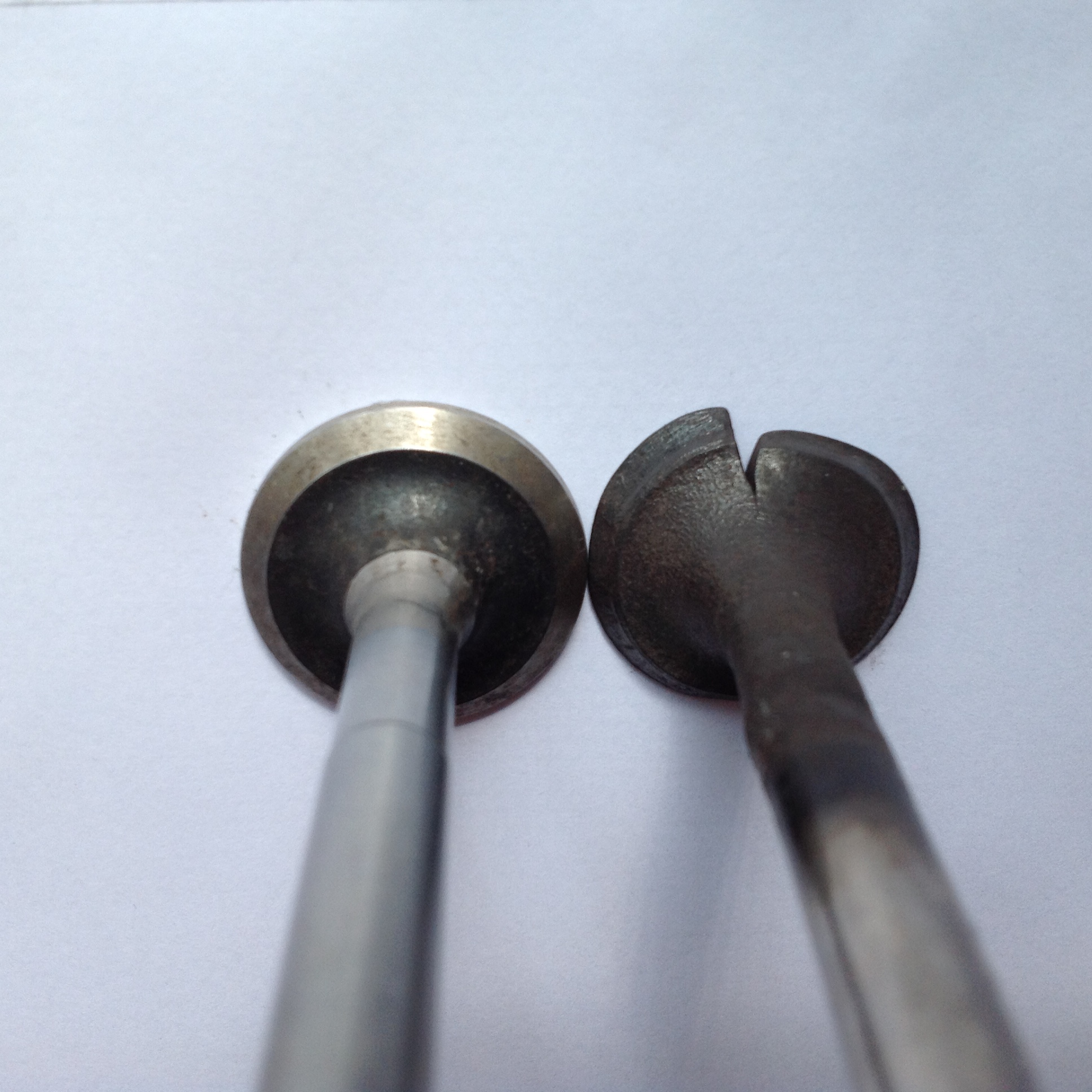

The worse burnt out exhaust valve I came across on a 500. Engine would run on one cylinder but amazingly would fire on both when the engine warmed up and the revs were up. The valve head had regressed up into the head as can be seen in the middle picture. The valve seat itself was fine.
