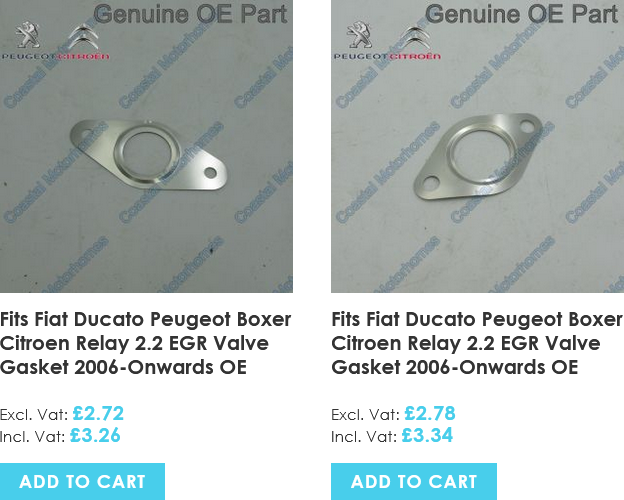

In the UK the gaskets are available for a few pounds. The picture shows the input and output gaskets from a supplier called Coastal Motorhomes. I think using the original metal gasket is best, as long as you can take out the two bolts to slide it in. Place the gasket on the input side of your blanking plate. Ideally you would use a second gasket on the other side of the blanking plate too.
You could use silicone sealer instead. The temperature isn't that high because it is after the heat exchanger. There is no heat insulation property required. Be careful not to allow silicone to squeeze out and enter the pipes or EGR, as it could break off and be drawn into the engine. Only a thin coat on each side of the blanking plate is required.
Don't worry about the throttle body, this engine is not designed to use one and there is no need to replicate its function.
