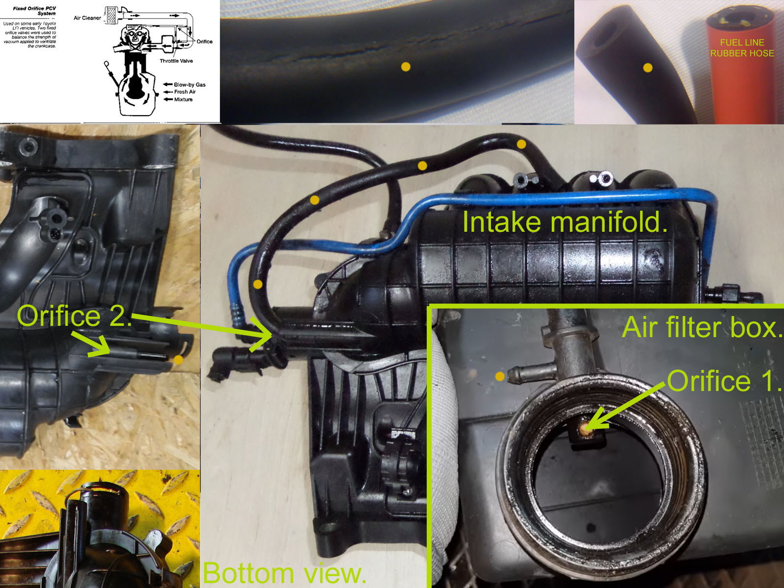

So...I fitted a second hand idle control valve..and ...it now idles smoothly.
After 12 months of trying different things a £3 part has finally cured it and my friend has a massive smile on her face.
And my sanity is finally restored..well almost
In the pictures you can see the location of the ICV..Its on the right hand side of the engine behind the two maid harness,red clips.
The first one shows the blue line ,which has 2 yellow sides that you push in to disconnect the air line. There's also a black electrical connector that unclip's.
Once you have removed these you will see a big metal clip that is a spring clip.Pull it off and be careful not to drop it into the engine compartment..
Once removed the unit slides out ..again be careful not to loose the two o rings that seal it.
I unclipped the big red clip to move the harness to move it out of the way.
Tbh its a relatively straight forward job..hardess part was refitting the clip.
HTH ..

The ebay picture/advert is the part fitted..only I paid £3 for it from my local breakers.
