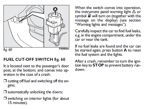

A akayd New member Joined Jan 27, 2016 Messages 1 Points 1 Jan 27, 2016 #1 where is the inertial fuel cutoff switch for fiat bravo 1.4 tjet sport. as my car is not starting and its showing this on the screen.
Davren Moderator Staff member Uploaded 10+ resources/downloads Joined Jul 6, 2008 Messages 16,418 Points 3,881 Location London, UK. Jan 27, 2016 #2 Hi, Welcome to the FF. Try here: . Attachments Bravo Fuel Cut-off.JPG 70.7 KB · Views: 401
