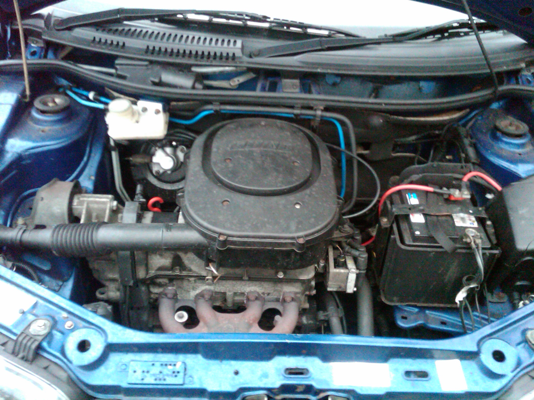

I hope you guys aren't getting sick of me to much but I really don't know much about cars but I am getting there very slowly. However I was just wondering where the air filter is located? I have been looking at the k&n air filter the one that's like a rectangle haha. But I don't understand where it would go under the bonnet so can anyone tell me where my air filter will be located pleeeease :yum:

You see the almost round black thing maybe 18" or so across on top of the engine? It's held on by 3 or 4 screws?
That's the air filter cover.

That BIG black Circular thing with a pipe coming out the side going to the side of the car
Yea thats the airbox -
Removal is undone the clip holding the external pipe - 2x10mm Bolts and 1 spring retaining clip at the front
It simply pulls off then
But if your doing just an airfilter change or check
There are a series of like 12x Screws - Either they come out
Or are a pain galore and refuse to budge
pop em out - light taps around edges and it pops off - pull filter out
hoover box out - new filter in - screw it down in pattern so it sits flat (box method)
And your done :)
5mins :)

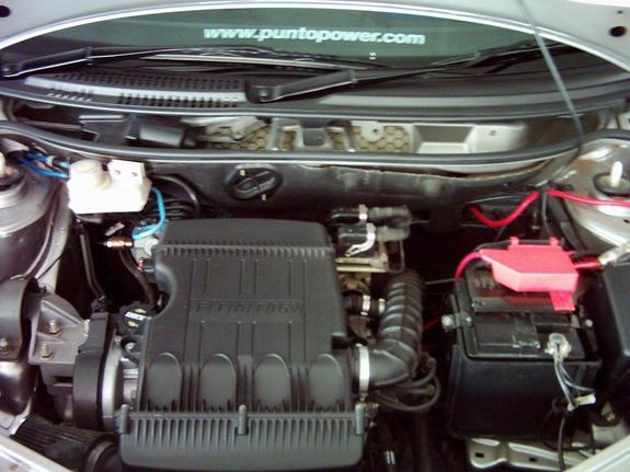

Not 100% correct, my 06 punto has a square filter housing on it, and its an original one fitted to the car
