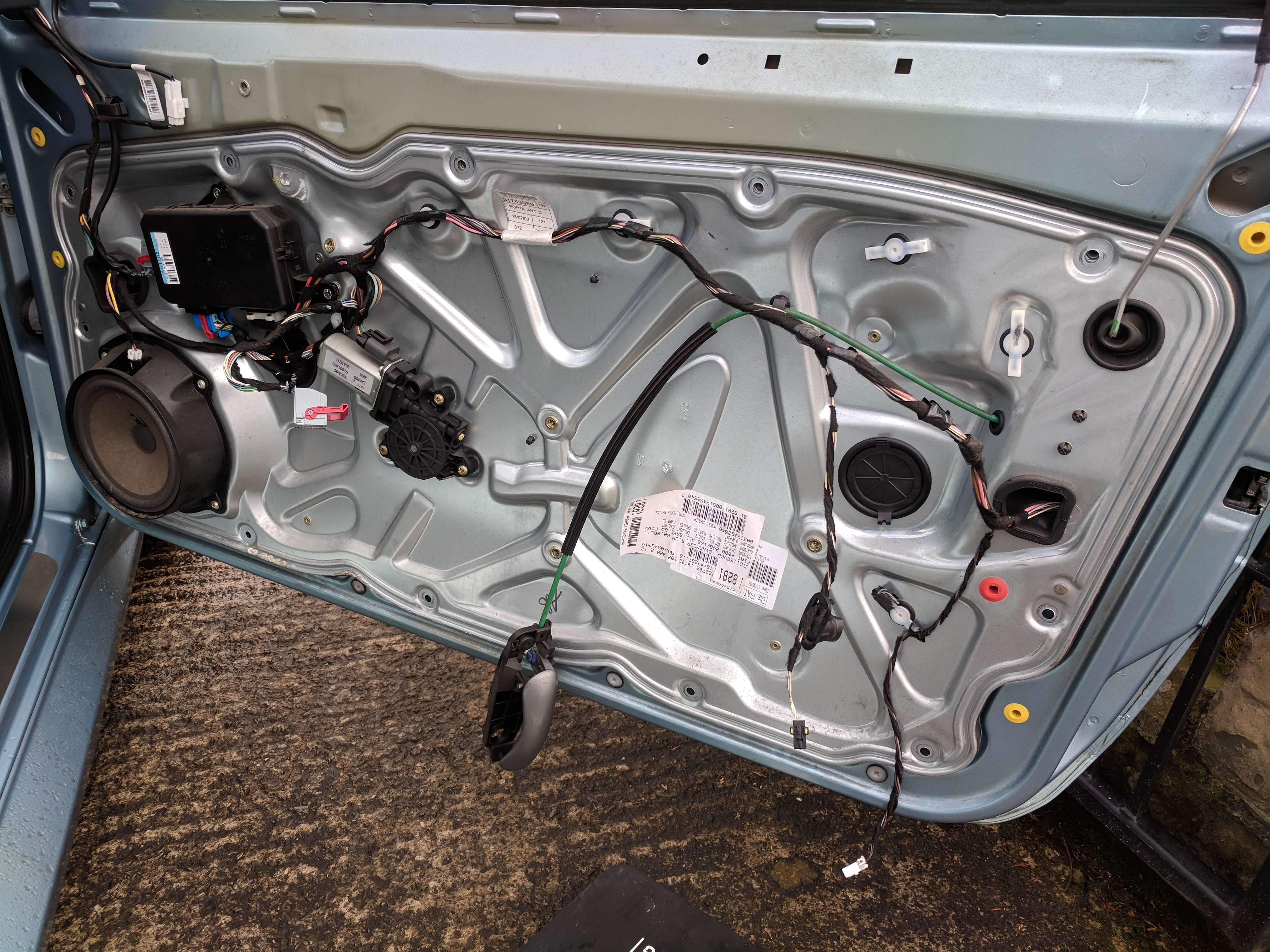

So I have decided to try and fix the door today. I have got this far, but it's still fixed on somewhere? Any ideas? Is it the pop rivets? Please feel free to highlight on the photo where I am going wrong ?
I dunno how the Stilo inner panel is bolted to the door... but if you can't lift the trailing edge away from the door that might suggest the panel is bonded to the door with some sealant. You may just need to poke something under the panel and lever it away from the door (at least enough to see if there is any sealant underneath). When you re-fit you would just need to replace (or "top up") the sealant... use some regular silicone or instant gasket type stuff (or the stuff the plumber uses around the bath.. same stuff).
If the panel lifts up at the edges but is still hanging on to the door then you may need to remove the motor and ECU thing.. they may bolt through onto the door frame underneath. Just loosen the bolts and see if that makes a difference.
My bet is; both of the above. Bolts AND a sealant.

If I take off the window motor, is that on a belt that attaches to the window? And do the rivets hold the window mechanism on or just the panel? LOL I don't know what to expect.....
