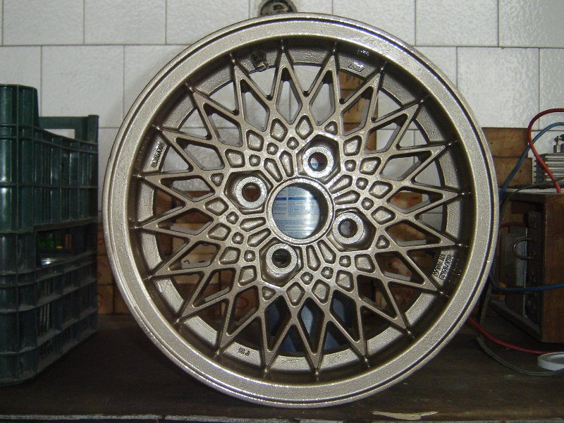

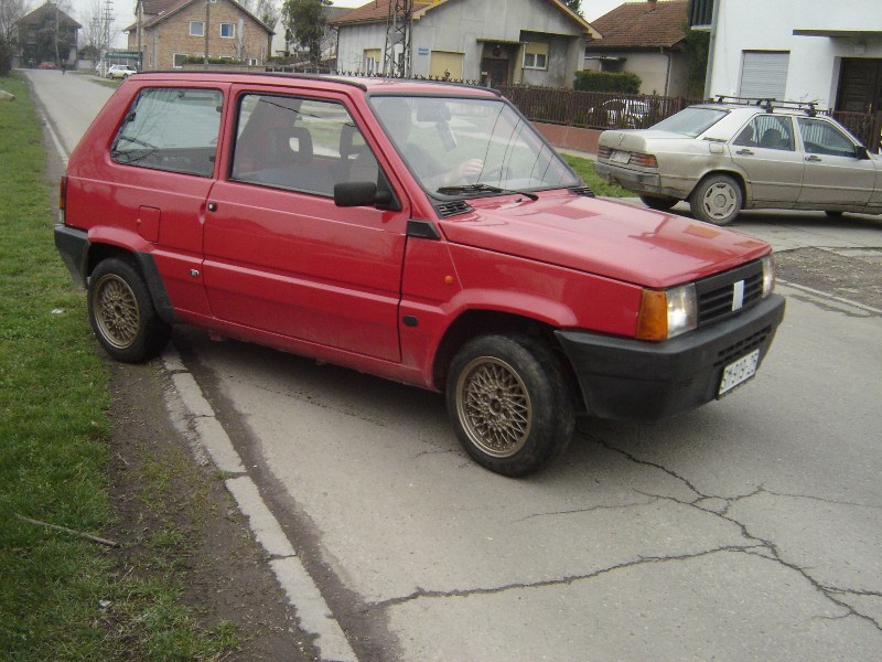

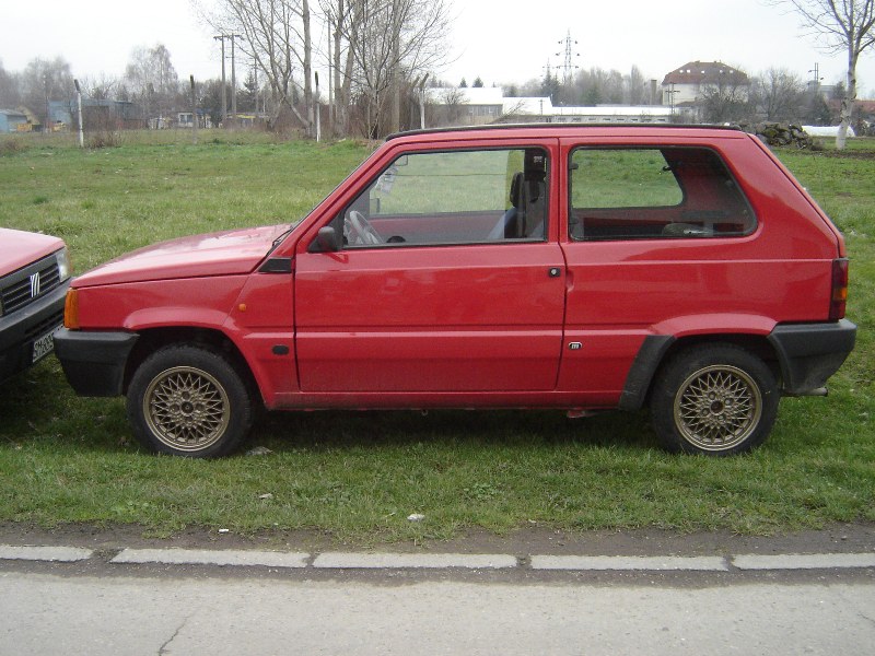

Here they are :)
They are original Fiat X1/9 speedline alloys if anyone wants to know. Type in Fiat X1/9 into wikipedia or google and you can spot a few with them on.
Dimensions are 5Jx13
If anybody has some tyres for sale like 165/55/13, 175/50/13 or a similar combination then please let me know.

I take it you got them from ebay? I was watching a set the same, probably the ones you have, from the picture it looked like one was buckled so I didn't bid, but I take it they are all ok?
no I found these in the classifieds section on here. Some of them have a few grazes from curbs but on the whole they should look pretty slick!
another lovely looking set of rims there(y) 165/55 not a bit small though?
Yeah they are kinda narrow in the grand scheme of things, but the '88 panda is running 165/55 on those white wheels and it handles pretty good.

Oh and also the rims I have are about ~15mm more offset than standard panda rims, so I have to be careful what size tyre I get in order to clear the archs lol

I was thinking more of the radius than the width, 165/65 on mine is probably closer to standard, 165/55 is what you get on the cinq rims and leaves your gearing a bit low. 175/55 probably more like it size wise. (if you look, 165/65 is a tad more common so the tyres are cheaper too)
Wondered about the offset too, X1/9 is rear drive so offsets are usually way different. Be interested if they fit OK cos they're a lovely wheel if they do!

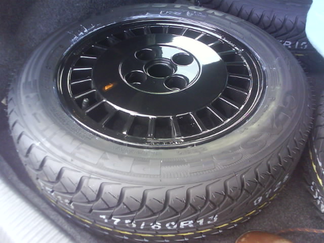

Probably not what you're looking for, but I run 175/60s on my Panda (on Uno Turbo wheels) They were very reasonable, sourced from e-Tyres
Got something identical for trackdays in the garage! Same gloss black finish and everything! Great wheel and obvious choice for track Pandas or funky Pandas. 175s on these really are as wide as you can go and retain almost full drivability. I do get some "light clattering" over curbs with these on with lowered suspension.

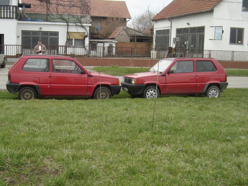

loking where it sits compared to the other panda on the photos I'd say it was dropped a tad already.
:ROFLMAO::ROFLMAO::ROFLMAO::ROFLMAO: You don't know our roads:bang::bang::bang:,they are for the suv's, not for a lowered car.And we are very poor with tunning parts.
hmmm, just a full tank of petrol and a bit of wear and tear off them roads lowering then(y)
