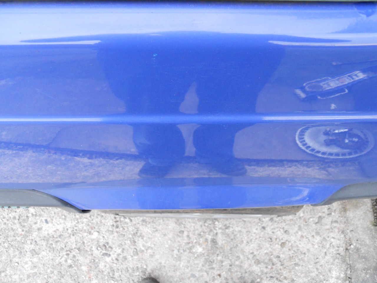

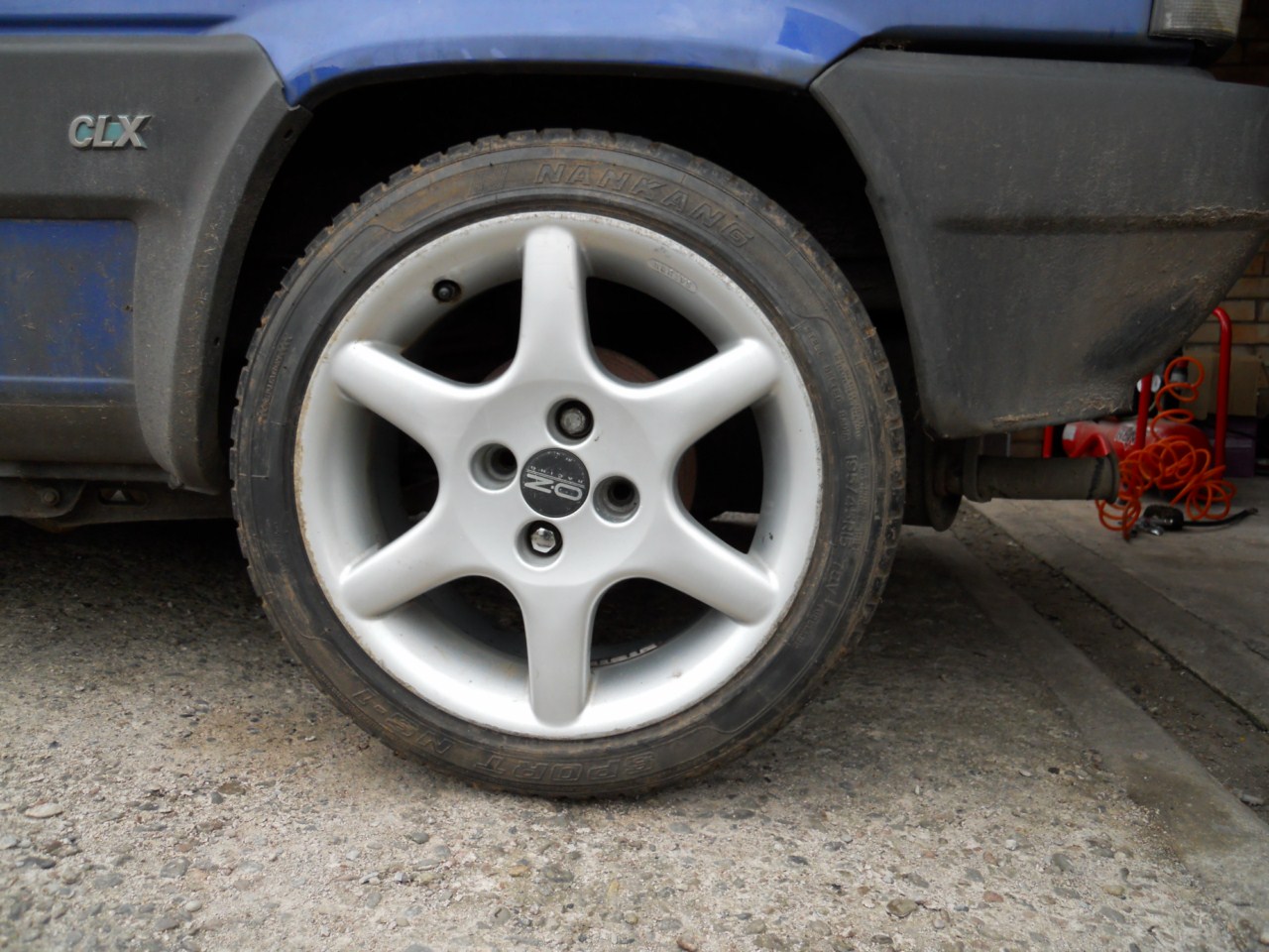

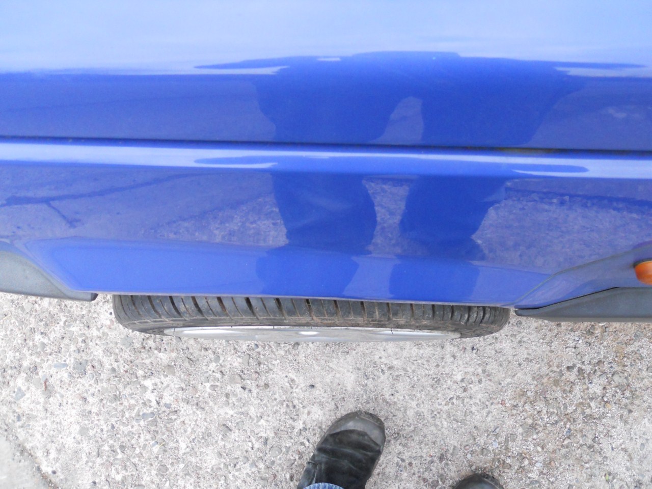

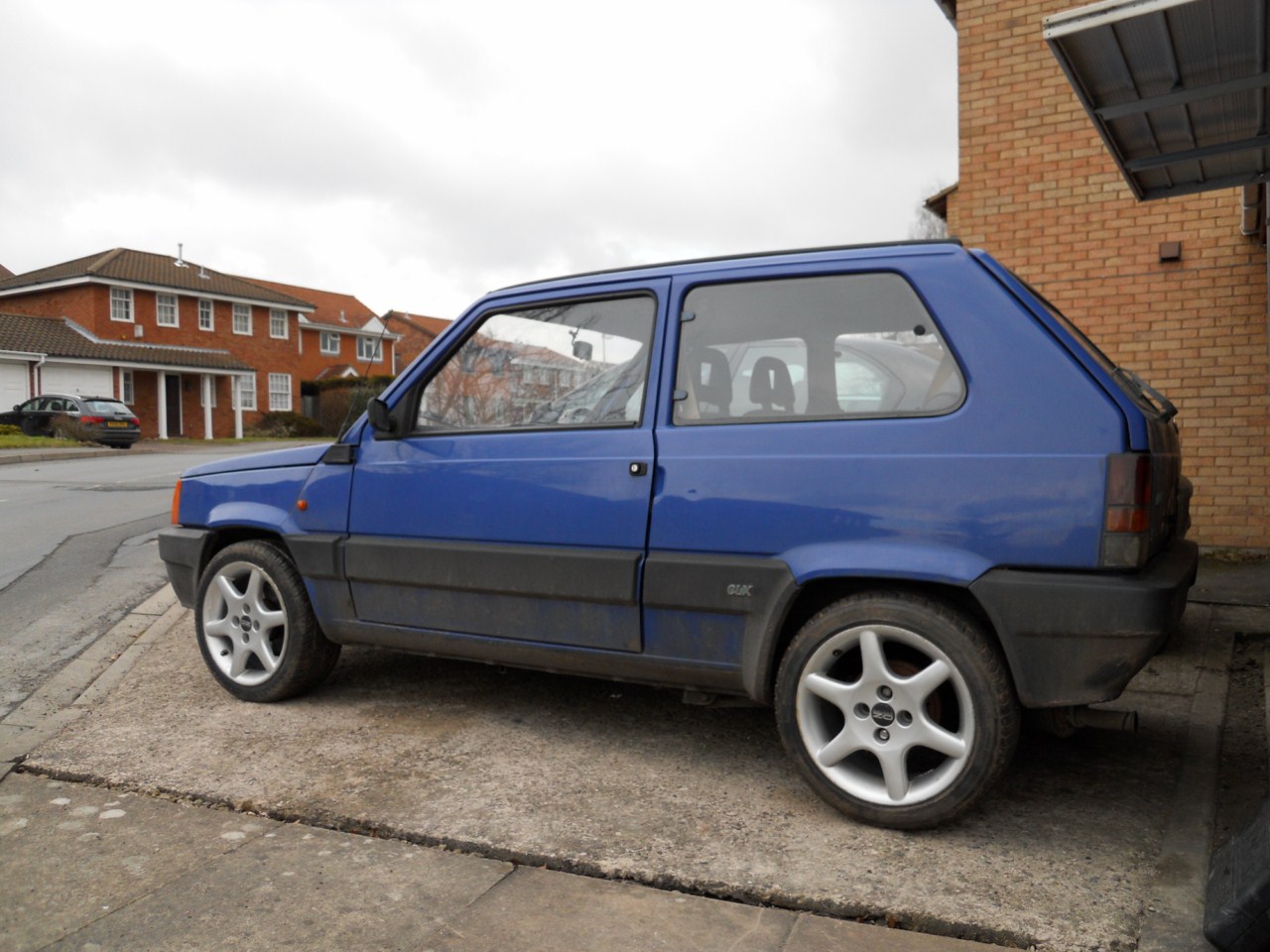

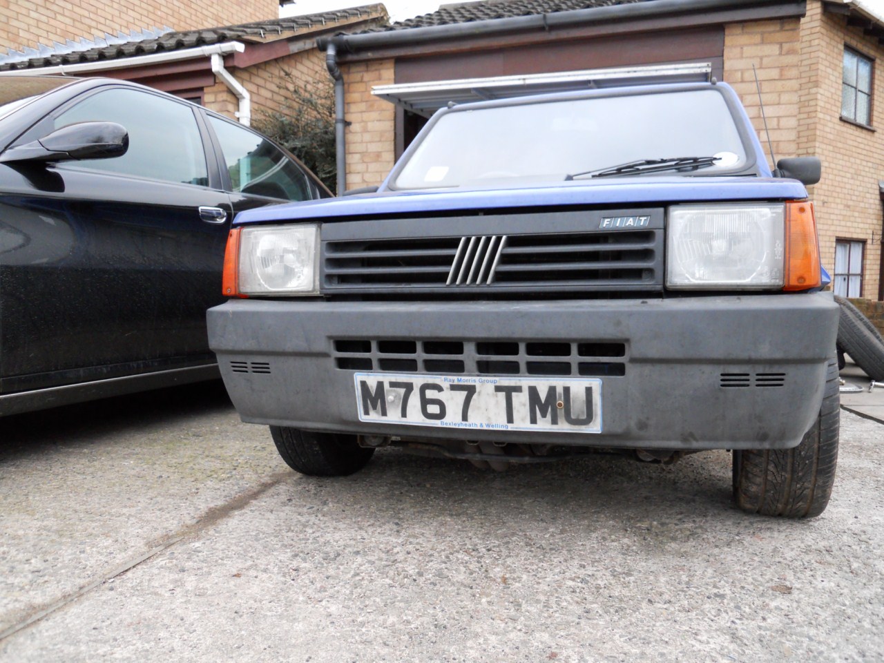

I have some 15" x 7" wheels with 195/45 tyres. I'm going to test fit them to my Panda to see how they are. 7" is probably too wide though, 6" should fit OK I reckon. I'll post pics later.
This is a bit of a hi-jack, so apologies to the OP.
15" wheels are not easy to fit and come with their own issues, but gearing isn't an issue. 195/45r15s are only 8mm taller than what I run every day and I am considering going a touch taller than this when my tyres are worn. With a larger engine like Alex plans to fit, you want the gearing.
Main issue is the fouling on bodywork.
@Huck: If you are considering my brakes I offered you, there are options to run 14" or 15" wheels with them. I will explain when you come over. Don't buy any wheels until you know the brakes you want!
Thanks Lewey, it was the 7" bit that I was most concerned about too.
The 15" x 7" wheels fit with a 10mm spacer on the rear and none on front. Only put one side on. Went for a drive down the road and there weren't any strange noises. The rear would rub if you loaded it. All depends on how hard suspension you intend to run I suppose. (y)
That's quite surprising! even my 175/70/13's rub on the back when loaded, so to have 15" x 7" do no worse opens up the options.
Do you think there would be any performance gains going this route Lewey, or is it a choice better kept for creating a particular look?
For most this is not gonna be a solution they can live with, so you need to want them, either for look or brakes. I suppose you need to be comfortable with the look, even if there are performance benefits. In the dry, it would afford you epic grip for sure, partly due to the infinitely better tyres that start at 15". The low profile does give you a sure-footed feeling when cornering, even at 40MPH like I just did. Practically speaking they will give you torque steer, a wondering steering feeling, rub on full lock and will increase your unsprung weight unless you find some very light wheels.
I think 6" wide with 195/45 tyres and a slight mod of the rear arch would be fine under most conditions though.
