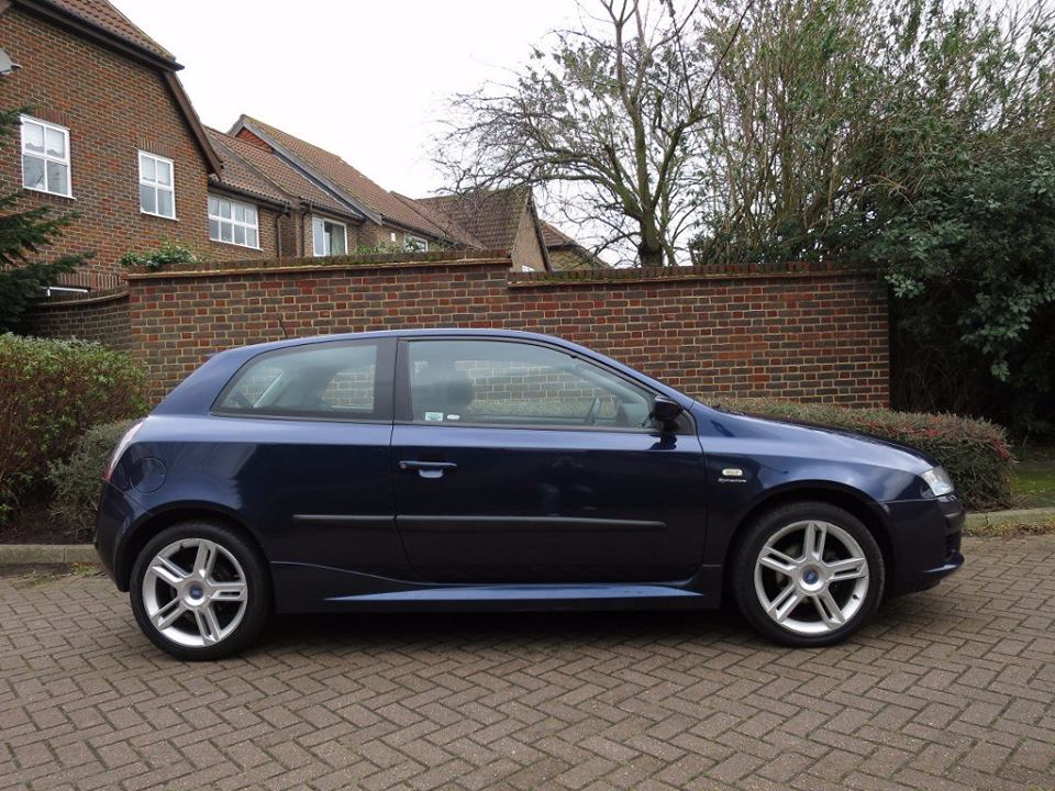

Hi ,i have a pair of blades alloys and i want to change them with ones from a corsa 4x100 , 17' .
Will they fit withwobbles (16 * 12x1.25mm Thread 60 Degree Tapered Zinc) ?
What else should be aware ?
Will they go on corsa bore is smaller? 56.6 vs 58.1
Looking at the wheels they aint original gm wheels so the centre bore maybe larger than the 56.6 but like @[corcai I would agree the centre bore would need to be checked on the wheels before you buy

Thanks for the answer , so i will need to check the bore and after to buy some spigots and wobbles .
It's my first car stilo ,and i love it (y)
Just out of curiosity ady1266 how comes your changing your blades and where abouts you from and any pics of your stilo. Also the tyre size of the stilo 17" wheel is 215 45 17

They need refub and also 2 new tires . So i found this wheels almost new tires/wheels 140pounds.

The pic you put aint showing mate me personaly for what its worth I would refurb the blades and put tyres on them tbh

Yes, check the bore size, any good wheel website can tell you the bore sizes for your car, make sure stud pattern is same and that the offsets dont differ too much, then source some spigots to make them fit snug on your hub and the car wont feel like mr blobby lol.
Id say the spiggots are a must as i have experienced with and without and it's not very pleasant, few brown skids marks and two days very gentle driving till they arrived for me and all was good again!
Good luck
You can get budget tyres for about 40 quid each refurb wise you could keep them silver or change the colour imo white would look good against the blue unfirtunately your too far from me as I would of happily refurbed them for you
