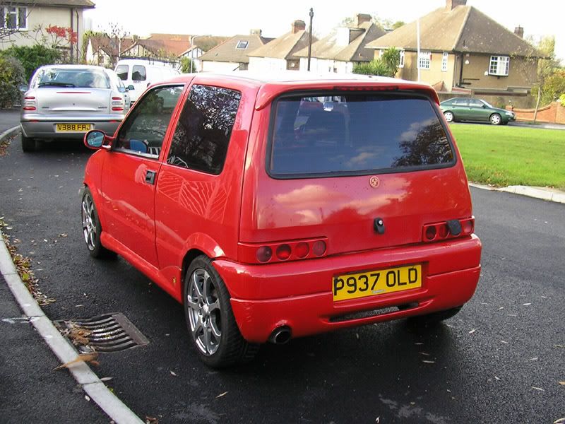

Hvaing had a Cinq with both 15's and 6 speed gear box, id say do neither
The gearbox doesnt effect top end at all, as the box is off the Punto EL, which was never sporty. AFAIK the end ratio is exactly the same!
And dont get me started on the wheels! the rubbed on ****ing everything, and that was with the arches rolled! then you had the rubbing on the gearbox itself, which limited lock just a tad
