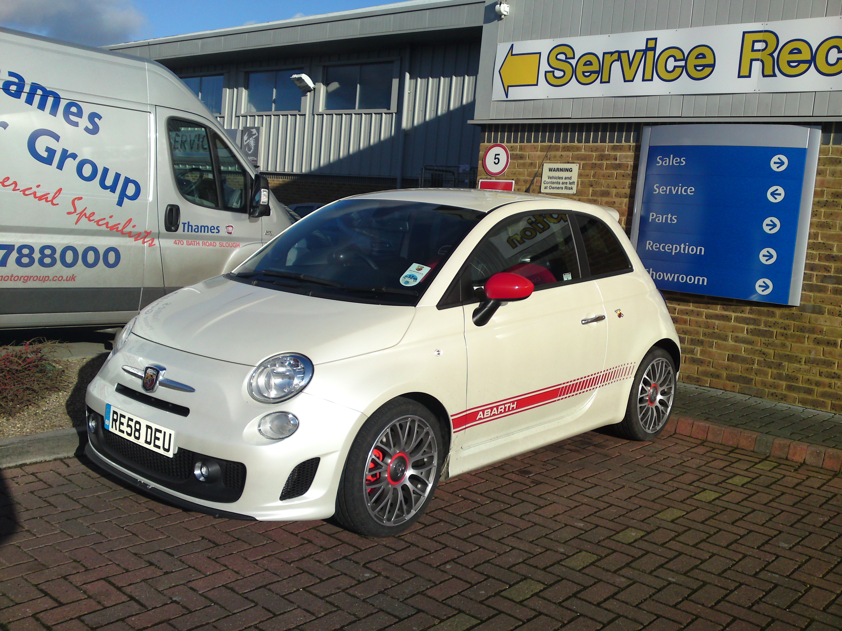

the one i tested was on 17"s and rode really well, 16"s look undersize at standard ride height imo, though OK when lowered (see pic attached)

black is on 16'' pearl white is on 17'' hope this helps you decide(y)
it's the rear that looks the worst - you can get your fist between tyre and arch!

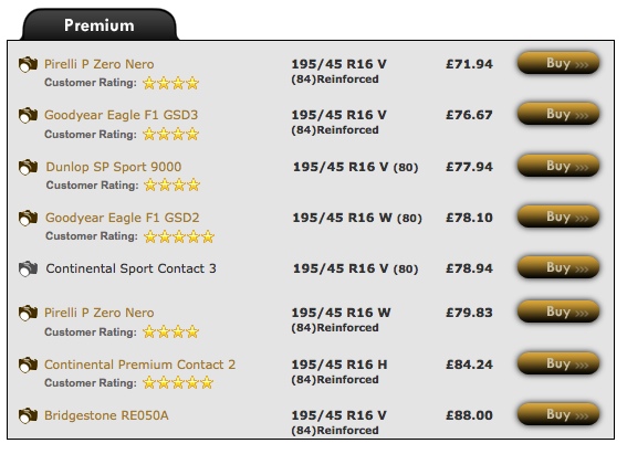

Black Circles begs to differ on costs.
For example fitted costs:
P Zero Nero 16" £71.94 17" £89.23
Conti SC 3 16' £78.94 17" £121.77
Generally all the costs for 17" seem much higher
  • 195:45 16.jpg
    195:45 16.jpg
  • 205:40 17.jpg
    205:40 17.jpg
check prices on 205/40-16 ;)
