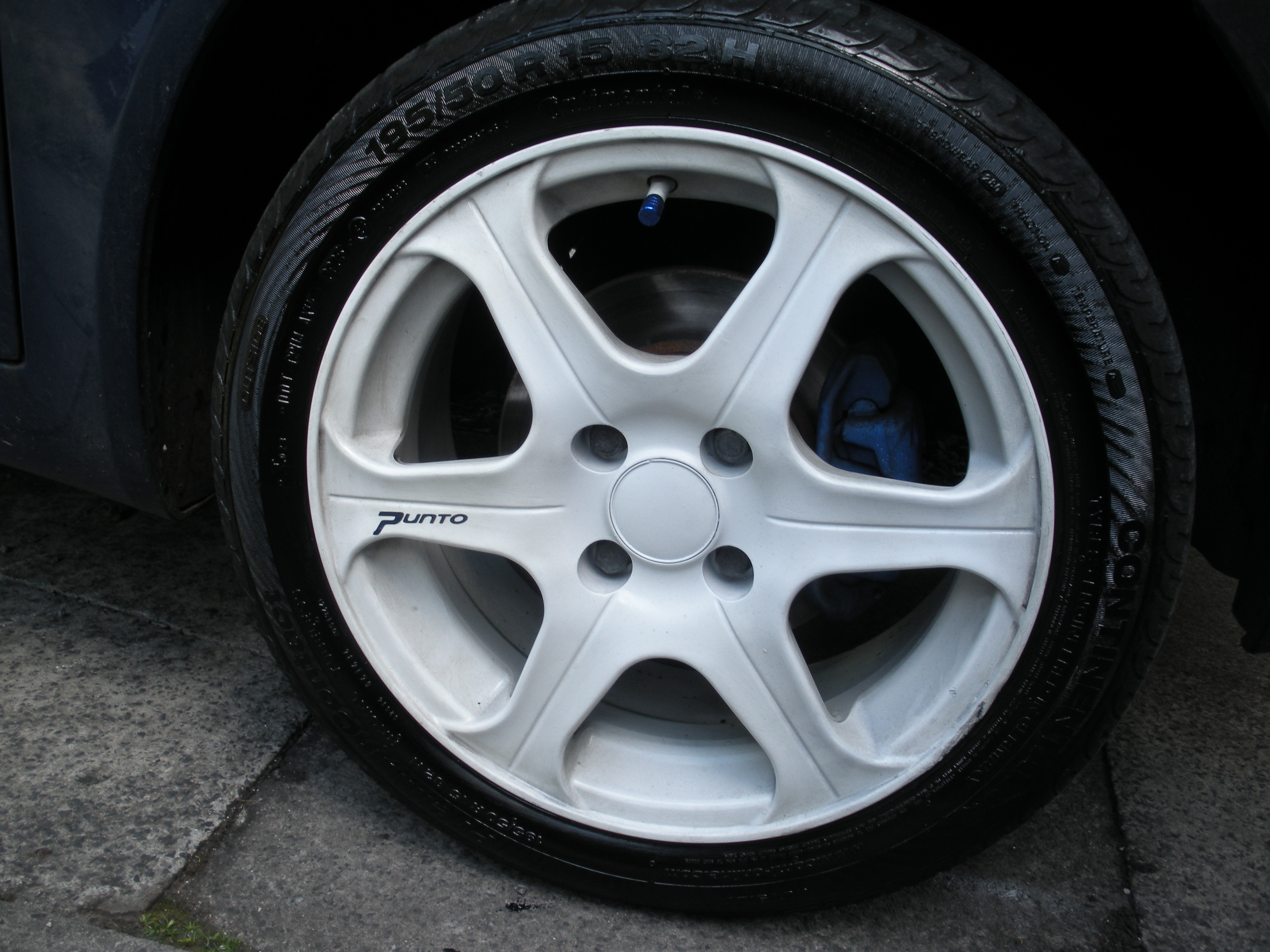

Yeah I recently did this with mine but in white, I used epoxy resin to fill the dents/cracks etc.
3 coats primer (20 min in between coats, slightly thicker top coat and leave 24 hours to harden)
Same with colour then same with lacquar
Epoxy resin takes longest to set but do it properly and you get a great finish! Not a job you want to rush
Heres what mine look like now (this one does have a chunk out still where the idiotic tyre fitter knocked the epoxy resin out! :bang:)

Epoxy doesn't stick very well to alloy. Body filler might be better. Or take it to a good stovers and get them to prime it and fill it with their heat proof filler before a final stove finish.

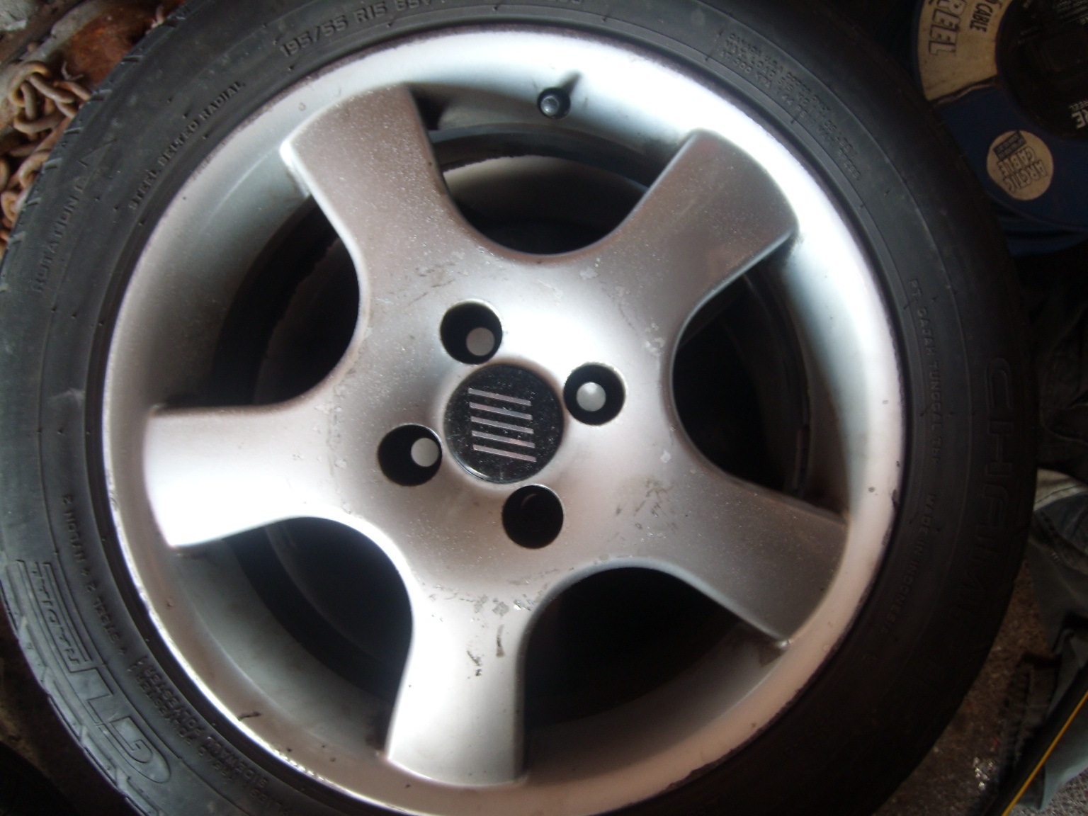

Well here's the pictures I took of my wheels the other day.
The first is the alloy as it was, you can't see it very well but it was pretty scratched up:

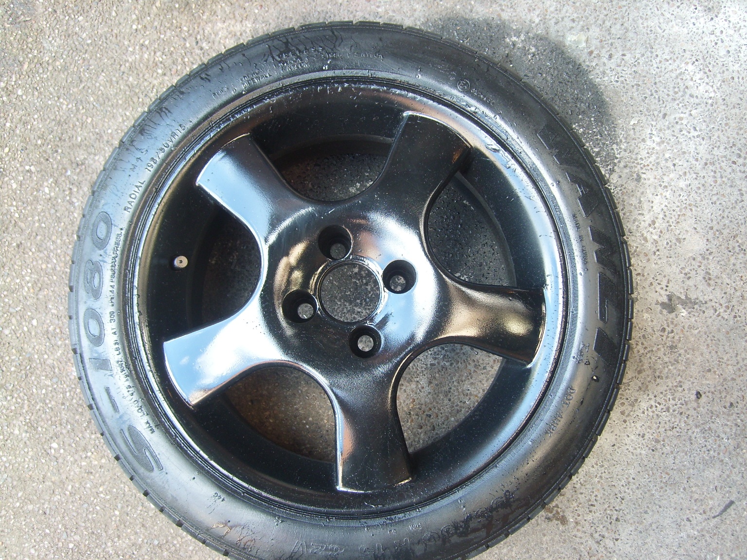

And here's what I've done to it. The wheel was wet when I took the photo as I'd just washed it:
I've sanded it down all over with rough grade, then smoothed it with a lower grade paper, then gave it a few coats of primer and then the gloss enamel on top. Any suggestions? All input is welcome :cool:

I use CJ Ward from Burton on Trent. They charge £25 for a 17 inch motorcycle wheel so some car wheels maybe a little more - more spokes to shot blast. One like above I'd guess at the lower cost. The tyres have to come off. But that's not a bad idea - old wheels can be pitted with corrosion in the tyre bead area.
They say that stove enamel is tougher than powder coat but they do both. If there are any deep scratches talk to them about filling the groove. Normal fillers wont handle the baking oven.
At their prices I'd not be wanting to waste the costs of spray paints not to mention the time and the chance the paint wont stick.
