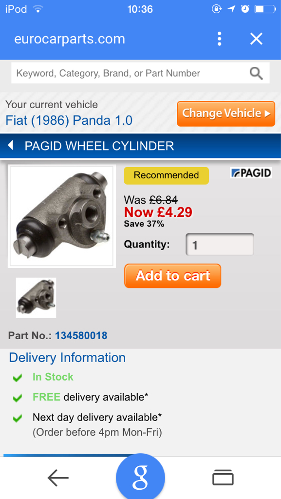

matthewnum14 New member Joined May 31, 2015 Messages 35 Points 14 Jun 20, 2015 #1 The off side wheel cylinder on my 1986 panda 4x4 has seized Is this new correct for the 4x4 It looks the same but I know that steyr puch replaced the back plate and drums so I don't know if it is

Bartpanda Established member Joined Jul 4, 2012 Messages 796 Points 326 Location Krakow. Poland Jun 20, 2015 #2 any with 19.05mm pistons inside and 10x1 thread will work fine Last edited: Jun 20, 2015
OP OP matthewnum14 New member Joined May 31, 2015 Messages 35 Points 14 Jun 20, 2015 #3 Okay thanks I'll order one !
