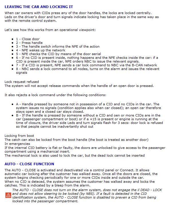

It would be a little 'interesting' to be sure of whether the doors have automatically locked as you walk away with the CID (roundel) in your pocket - when you walk back to check, the doors will have unlocked :eek: also, I note that for this automatic locking, the steering is NOT locked. I guess that's so if it loses communication with the CID while driving, the steering won't lock unexpectedly.

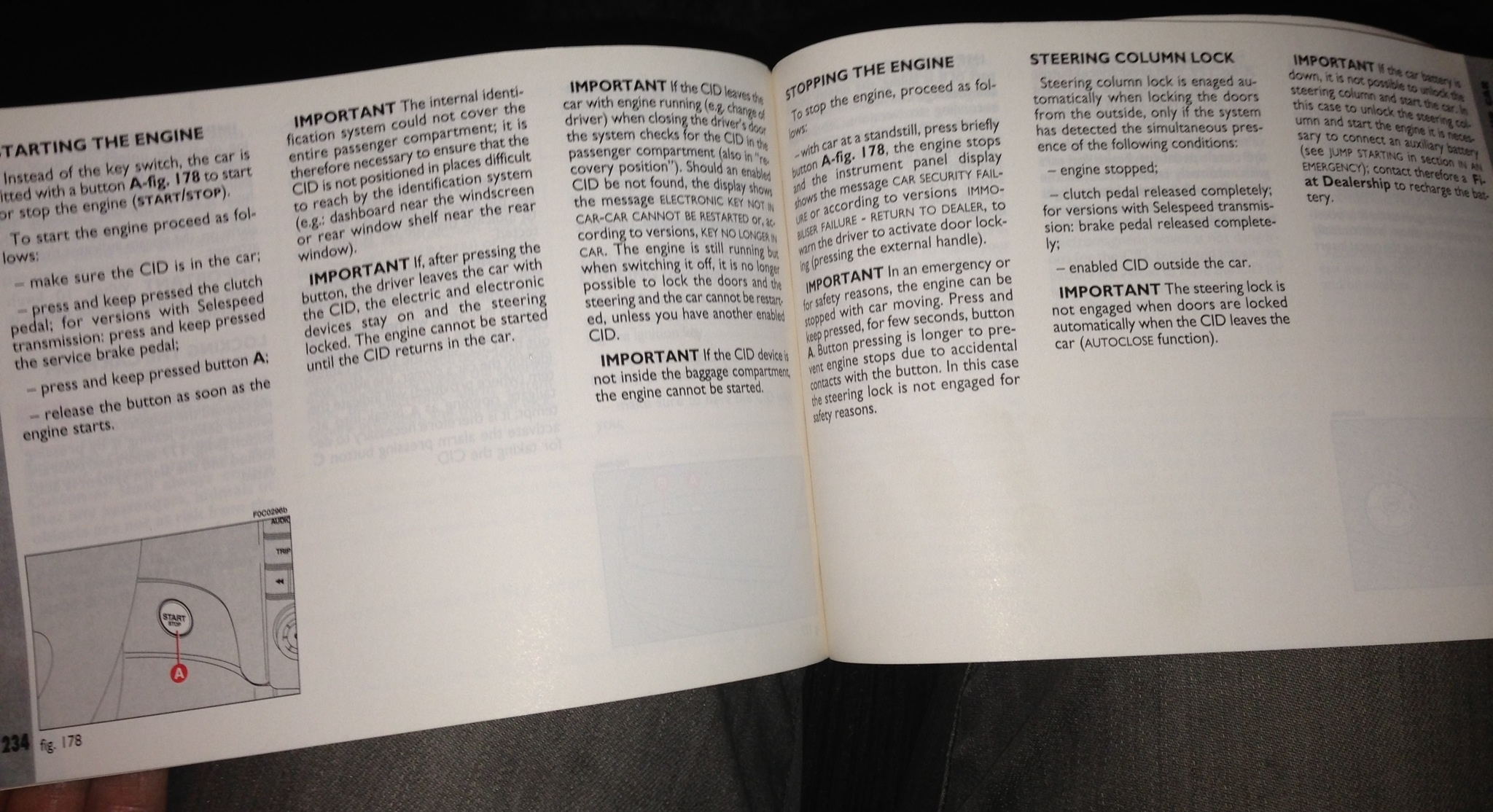

I came across this gem of information in the handbook just now:
"To stop the engine... press briefly button A [the Start-Stop button], the engine stops and the instrument panel display shows the message CAR SECURITY FAILURE or according to versions IMMOBILISER FAILURE - RETURN TO DEALER, to warn the driver to activate door locking (pressing the external handle)."
Now I don't know what you think, but I reckon neither of those messages is quite appropriate for the routine task of switching off the engine and getting out of the car... :rolleyes:
-Alex

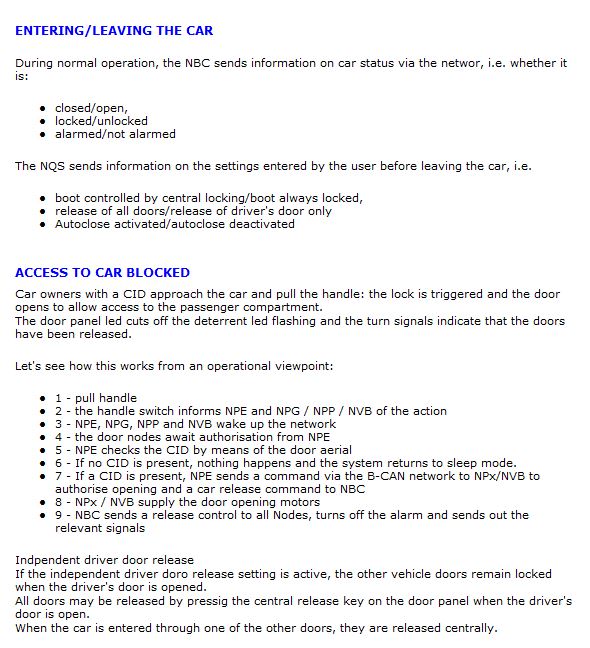

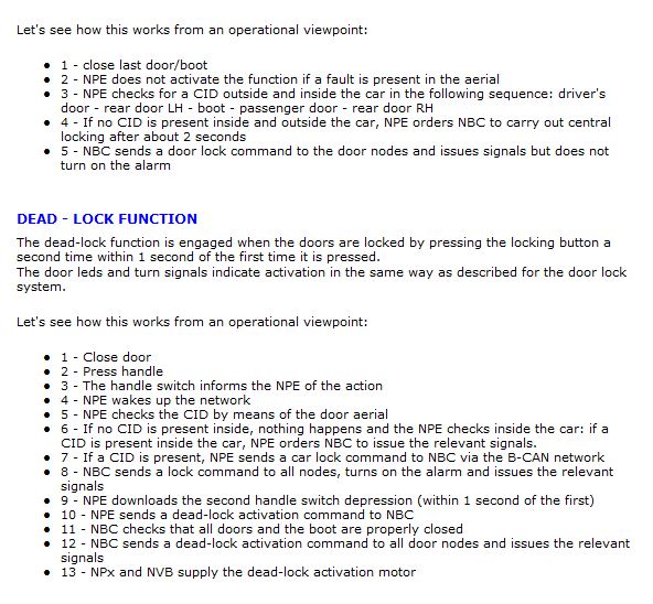

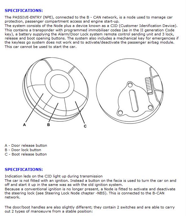

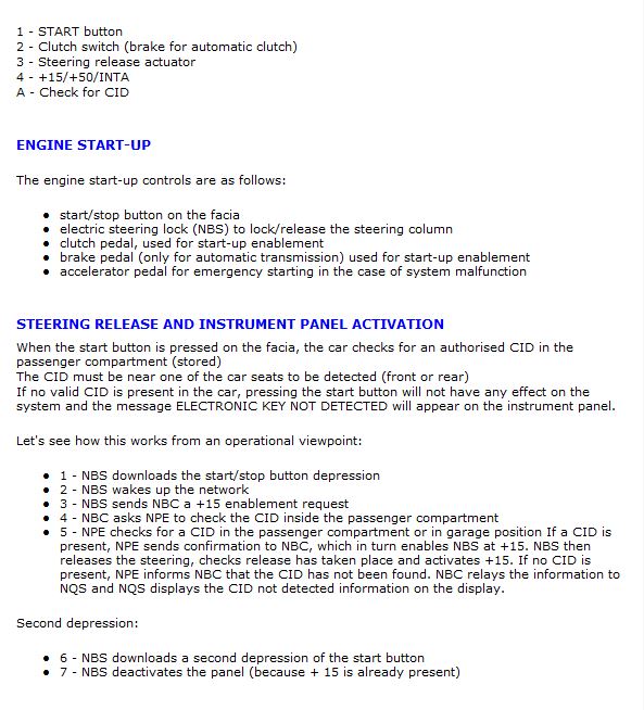

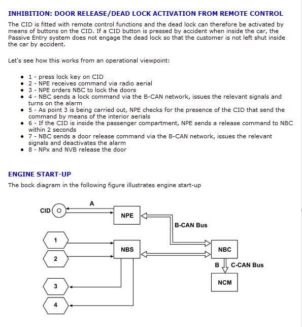

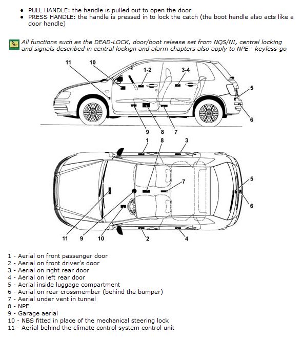

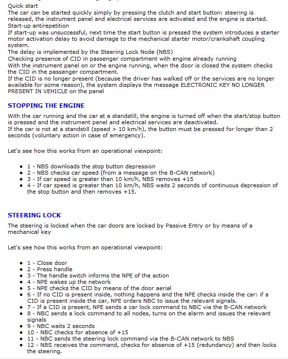

Can't say I've ever been interested in the EasyGo system, but for anyone that is, @AlexGS ;) the eLEARN description of it is below.
It's an orgy of technology isn't it... with TLAs in abundance, terms like 'wake up the network' and 'download'... and did anyone think, "Mmmm, we really need eight aerials to detect the CID... like, one on the rear crossmember as well as the luggage compartment, in case someone hides it under the spare wheel."
-Alex
I suspect that the aerial on the rear crossmember is to detect the approach of the CID from the rear of the car to enable unlocking.
It says in the description that the car can't be locked if the CID has been left in the boot, so I suspect that the aerial in the boot is to detect whether the CID is in there or not.
Seems as though the original system was designed, then they thought about all the possible problems that could occur and added individual components to combat those problems.
