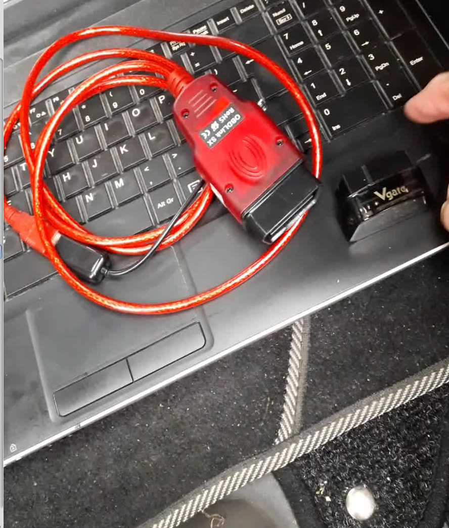

Gendan is a distributor for both mes and USB dongle .
For Bluetooth I use a vgate icar pro from ebay £25 they work, cheap £10 ones do not.
To use other ecus you may need various coloured adapters. A yellow adapter is sufficient for can based Ducatos.
I use a win10 multiecuscan with both obdsx USB dongle and vgate..
Alfaobd Samsung j6 phone a8 or tabA tablet and vgate or obdsx and a USB convertor cable. ie this can be achieved a number of ways.
Generic ones will not do many of the 2 way applications eg turning lights or equipment on to show they are under control, these 2 are the only diy product that can reset the oil degradation counter. They can interogate the systems in depth eg give you the software version you are running.

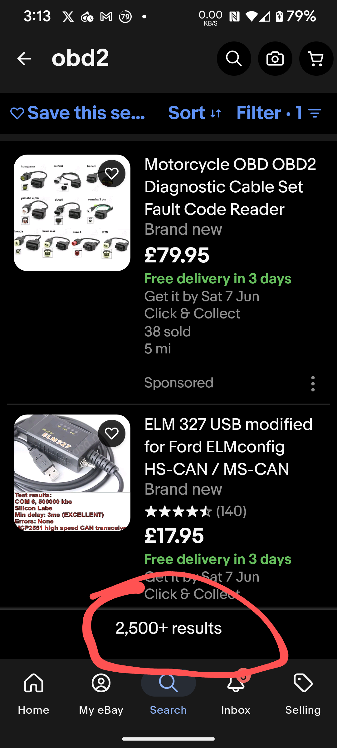

As an update I have since aquired a cheap usb interface from Ebay. The key point is for the Ebay/ other description to include the words "suitable for multiecuscan". I include a photo of the advert i used and the device that actually arrived. Note the colour and wording difference. Did it work for less than £15 : yes it does. I ran a series of tests including datasaving using one of my templates, resetting the oil degradation algorithym and 2 way coms turning warning lights on and off. I just pluged into my van and Laptop with a working copy of MES, so I did not use the supplied driver CD.
I have only mentioned the 3 obd readers I use, there are many others suitable. If you have found good alternatives (ones that work) please add them in the discussion section. I can only recommend purchase from the Multiecuscan distributor Gendan from EBAY or Amazon it must be Caveat emptor (let the buyer beware).
