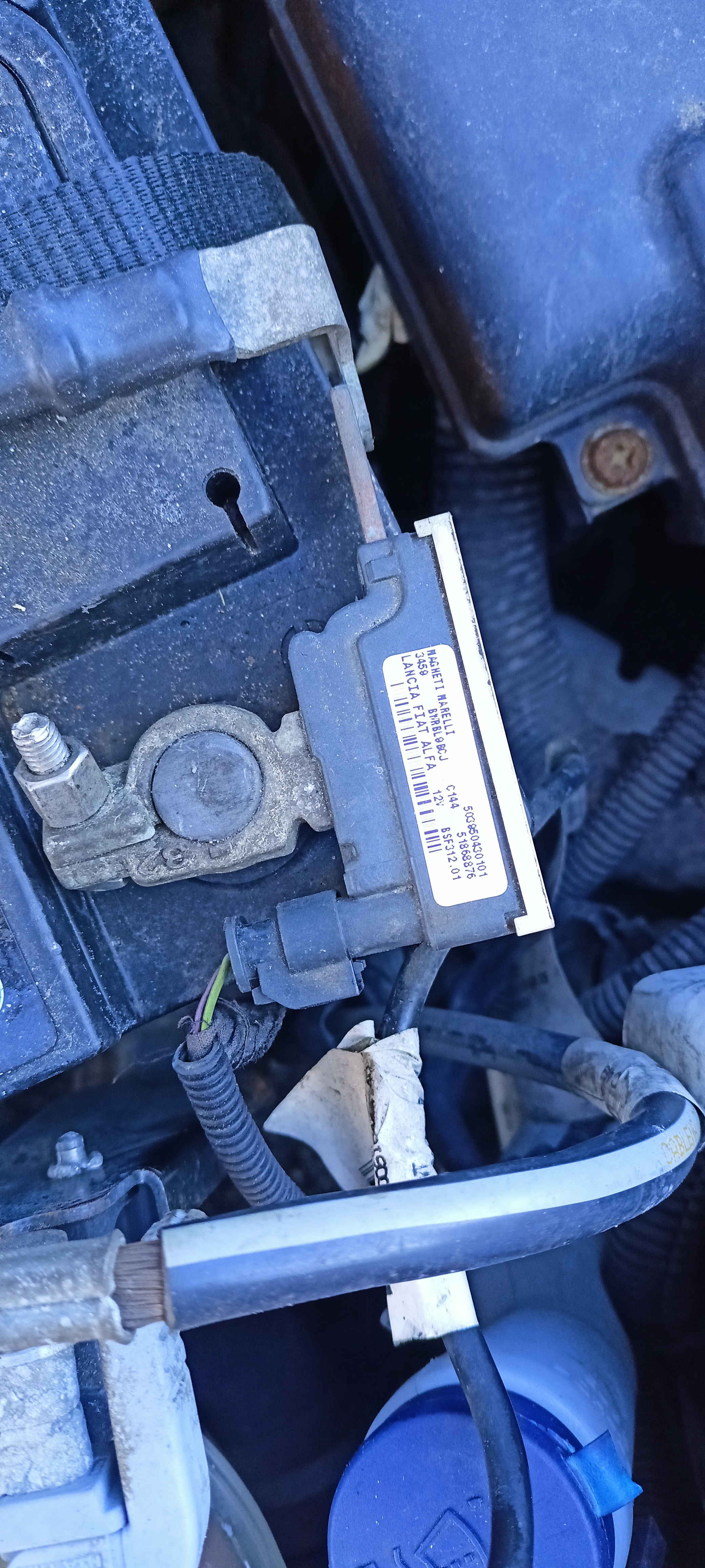

There is some kind of sensor with two wires from it located on my EVO's negative battery terminal. What does it do?
Thanks. So why does it only have two wires? Is there a signal going through them? It looked just like positive and negative.
Can't say for sure, But I would guess one is live, probably 3.3V or 5V DC derived from the ECU to power the processor inside the IBS, the other I believe is a LIN bus signal for the engine ECU to process.
I see now, so its a kind of computer signal. My stop start doesn't work, but that could be for a number of different reasons, the battery itself never fails.
Yes, I had the same problem with S/S not working. But mine wouldn't charge, battery kept going flat. S/S disabled itself.
I replaced Earth strap, then battery, then Alternator. Replaced the IBS just because it was part of the charging loop (and was cheap to replace), and it all started working.
I even measured the LIN bus signal at the alternator, which is also intelligent, and was ok, and if I disconnected the plug with the two wires on the IBS, the battery would charge.

Looking at the photo of the post 1, I'd also clean the terminals.
