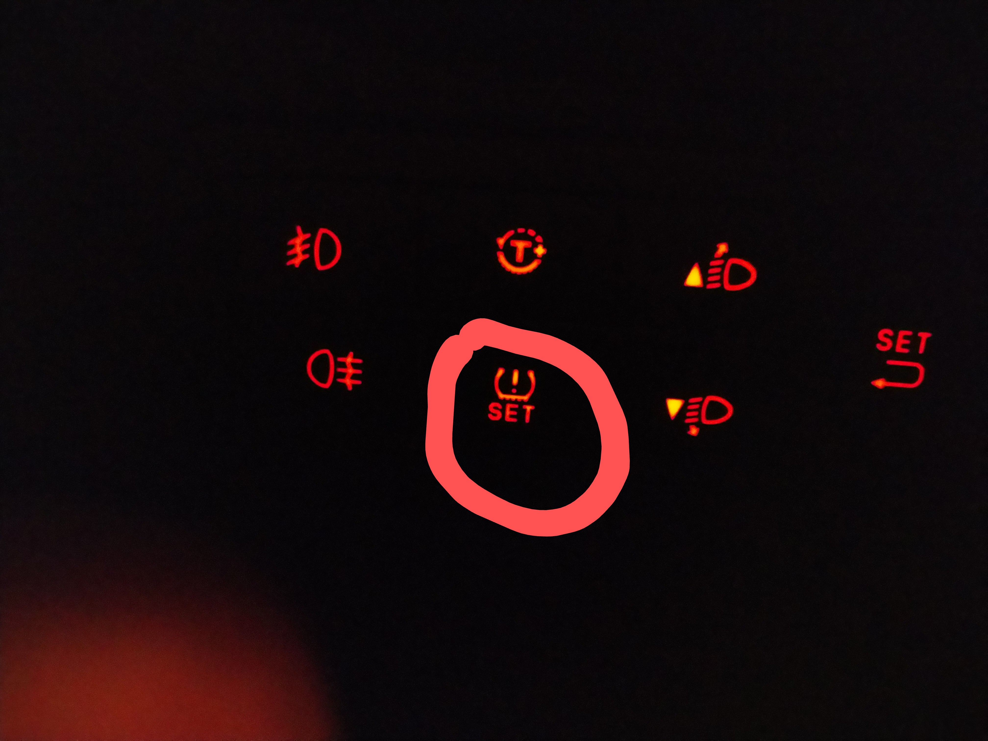

Single press does nothings. Keep pressing for a few seconds return message to dashboard "reset memory". Any clue?
This is from a 2016 fiat qubo diesel
There will be a pressure sensor transmitter inside each of the 4 tyres. When one of the sensors senses a low tyre pressure it will trigger the low pressure warning light on the dashboard. To set the system, you need to pump up all 4 tyres to the correct pressure, then press the set button for a few seconds. The process will be explained in the owner's handbook.
Thanks for your answer.
In the manual book this button shown as blank so no information about it.
I've seen similar system but the pressure transmitter was like tyre valve cover. So for this car the transmitter is "inside" each tyre?
I will check right away. I will reduce the pressure to see if any warning appear.

I cannot find any option about "tyre reset".
Also I reduce the pressure of one tyre (almost flat) but no warning message. It should be a handy option because the car has no spare tyre or repair tools. I will ask also to dealer. Thanks by the way. Any other advices will be help full.

The only control option I have is to press the button for a few seconds and appear the message "memory reset". I already reduce the pressure in one tyre almost flat and no message comes. Also make a short drive but still warning.
Right now I have a can bus problem ( odometer flashing). Possible this problem prevent this "low tyre pressure" function?
Many new tyre pressure warning systems use the abs sensors to work out if a tyre is low. A flat tyre will technically rotate faster than a non flat tyre. So you can need to cover quite some distance and the car may need to observe the change before you get the warning, and they are not designed for you to let the tyre down then drive it about a bit to test it.
Rest assured they do work in the real world and as long as you have no warning lights you don’t need to worry about the button just leave it alone
So it seems that I have to test it a little more.

Yesterday I make a normal small trip (100 km) with normal tyre pressure and low "tyre pressure" indication appear. I stop the car and check around but nothing strange found.
Maybe from previous test? Anyway i make a reset and the indication disappear.
