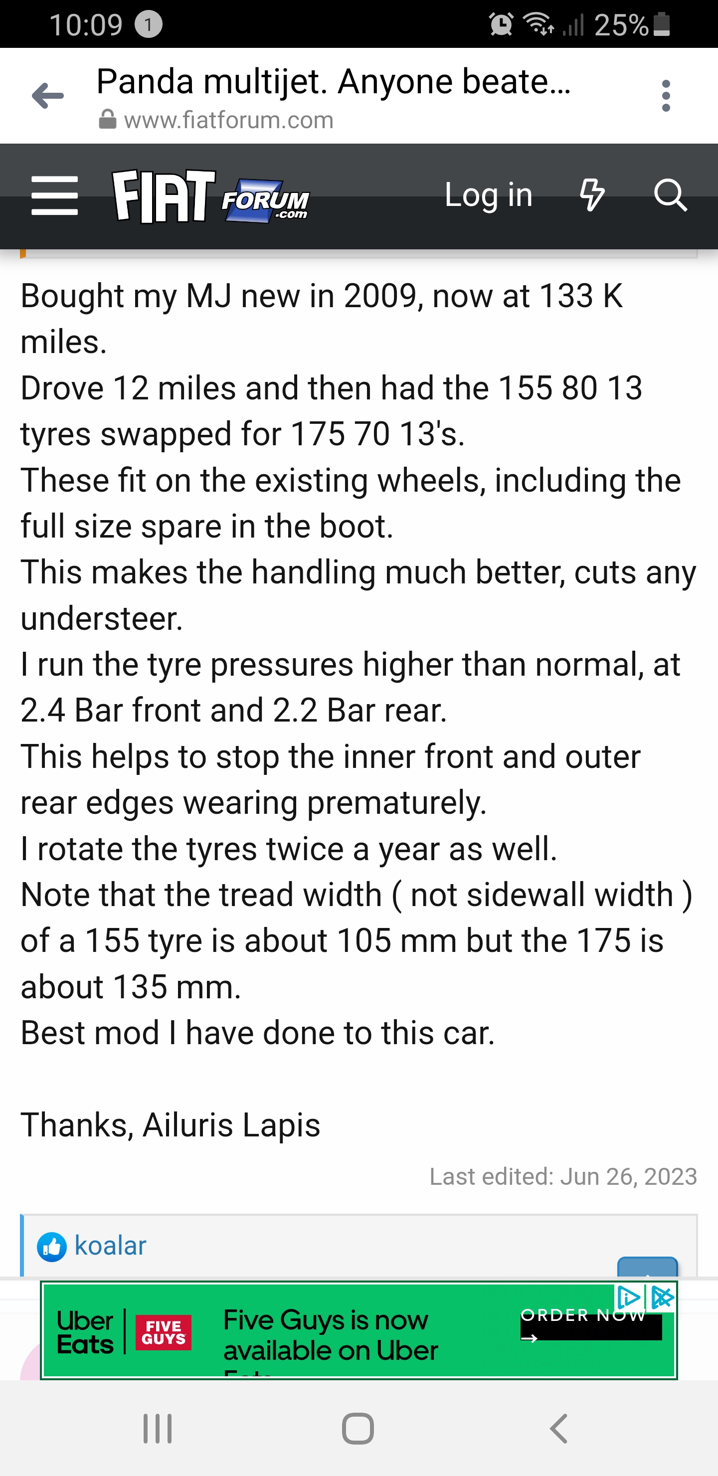

I found this post a few months ago and can't find it on here now. Can anyone help me as I want to change my tyres for the same as this chaps post.
Also if I did would I have any problems at mot time.

When I bought the Panda new in 2009 the choice was 155 80 13's on steels or 175 65 14's on alloys for £450.00 extra.
So I stuck with the 13 inch steels, but with 12 miles on the clock swapped all the tyres to 175 70 13 including the full size spare.
These fit on the existing rims, are not over sized for the rims or car as 175's were an option.
If you look at the car you would not notice anything about the tyres that look out of place. Want a Photo?
Never even been mentioned at any MOT or service since new.
I have run 175 70 13 summer tyres, winter tyres and am now just on all season tyres all year round.
With Panda's front tyres can wear the inside edge quicker and the rears the outside edge quicker.
The tyres / car runs better with a higher pressure which also cuts the edge wear down a lot.
I rotate the tyres twice a year both side to side and / or front to back.
I do check the alignment twice a year when I rotate the tyres.
I also run a little toe in, just 2 minutes total.
Front wishbones were replaced at 8 years / 99 k miles.
Rear shock absorber bushes were replaced with Powerflex polybush ones.
worse in the wet and especially in slippery conditions
The car has a lot less understeer than a Panda running 155's all round.
The car has more grip than I have the £a$$s to drive it at, wet or dry.
Good tyres also help here.
I have a 1.3 Multijet Diesel and MPG at last fill up in August this year was 68.1.
I live in North Dorset which is a rural area and the car is now over 134K miles.
There were people on this forum back in 2009 complaining of understeer on a Diesel with 155's on the car.
Best mod I have done to the car.
Thanks. Ailurus Lapis
