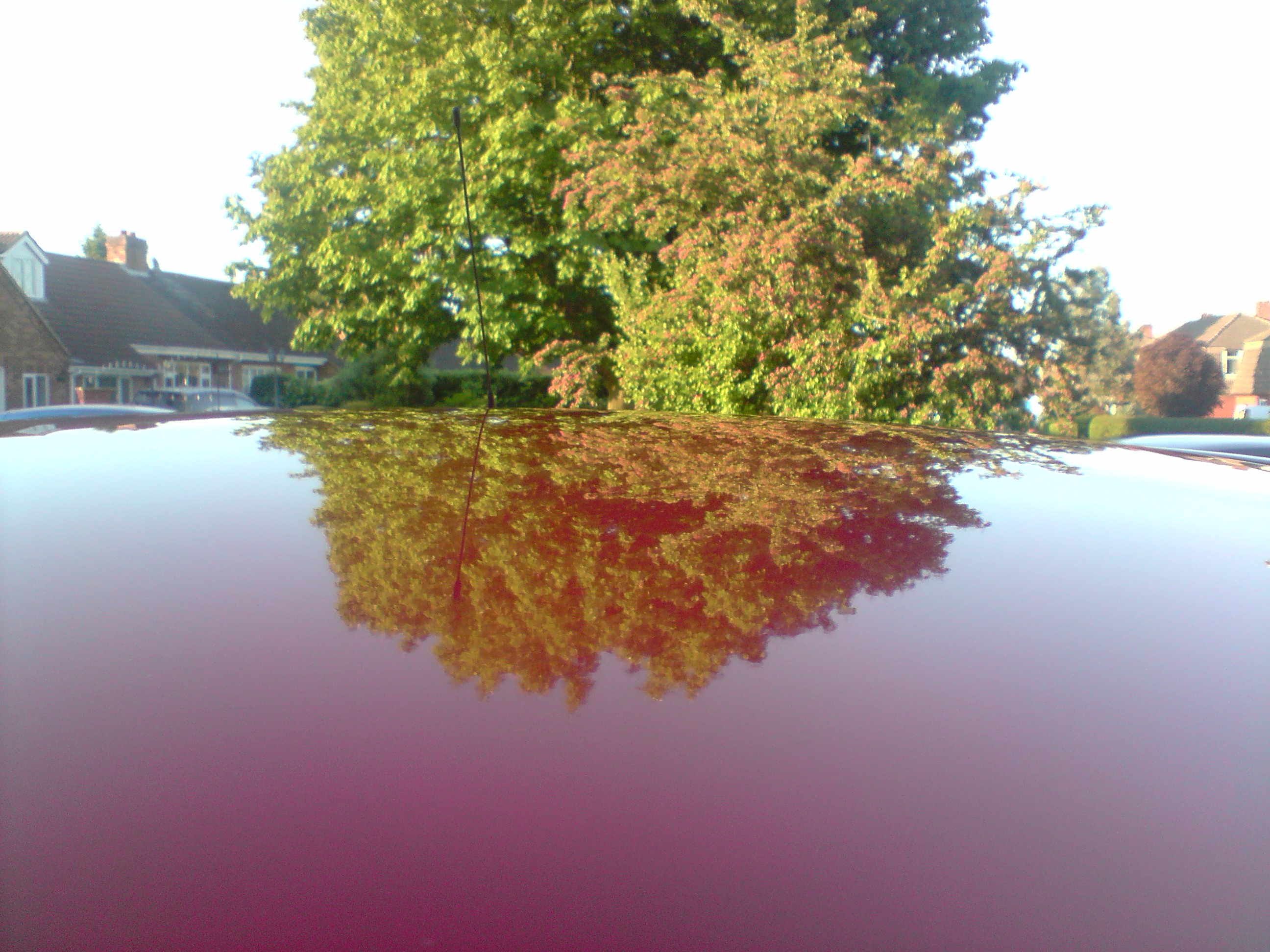

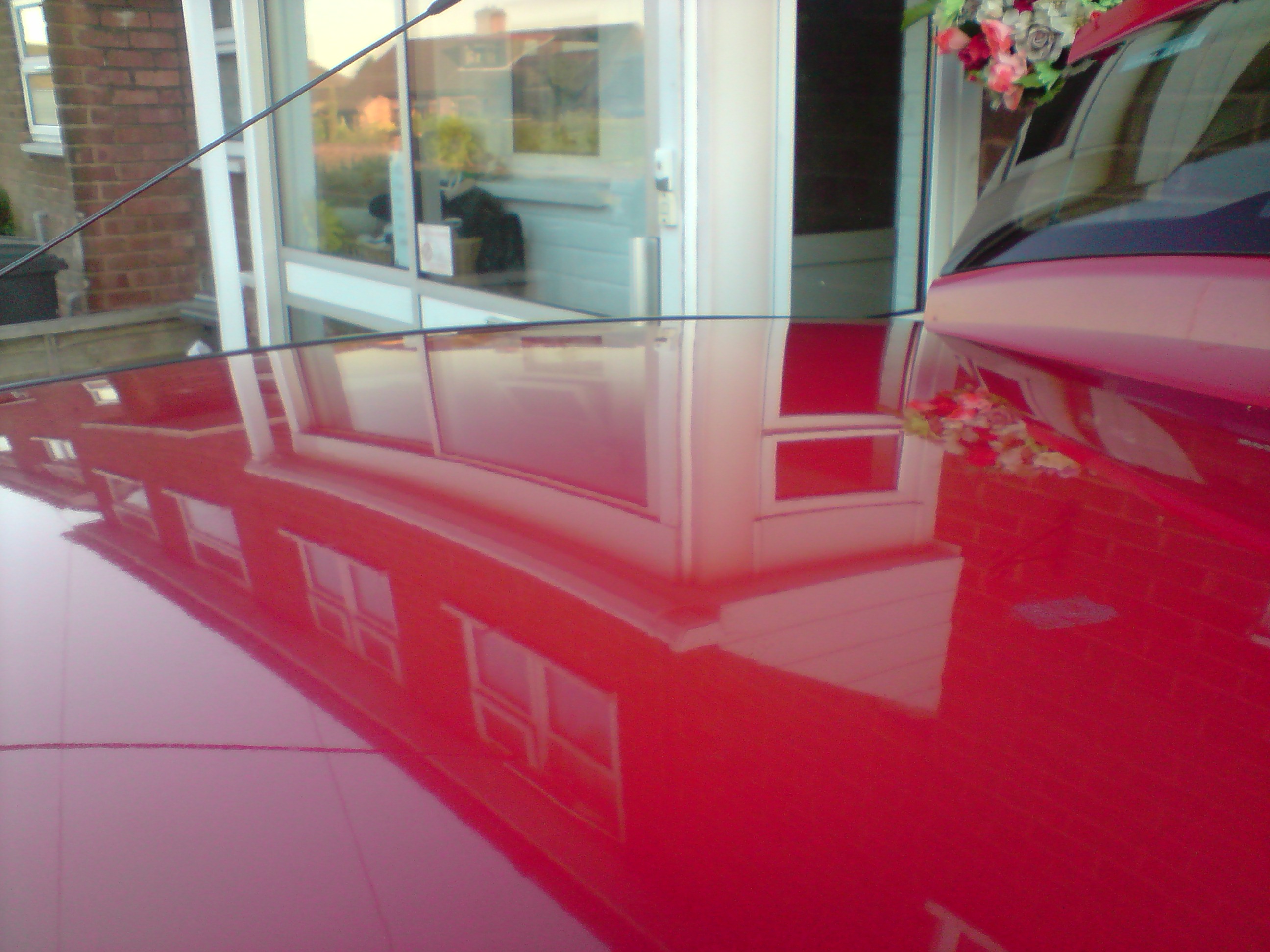

My roof felt like sandpaper, had no shine to it or anything, so I bought a Meguiars kit off ebay.
Here is the result:
Here is the result:
