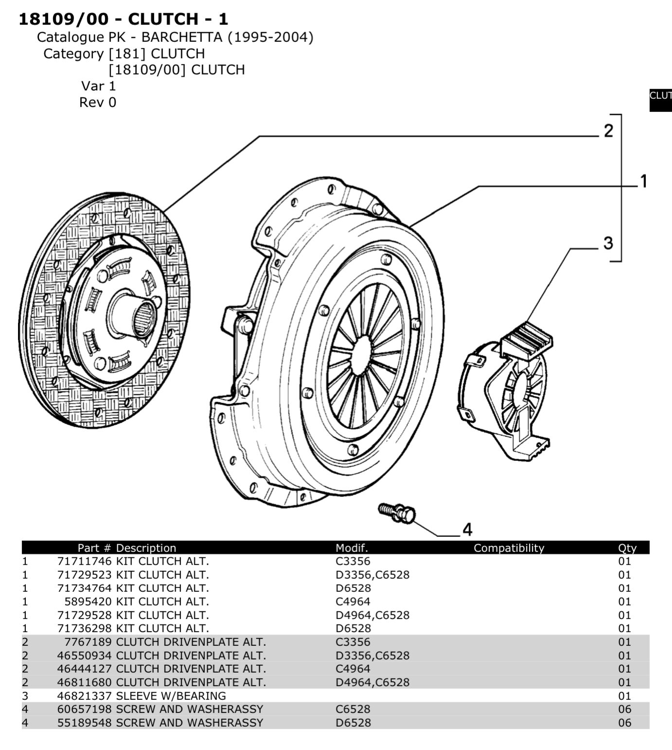

I`m going to change muy old gearbox and I'll change the clutch. Is 215mm 20 tooth?. Thanks.
I can’t be 100% certain on your question (or why you posted it twice), but it is a good idea to replace the clutch if you already have the gearbox off.
Not sure why you need to replace the gearbox though!
If you question is regarding which clutch plate you need, there are different part numbers depending on the age/type of your b
Personally, I would do the whole kit and not just the plate
thanks for the answer, the speedo gear fell into the gearbox and could not put the second gear, disassembling a gearbox is expensive, more than putting a used one. There are two types of clutch disc 215 and 220mm, of there is my doubt about the diameter of the disc of the barchetta of the 95 seems to be that it is the 215mm but I am not sure, I will find out when we disassemble the gearbox, I asked if someone had replaced the clutch disc of a 95 barchetta. Thank you
