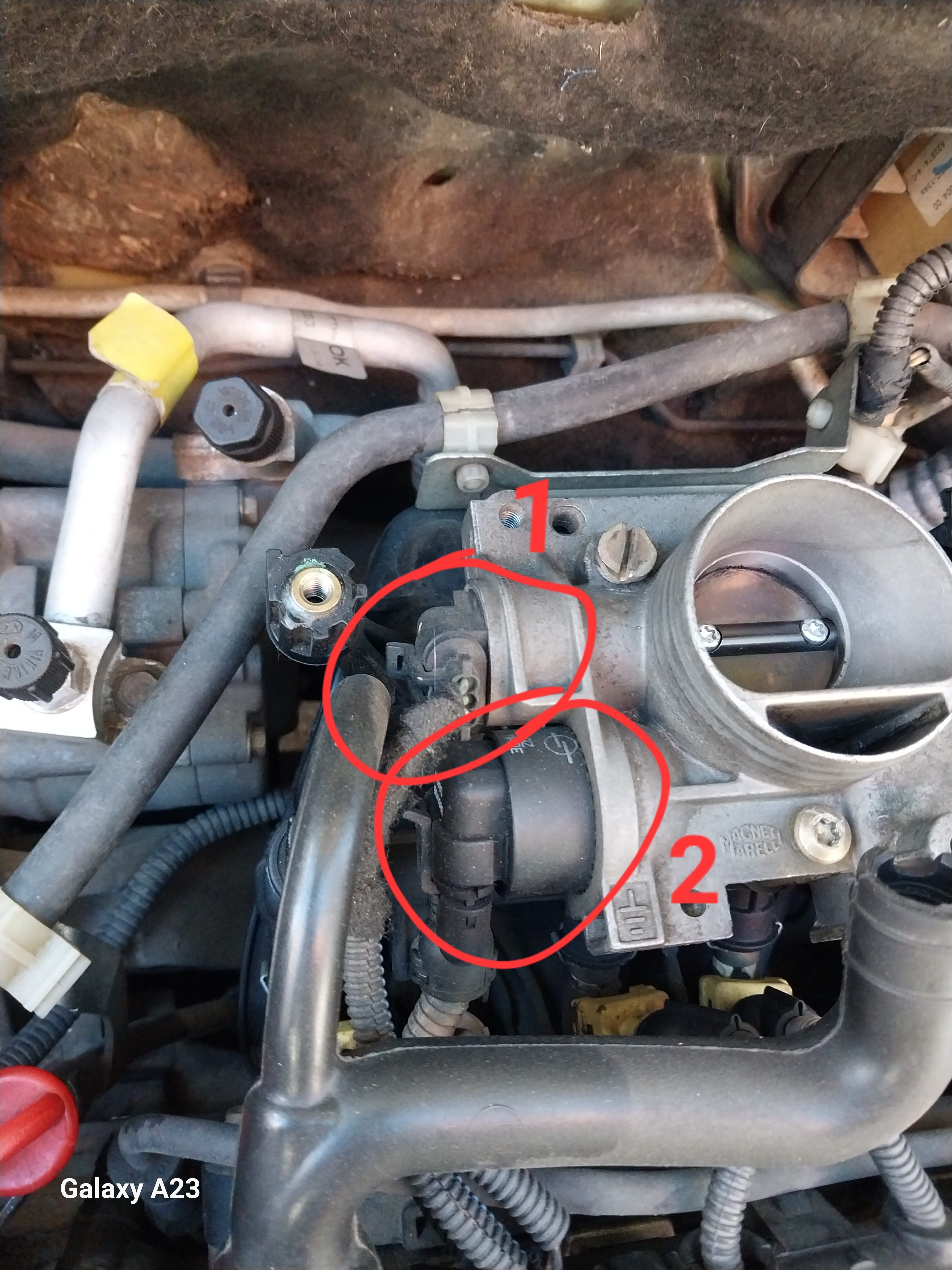

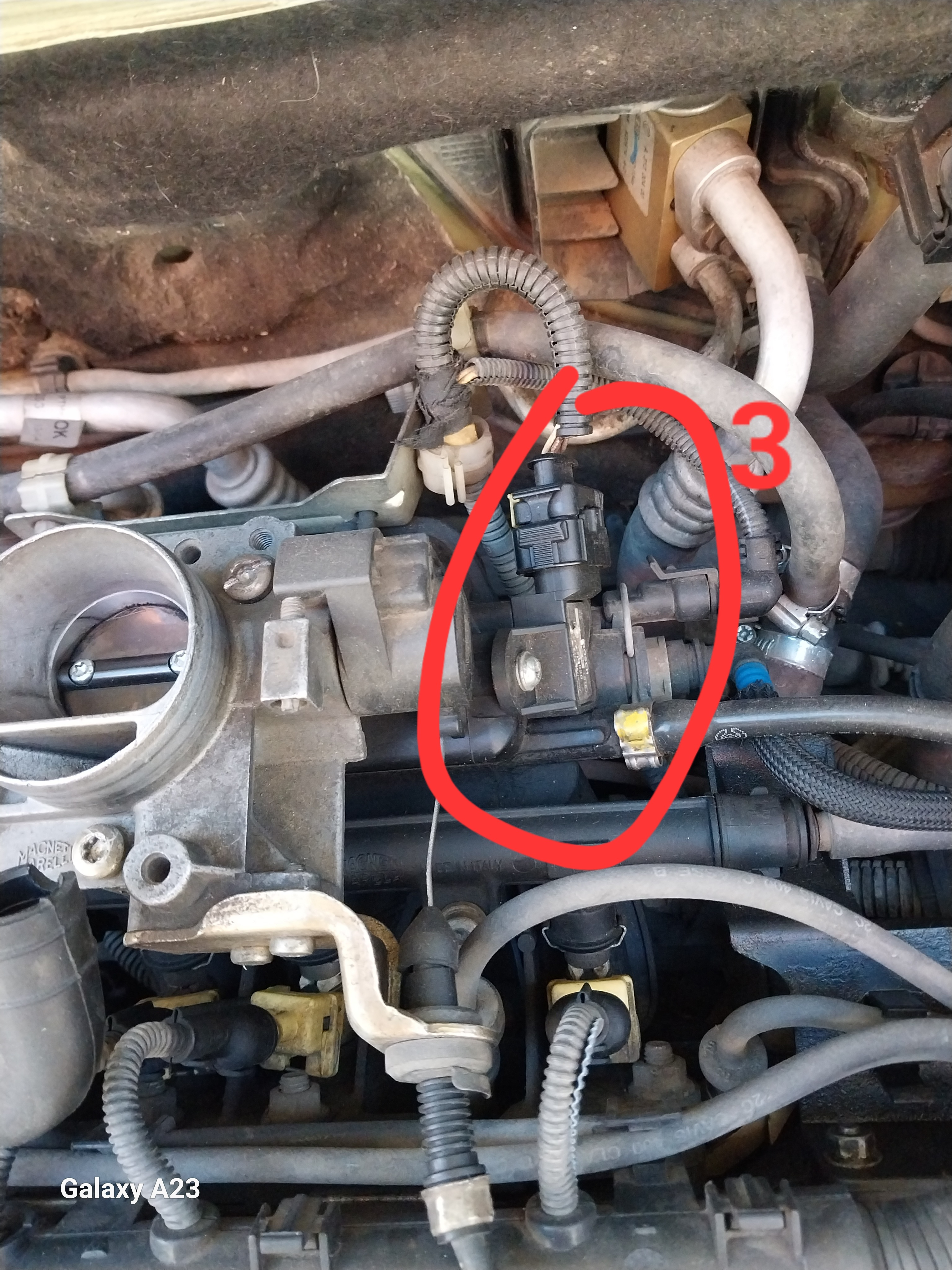

My vehicle gives gas automatically. Sometimes while idling and sometimes as soon as I pressed the clutch pedal... I realized that I needed to clean the throttle and oxygen sensor. But I don't recognize any of the sensors mounted on the throttle! I numbered them 1 - 2 - 3, can you please tell me which sensors these are? (I will clean the throttle body with a special cleaning spray that is alcoholic and volatile).

Thanks. So which one needs to be cleaned? (I will unscrew the throttle body and separate it).
MAP one screw you can leave the electrical connect alone, you sometimes get a drop of oil on the tip which messes with its readings, keep it pointing downward so no cleaning fluid goes inside
Idle control valve. Underside of throttle body It may have a spring loaded plastic cover that you have to push open with a small
I doubt it's either
Sounds more like the car about to stall, the ECU catches it making the revs jump
The most common cause would be spark plugs
Or the evap solenoid not closing, normally after over filling the car
Or melted inlet manifold after an overheating event
I doubt it's either
