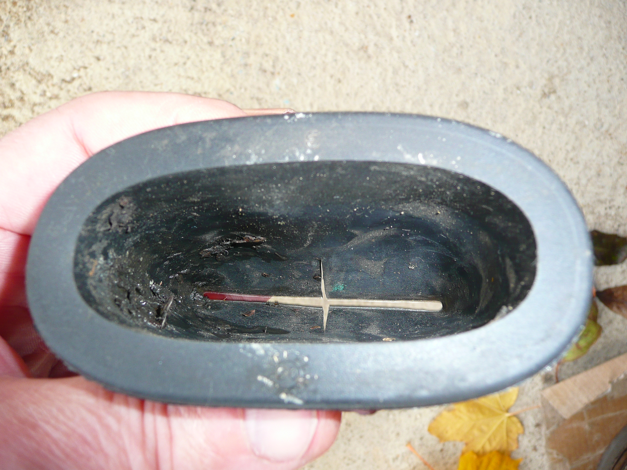

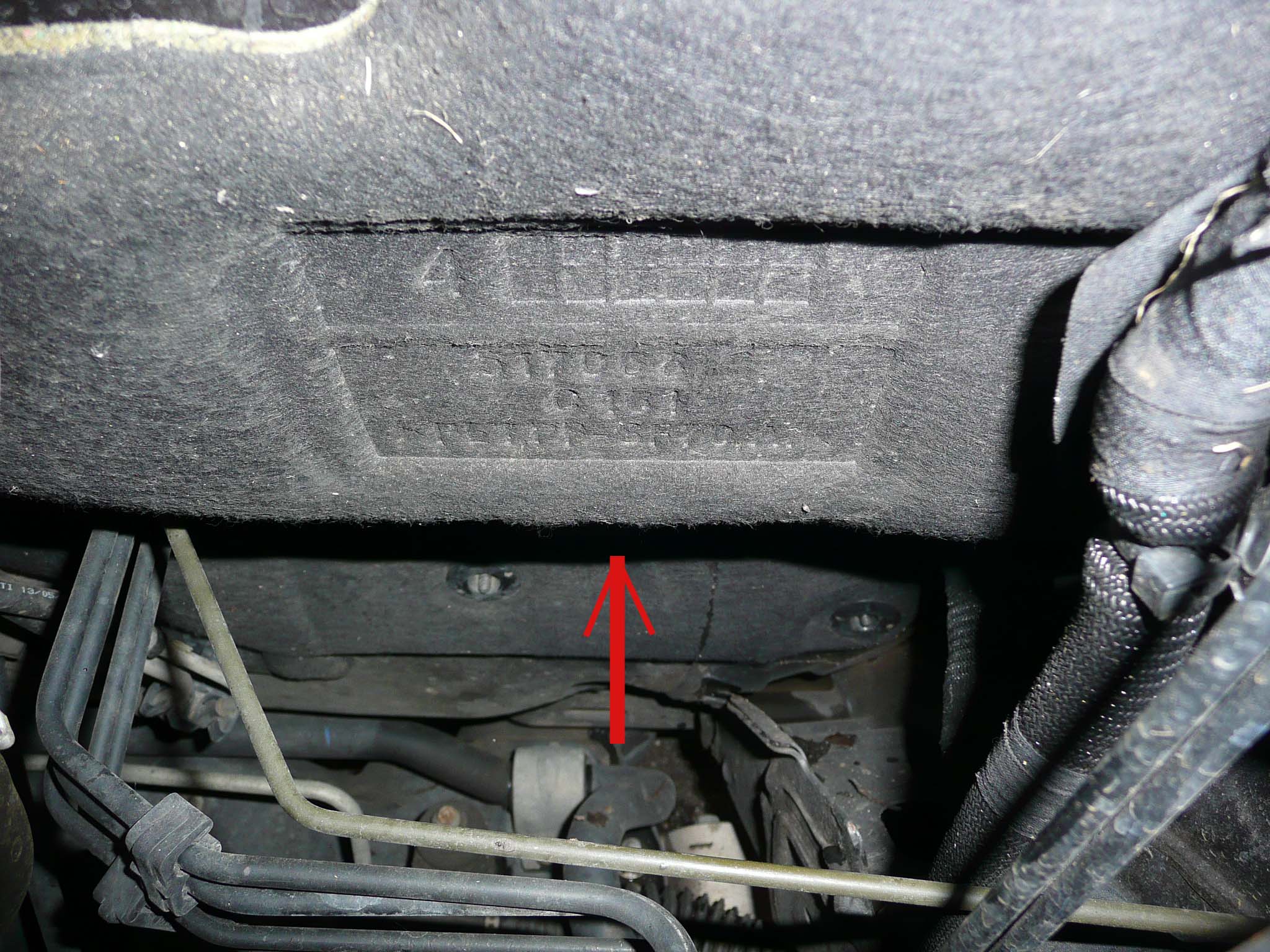

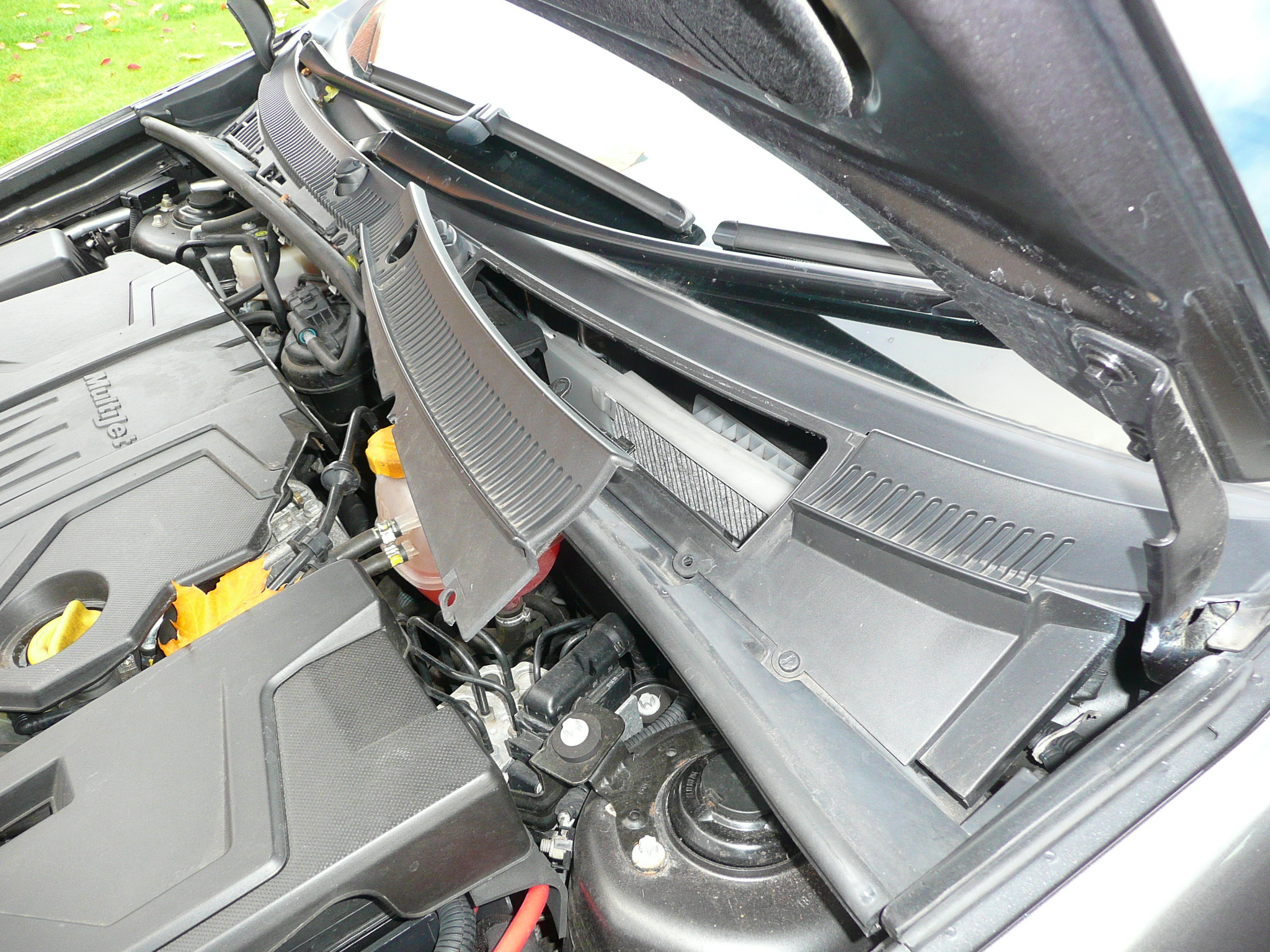

Finally sorted it. There is a rubber drain in the engine bulkhead (passenger side) which is about three inches long and is located down about 9 inches from the windscreen lip. This had silted up (no leaves just fine dirt). The rain water then filled the bulkhead area to about two inches deep and got into the passenger compartment thru' a mesh filter (pollen?) and then ran down inside under the carpet.

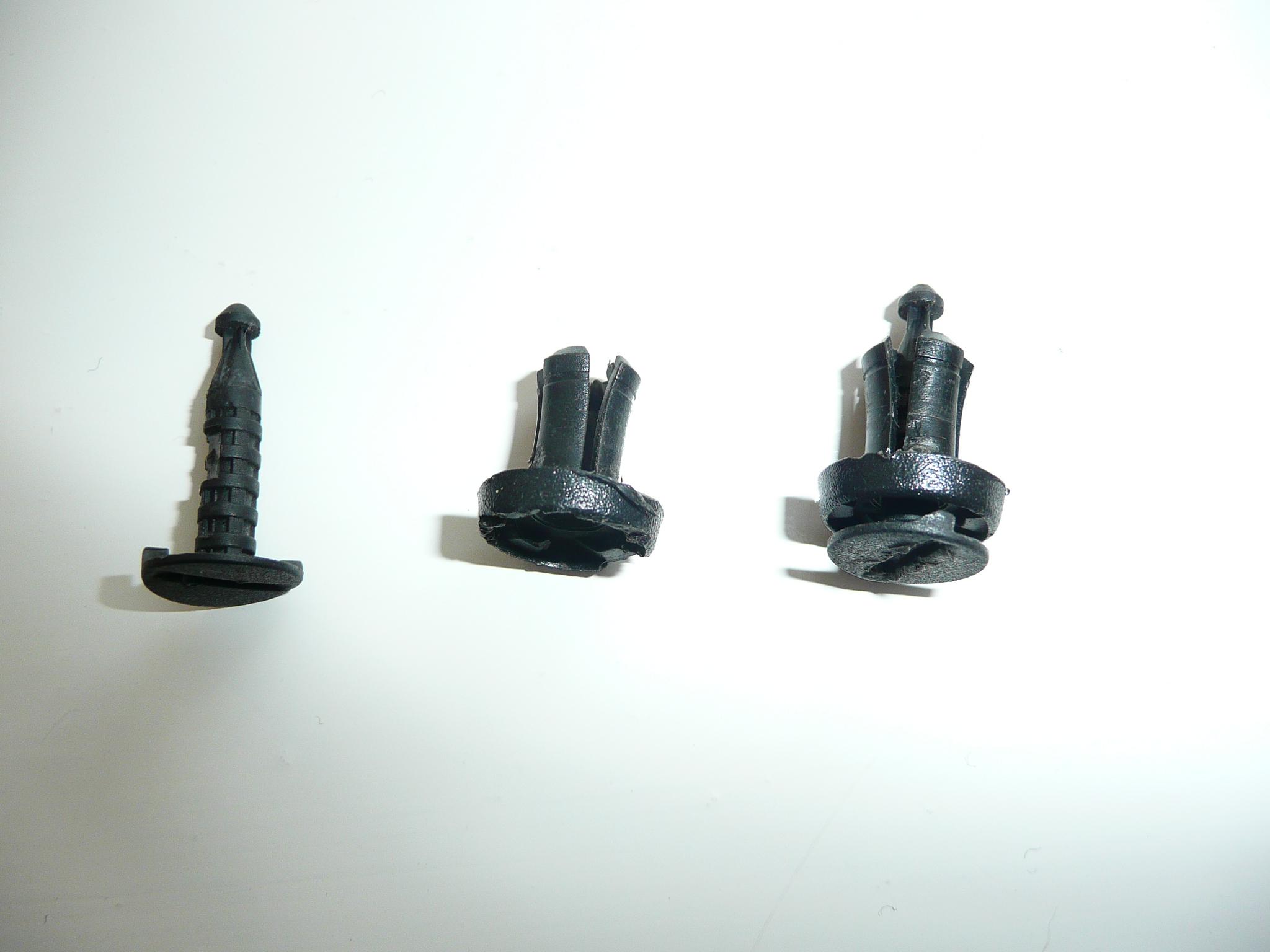

Took me about 30 mins to work out how to get the windscreen grill 'screws' out! Note, they aren't screws.
So the lesson is - make sure it is clear! Do this by pushing a finger up inside from the engine bay - no need to remove any panels! Hopefully the pics make sense, rubber drain is removed.

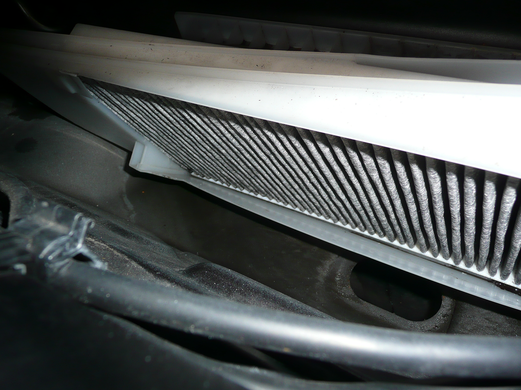

Time to change my pollen filter, found this thread. I guess it was never done by the previous owner, and the dash display has today said it needs changing (wondered what the musty smell was).
What is the best way to get those funny expanding screw things out? And put them back? Can they be re-used or are they a chuck-away thing?

As for getting the fasteners off, put a small (electricians-type) screwdriver in the join between the head and the body, then turn the head. once it starts to lift, pull the head all the way up and twist as required.

If you look at my top LH pic you will see I haven't removed all the 'screws' but left the innermost one in. This acts as a swivel. The panel then clips back and doesn't require the screws putting back. It allows quick access for the next time.

Ta for the advice you two. I'll refit if possible, if not then see if I can get some or make do with something else (a proper screw?)

New pollen filter installed. The old one was filthy, so well worth doing. Also had a wipe around the area with disinfectant, so all nice and fresh now.
I found a wood chisel was perfect for levering the screw things out. Gently persuade sharp end between head and washer, then twist to lift it out. They both came out whole, and clipped back in. A bit of a sloppy fit, but not going to fall out.
