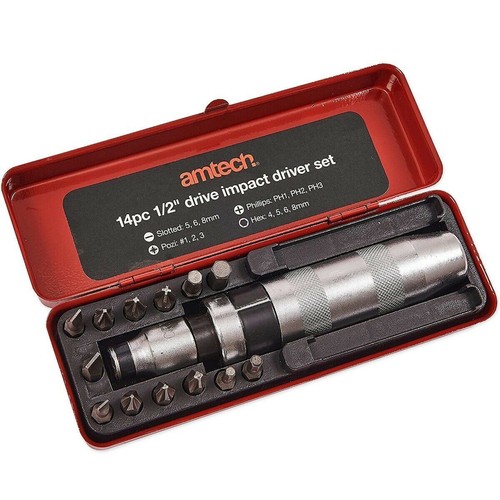

Mine seem to have always come off fine. Same car aswel. 2005 punto, 4 door, 1.2 8v. Soak them in loads of WD-40 and just hope for the best. First time I took mine off though I did use a manual impact socket
This is the tool I used. That’s just a cheap copy that I could find quickly. definitely recommend investing in one of them
