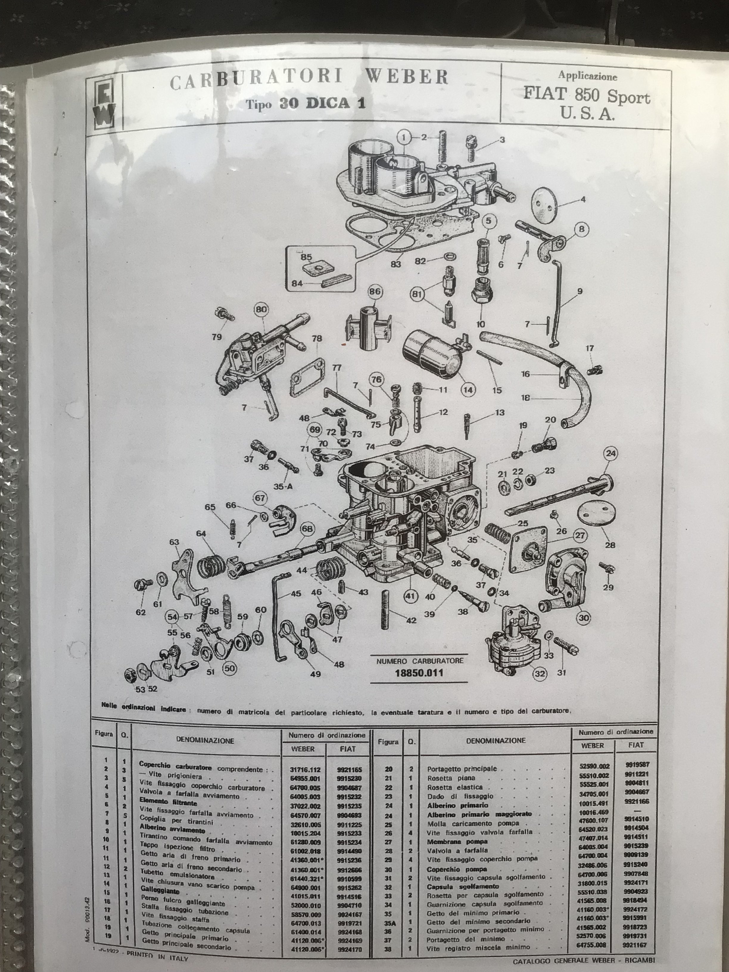

Hi Stu, I am guessing you have the US spec 30 DICA 1. I have just rebuilt a European spec 30 DIC 11 so have my carb folder handy. Jet info is on second page. IMG_4505.jpegIMG_4506.jpeg
Hi Stu, I am guessing you have the US spec 30 DICA 1. I have just rebuilt a European spec 30 DIC 11 so have my carb folder handy. Jet info is on second page.View attachment 427951View attachment 427952
Thank you Toshi. I do have this on PDF, translated to English, however, it does not indicate what side the larger size jets should be located. My thinking is that the larger size jets would be for the secondary chamber and smaller size jets on the primary side. just trying to get clerificaton before going any further. I would sure like to start this old machine very soon. Again, I appreciate tthe help.
Does, primario and secondario in the jet sizes on the right of the second photo indicate first and second chokes?
I see some primary are larger , that may be on air bleed side.
The carburettor is a progressive twin choke therefore the primary choke is the one that opens first then part throttle the secondary comes into action. So the way I read it the larger jets are on the primary.
Not speaking Italian, but the way I read it was slightly different, bigger main fuel jets on secondary for performance, with primary set for economy.
However the primary air jets if I am reading it correctly appear to be bigger.
Perhaps an Italian speaker can translate?
This is jet sizes on Fiat 131 1975-82 I don't want to confuse you with the bigger engines (1.3-2litre) etc. but it may be possible to understand where bigger and smaller jets normally sit in a progressive twin choke carb.
