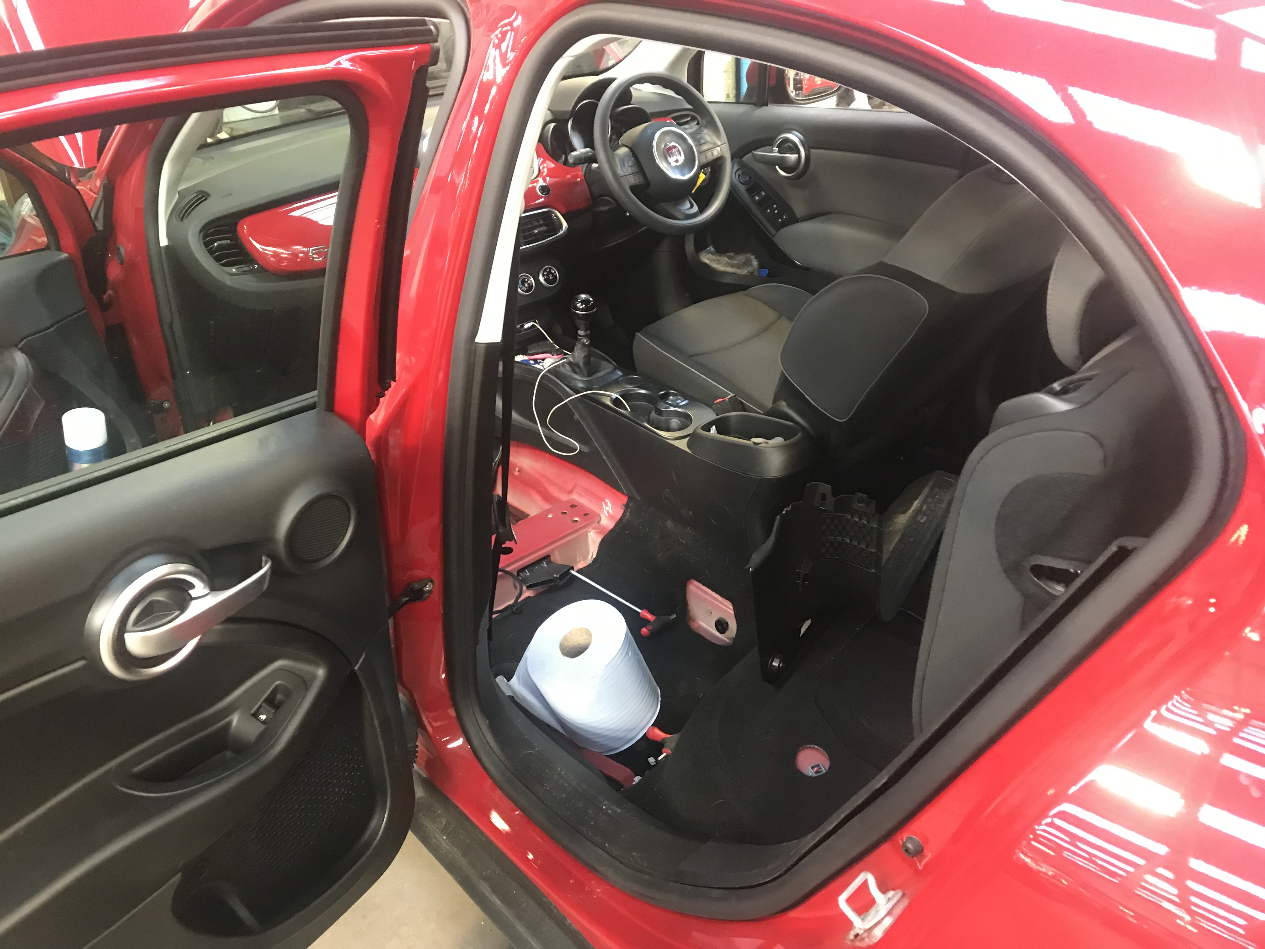

One we had in recently for this problem

When the customer come in, her washers were empty, I filled it with water and the the rear washer still worked, however you could see the water gush in from the plastic trim where it meets the carpet under the rear bench.
The Fiat mastertech told me it’s common that they fracture on the 500x
Was all fixed yesterday - they said that the connector for the washer fluid had split around the read passenger door sill.
