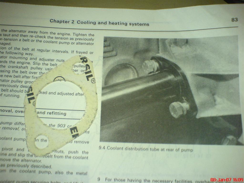

yes unfortunatly it is a bad leak, I fitted a brand new waterpump when i changed the cambelt and head gasket, I have a feeling its the coolant distribution tube which connects to the rear of the waterpump water pump see the attached picture,
I'm going to take it for a MOT as there is a station down the road and when its on a ramp i'm going have a look to find out exactly where its coming from,
Aha - yes, that sounds likely to me, even without the picture (not attached) I can see it clearly :) That tube that runs across the back of the engine - rust is a huge problem... and it needs a new gasket each time, really...
Good luck with it, shouldn't take much to fix it once you do find the leak...
-Alex
I spent some time today investigating the leak and i found it! exactly where i thought it would be, went to my local fiat dealer and they had one in stock for £1.30 :)
its gonna be a ball ache changing it though which i aint lookin forward to.
