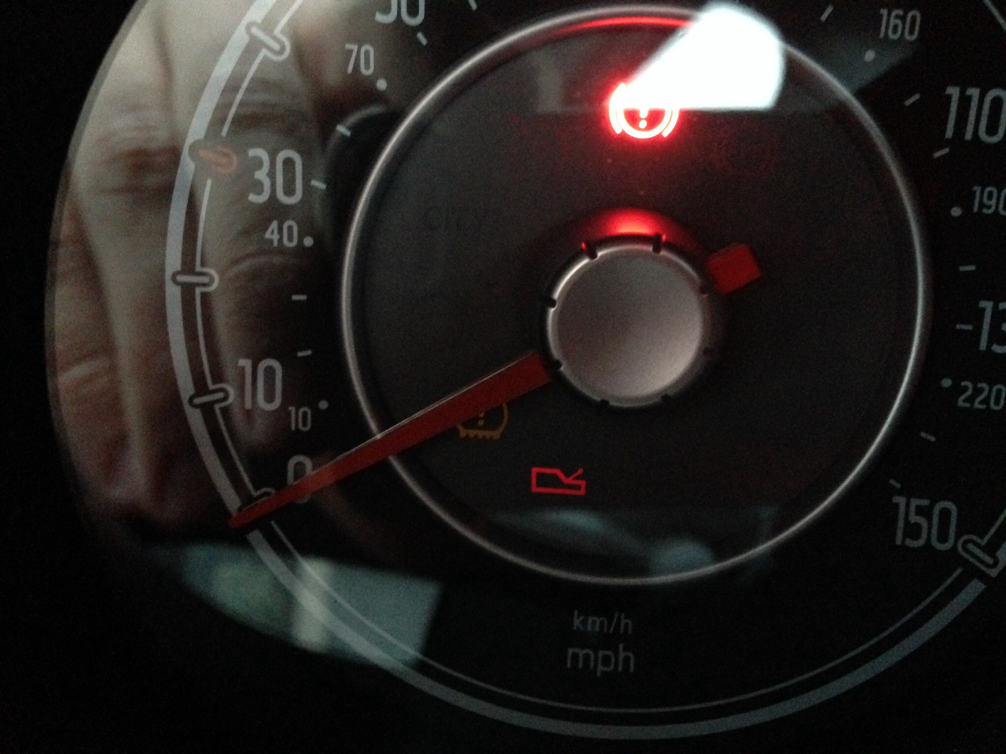

A couple of days ago I spotted these 2 lights come on on the dashboard of my 2013 Punto.
I realise the upper one of the 2 is the tyre pressure warning light, (which I have just put air in and it hasn't gone off), but what is the lower one indicating?

Hi,
All lights are described in manual... so RTFM :)
Are you happy with pressure indicator ? You was really low on pressure on one/more tires ?
I looked in the Warning Lights section a couple of times and couldn't find that symbol!
The pressures were hovering around 29/30 in each tyre, so I put the front ones up to 32, and rears to 30, but the light didn't go off. I'll see if it does when I go out again tomorrow, maybe it takes a short time to register
Heu I looked too and you are right... can't find this one too. So please excuse me for my remark :(
It can be your boot open ? It's hard understand this red light. Can you check this ?
Your right in the fact the amber one is a Tyre presser sensor. If you've put air in them and its still not gone off, safe to say the sensor is faulty.
However, the bottom red one is a Gear Box fault...
If it is an Automatic (Dual Logic) then it means that the gear box is faulty, please take to your dealer. Don't think the auto is an option in the UK
If its not an Automatic, it shouldn't have this bulb, so must be an error with the computer, would tie in with the tyre sensor.
Correct, generic transmission fault when fitted with the Dualogic gearbox, it is fitted on UK Dualogics also, I know this prom personal experience :(
OP does the car drive ok?
The car isn't an automatic, and everything seems fine, so it must just be some sort of error that it's showing up.
It did happen at the same time as the tyre pressure light came on, so maybe the "wires got crossed" somehow
