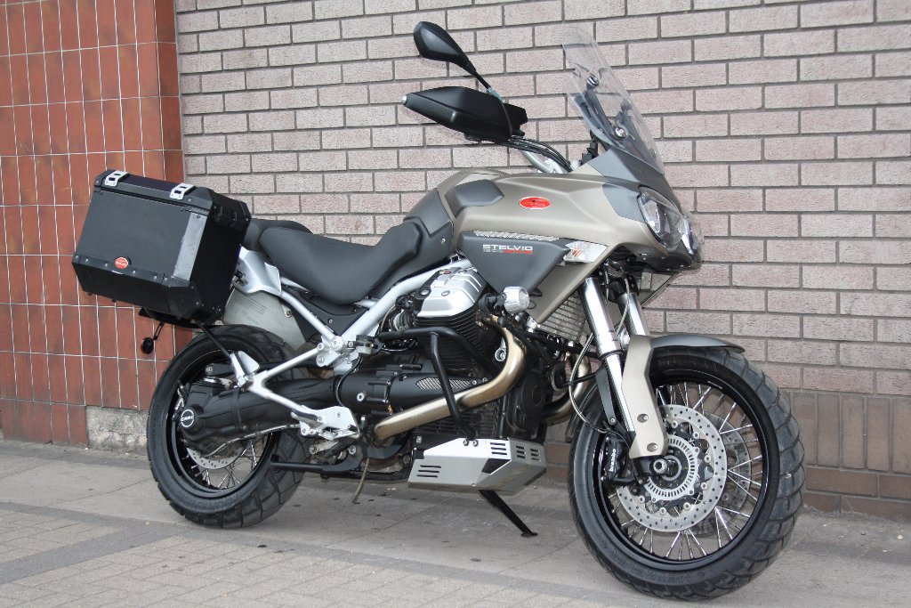

Main reason though is I got another Italian Toy . . .
Moto Guzzi 1200 Stelvio.
Rented one for three days in Italy last Sep, was so smitten I bought one when I got back!
