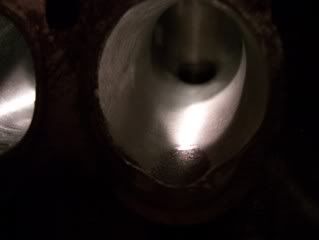

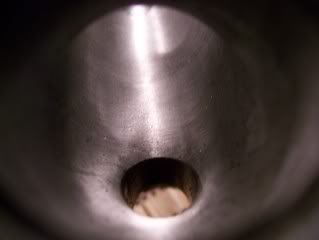

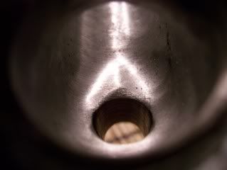

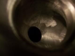

PS:putting in a few pictures of some minor flowwork I did to a Punto head a few years back. Sorry for the picture quality:
Best regards
Remi Lovhoiden
Intake port some smoothing left - guides removed
Exhaust port cleaned up - guides removed
Intake port from manifold side
Intake port from CC side
Another look at the exhaust from CC side
Combustion chamber partly done
Modified bronze guides
OK. Port match and smooth out the inlet side. Just smooth the exhaust. P75 cam, decent induction system (the Focus ones on eBay are OK, GSR are better), shims from FIAT or Fluffy the Impaler (they're less than a fiver each), use a performance exhaust manifold from one of the usual suspects with a cat from a SPI Sei or Cinq (extra lambda boss welded in).Remap the stock ECU. If you do find you need bigger injectors, look at a 16v Punto, but the stock ones should be OK.
