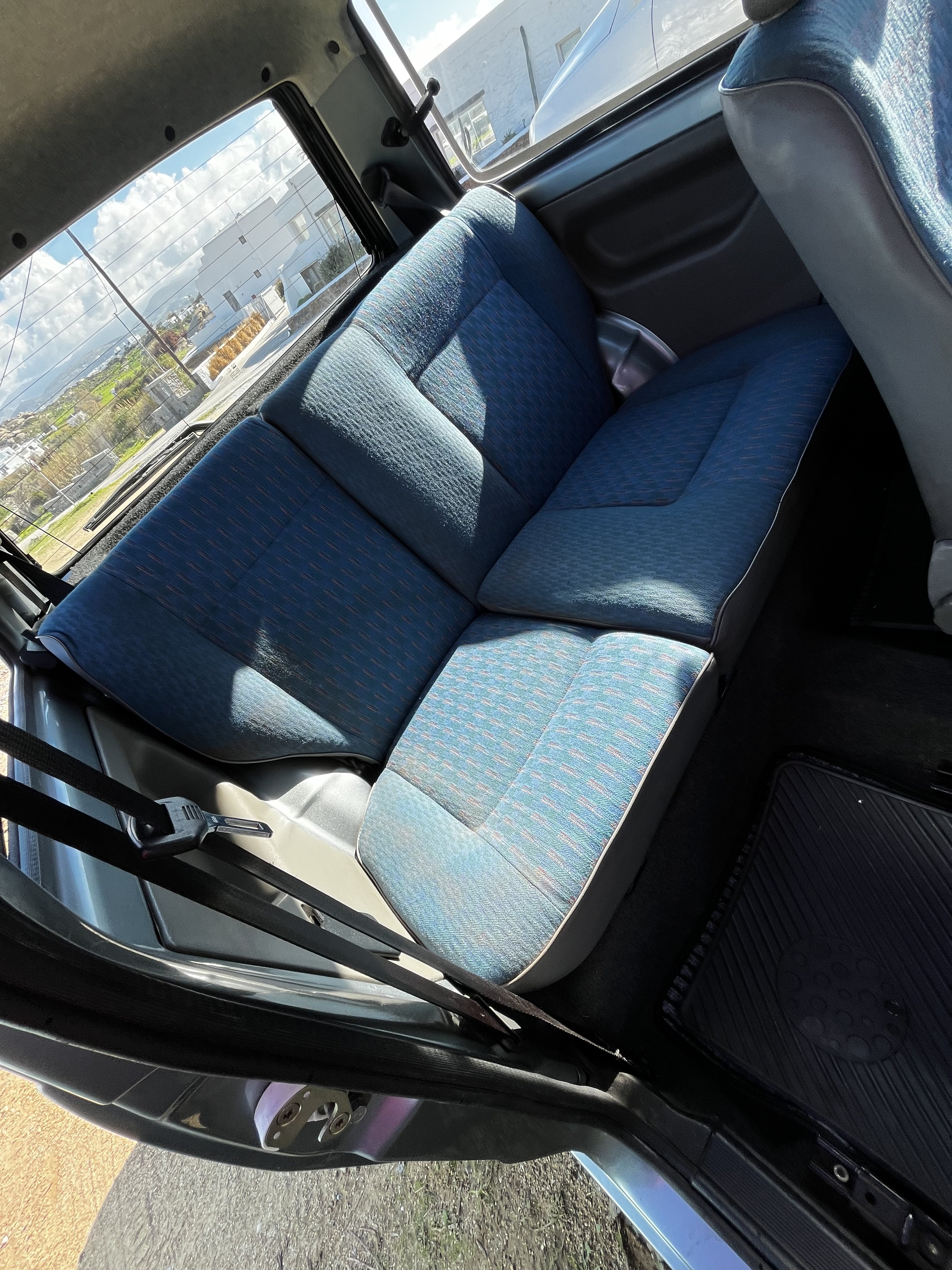

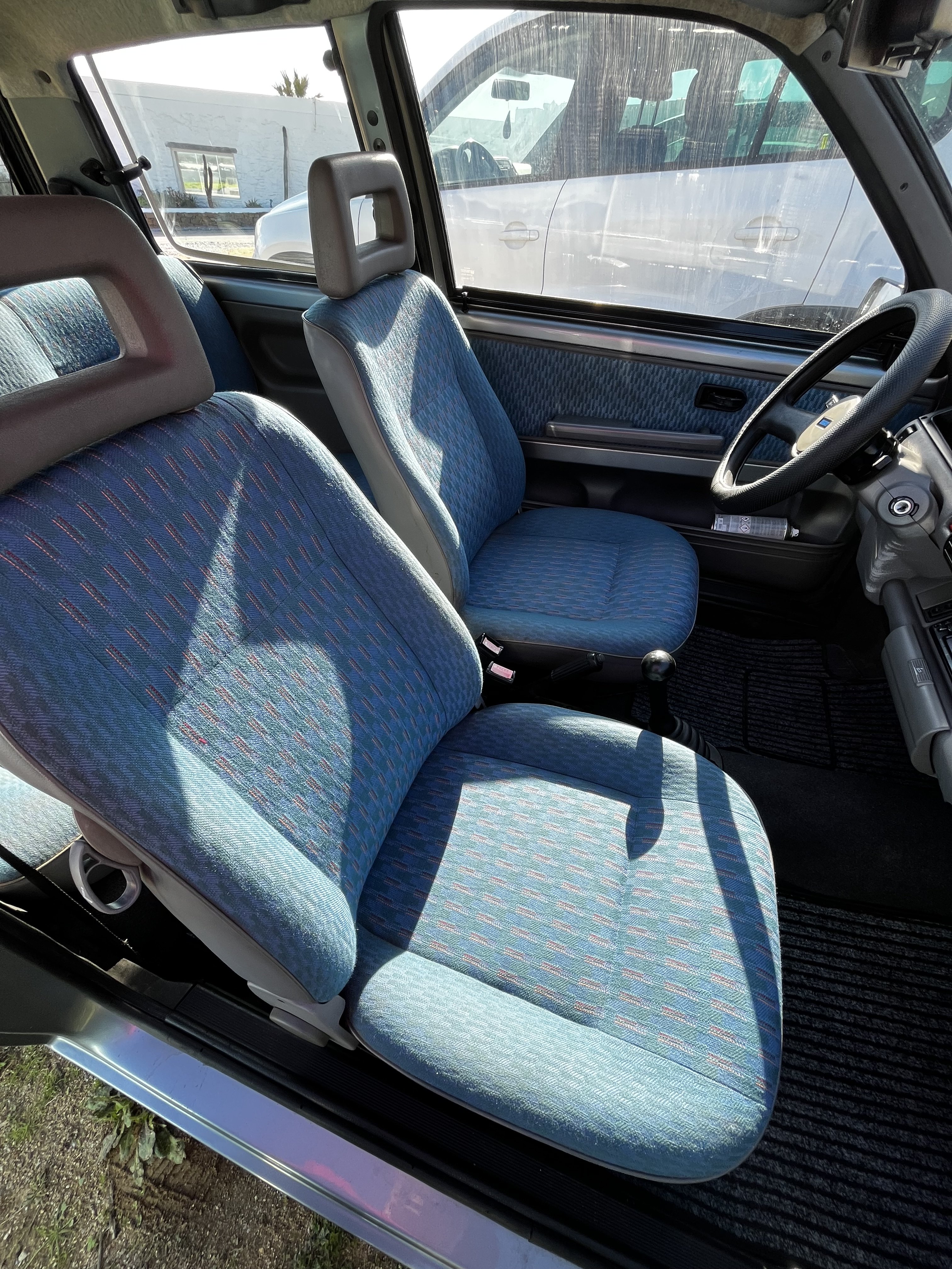

Just a short update: I purchased the car in subject after all and you can imagine my surprise when I removed the seat covers to discover the original textiles being in such a great condition after 30 years.
Strangely enough, the top of the gear stick has worn out so much that the numbers are not visible anymore!

So now you should probably put covers on the seats to help preserve them 🤗
