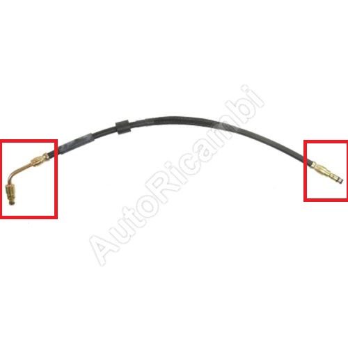

It's a Mobility system to adapt a manual car with hydraulic clutch operation. Basically an inline master cylinder (no reservoir) that fit between the cars master and slave cylinders that is controlled by a stand alone ECU. That means the original clutch pedal remains usable and doesn't move when the auto function is engaged.
These are the end fittings of the hose I need so custom braided hoses can be made by a specialist to connect to the inline master cylinder -
